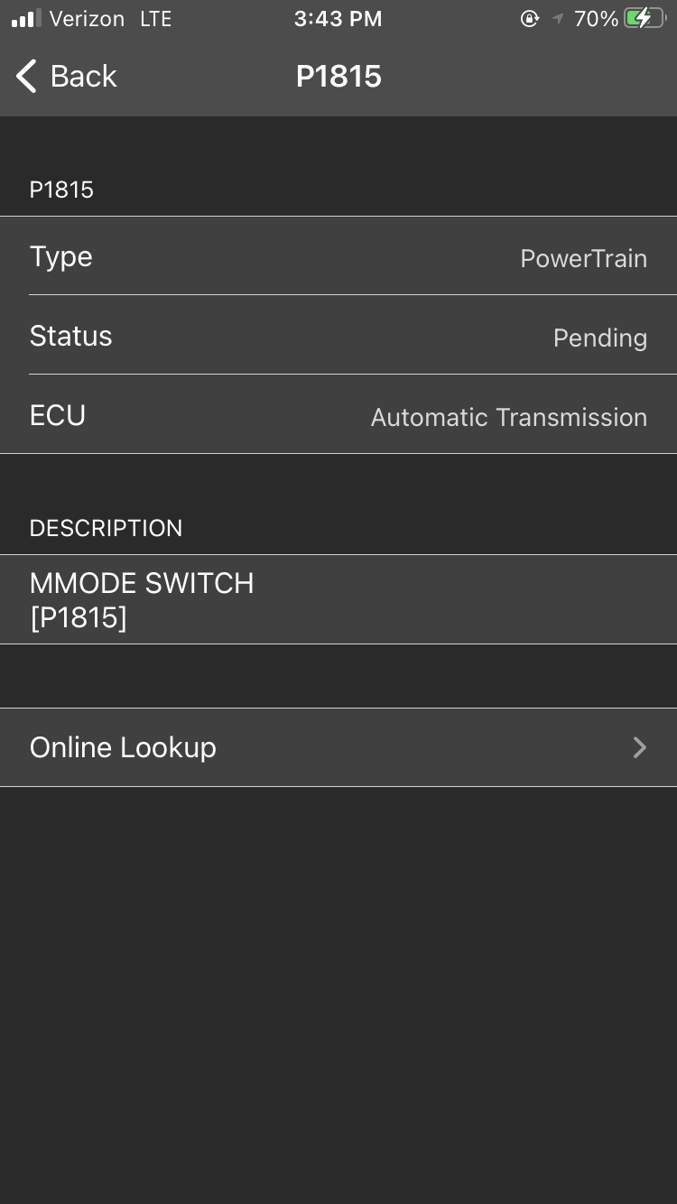

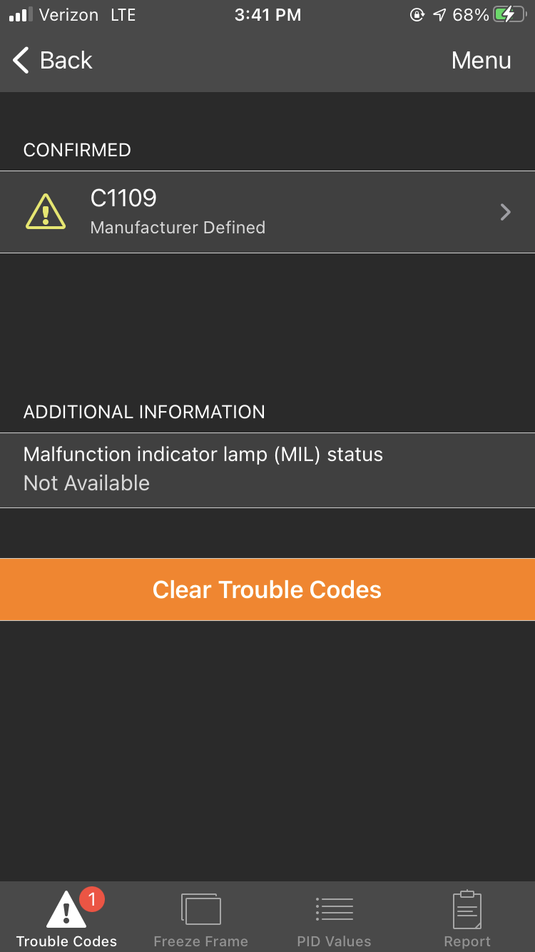

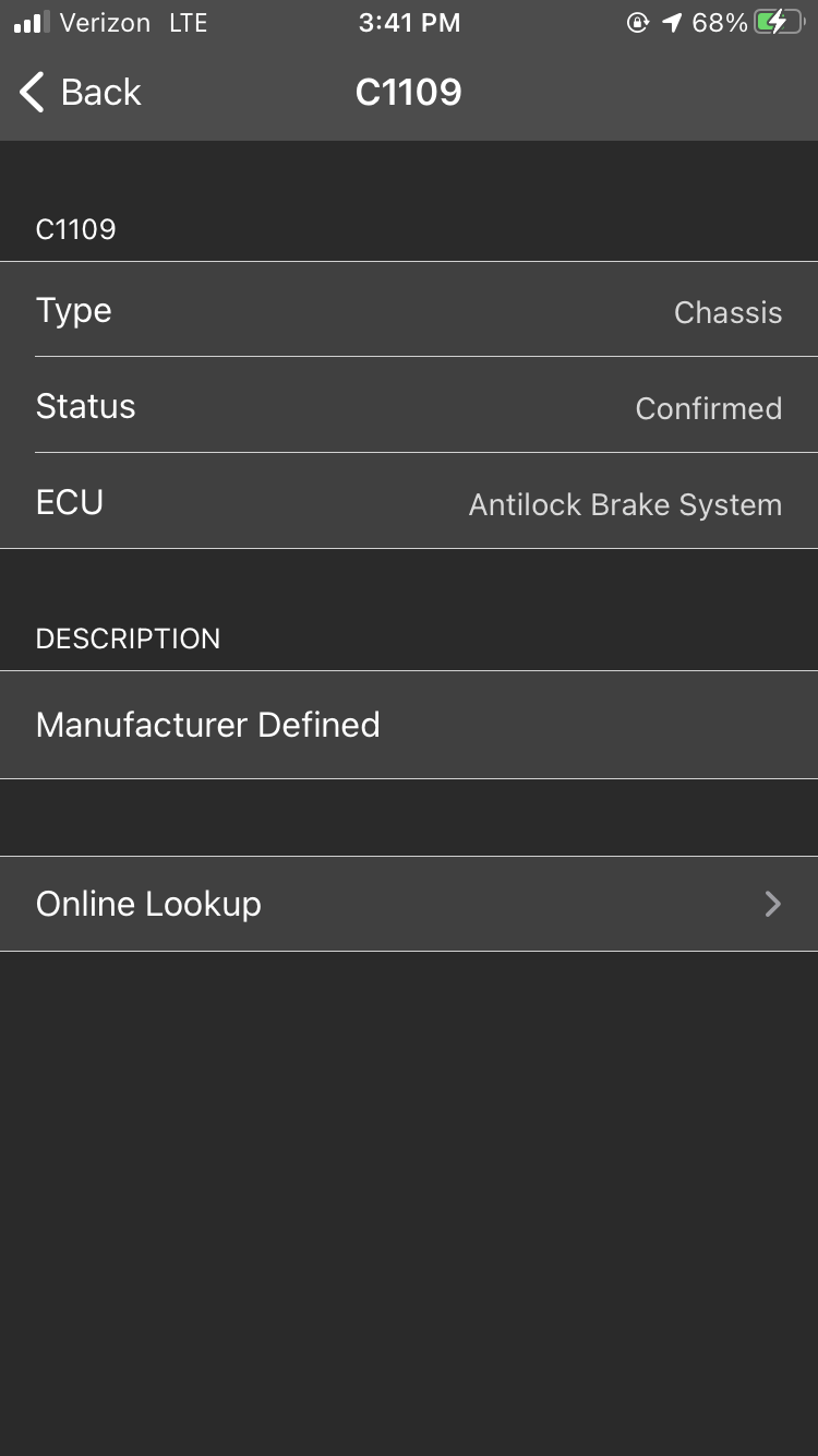

So I just paid an extra $10 on the obd fusion app to read advanced codes for 2006 Infiniti. The general OBD2 and ECM scans came up empty. However, when scanning the AT I got a pending code P1815 MMODE Switch. When I scanned the ABS I got confirmed C1109 but it didn't come up for the general OBD codes and I do not have any warnings on my dash. Could either of these connect to the rpm jump I am seeing? I'm not familiar with either code or what they mean. As a side note, I have a newer battery that was reading 12.5V on the app. I put screenshots of them below, weird to me that it says confirmed but I have no issues with ABS or CELs.
edit: just unplugged battery and wiped down connectors and got a reading of 13.5 V on average with the car on. Also went for a drive and used MM mode and it worked fine, shifted gears up and down.
edit 2: cleared both codes yesterday and after a drive, neither of them returned. Went for drive this morning, and afterwards the P1815 MMode Switch was pending again on the scanner. I have had some slight issues with manual mode in the past but it works so I think it's just that little switch in the shifter assembly getting stuck when going up/down once in a while. I don't see how that would cause my RPM drop in Drive though, let me know what you think here. Thanks
