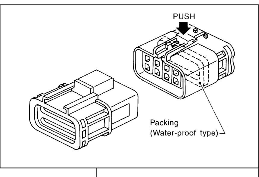

Some are "squeeze here" and some are "pry this tab up". Always a puzzle. I'm not sure which one you're looking at, but is it like this?

It's a simple squeeze/pull type of harness. I like to use a pair of angle head needle nose pliers to squeeze the tab, sometimes if they're really stuck on there you can also use a flat screwdriver wedged against the bottom of the harness and against the injector then rotate the flat head to get them loose.
Here is a picture of the squeeze tab.
