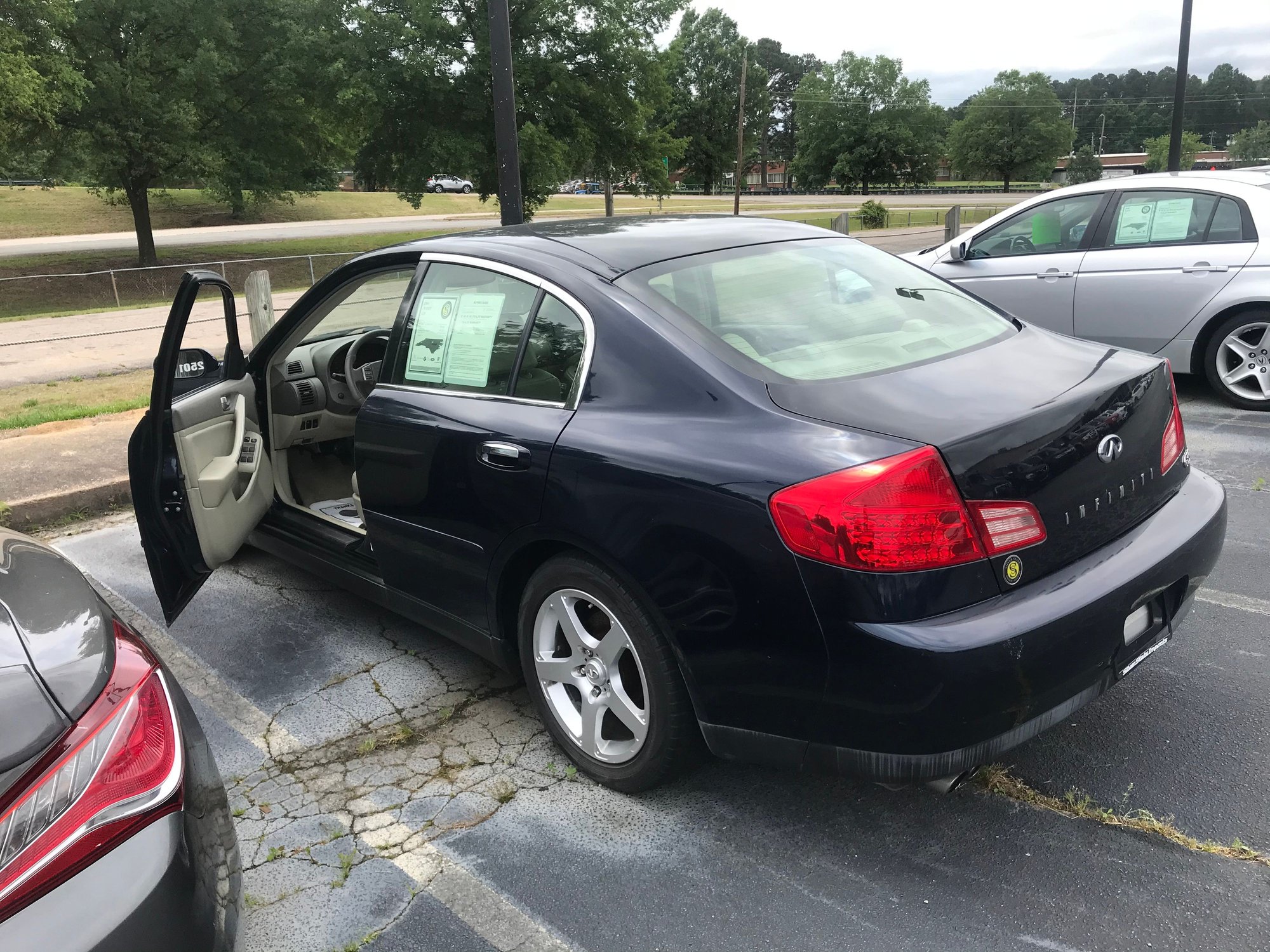

Hey all! I joined the G community last May when I picked up an 04 sport package with a 6 speed that was in fantastic shape. She was my first big girl car after I graduated college and I knew I needed something manual and with a bit of oomph after driving a crv for the past 3 years. I always loved sedans and the g35 has always been on the list of cars i wanted, so when slommy showed up on the dealer lot i knew i had to have her.
This car was way too nice for me honestly. It was a one owner car and had 11 pages of car fax and had been meticulously maintained. ( I feel so bad for what she's turned into because of this )

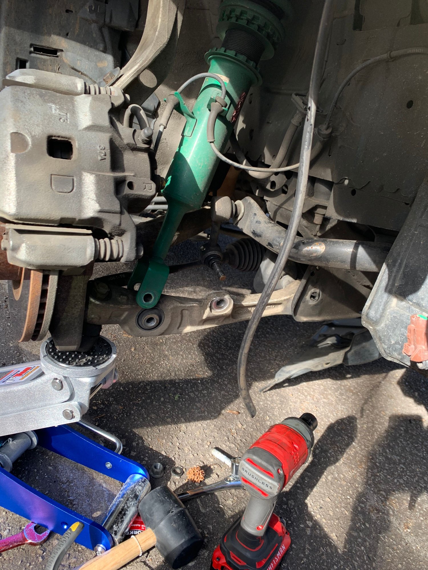

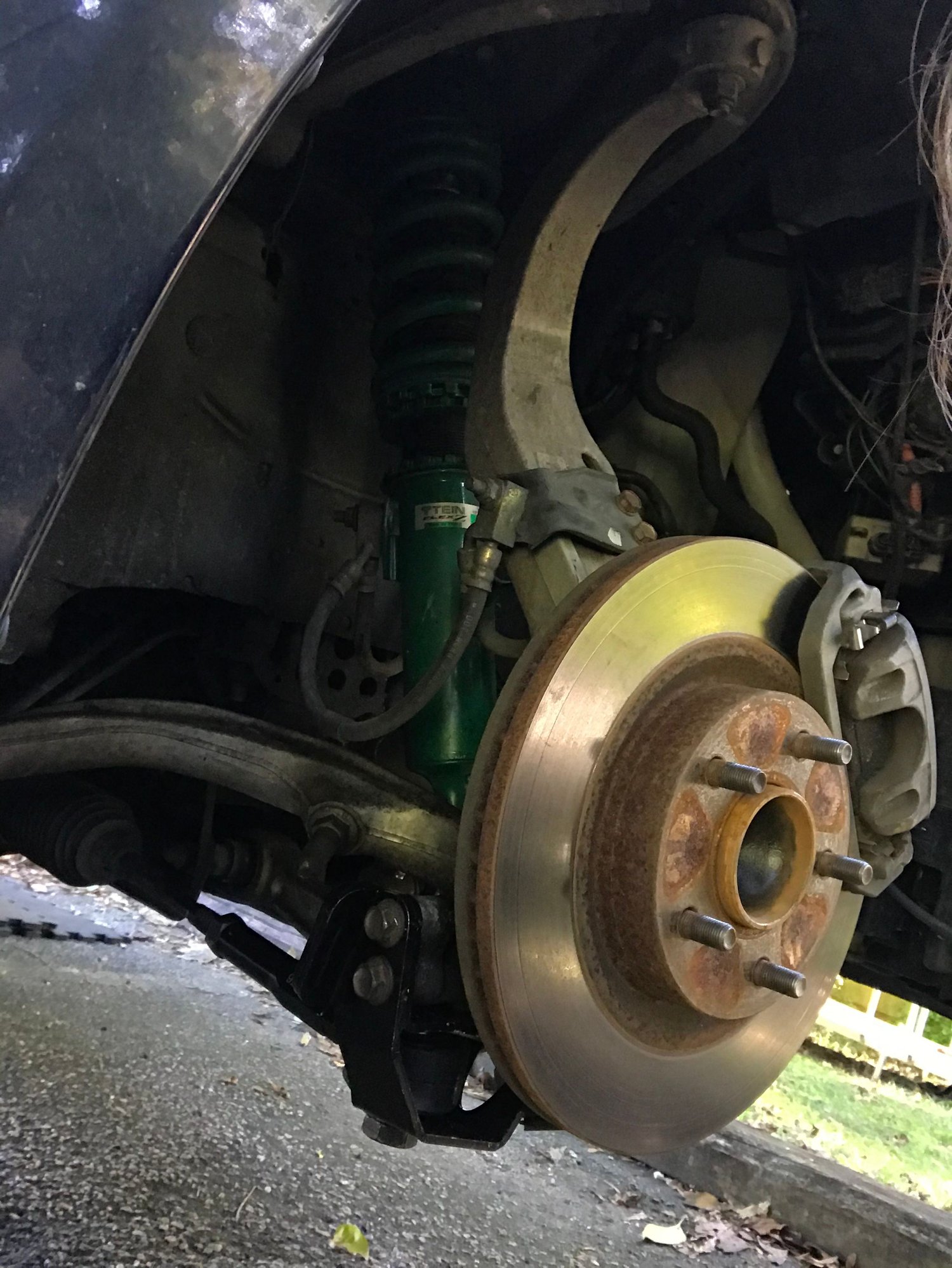

First thing I did was order coilovers to replace the blown struts, but thanks to covid I didn't get them until late August. I didn't get them on until after my first event.

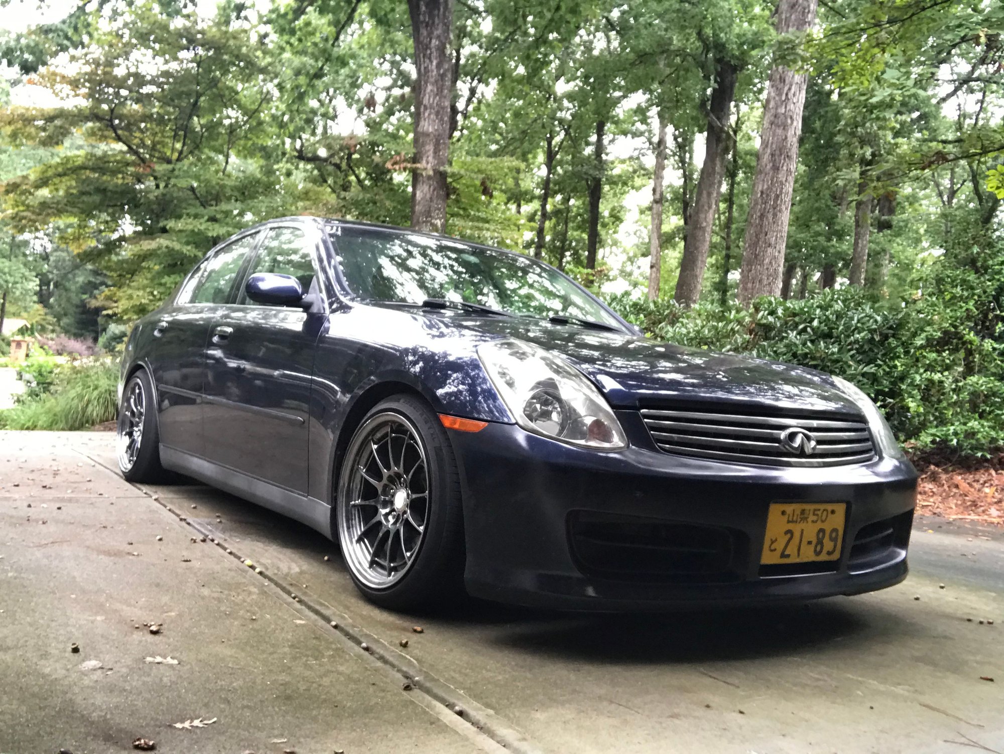

Until those arrived I did some little things such as picking up a set of enkei NT03's for the car. I scored these for an insane deal because they had some mild curb rash. They came off a stanced subaru impreza but the tires were still good so **** it.

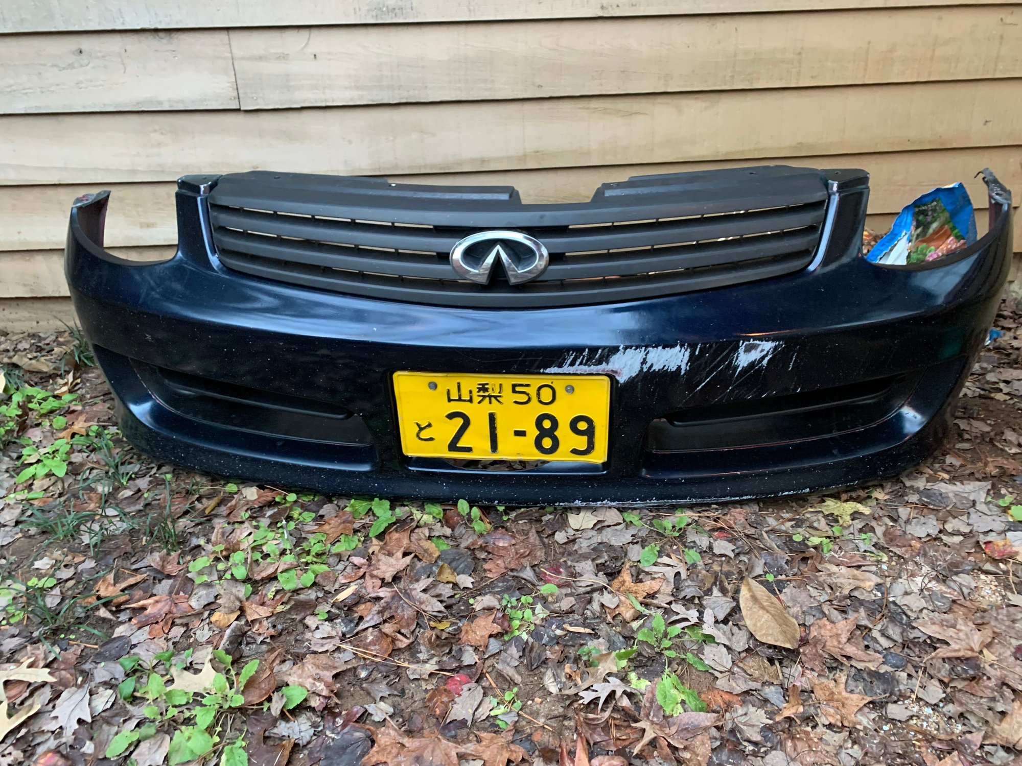

I found a factory Nismo Bumper for a decent price online, Funny thing about this. They literally bought it a bus ticket and i picked it up from the local greyhound station.

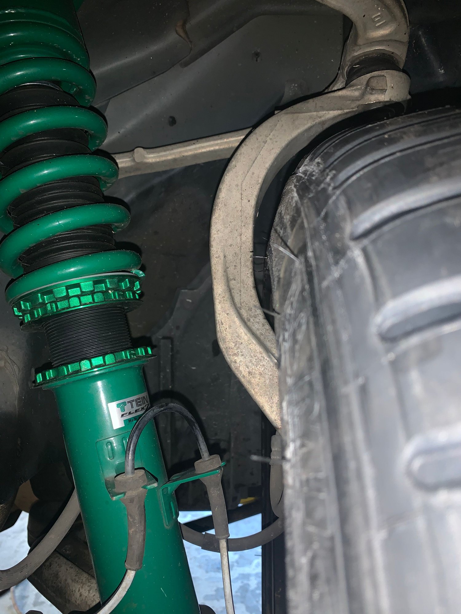

My coilovers also finally arrived!
No more bad fitment!

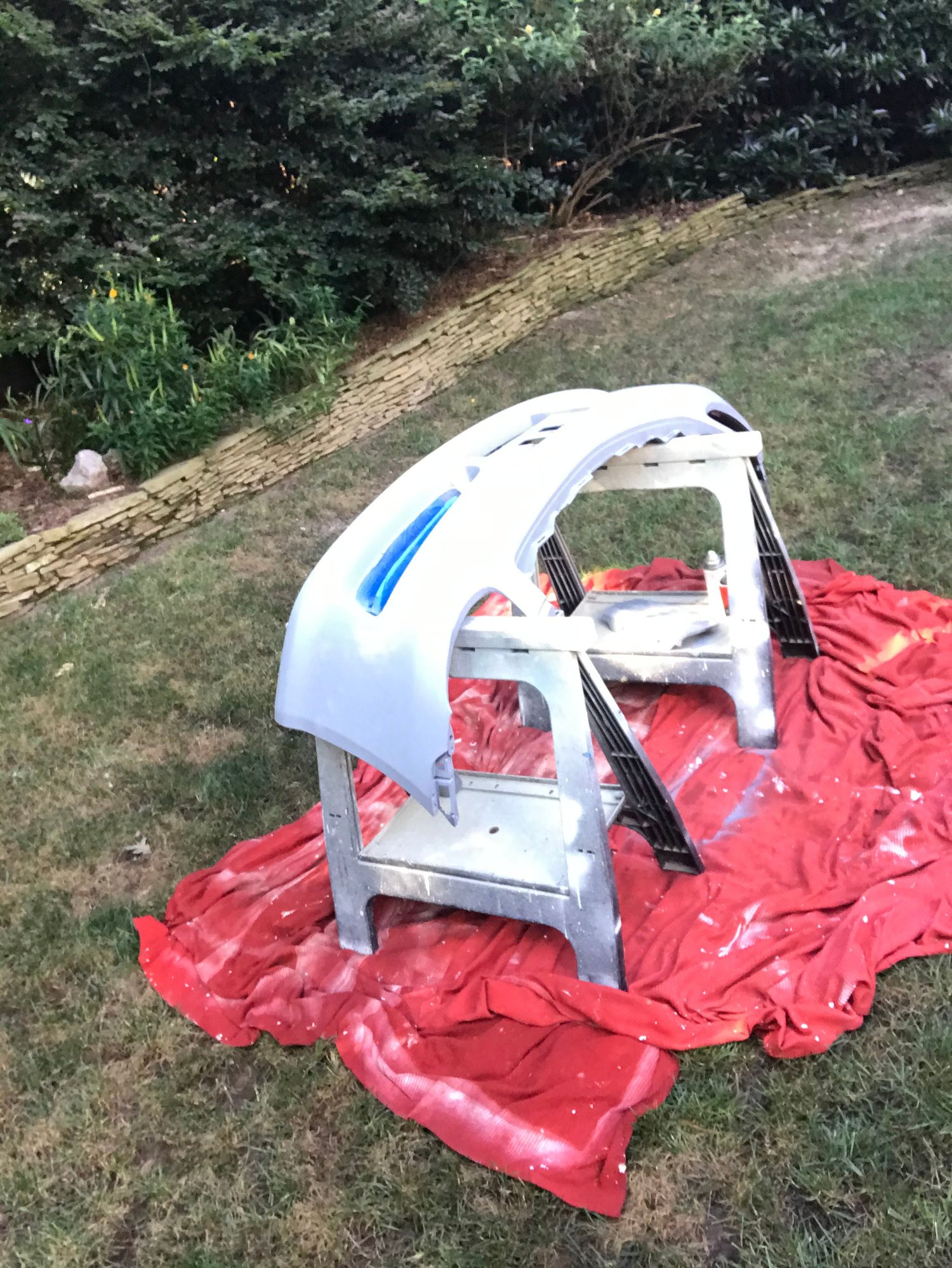

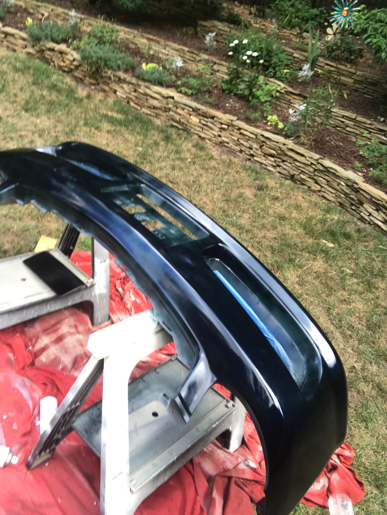

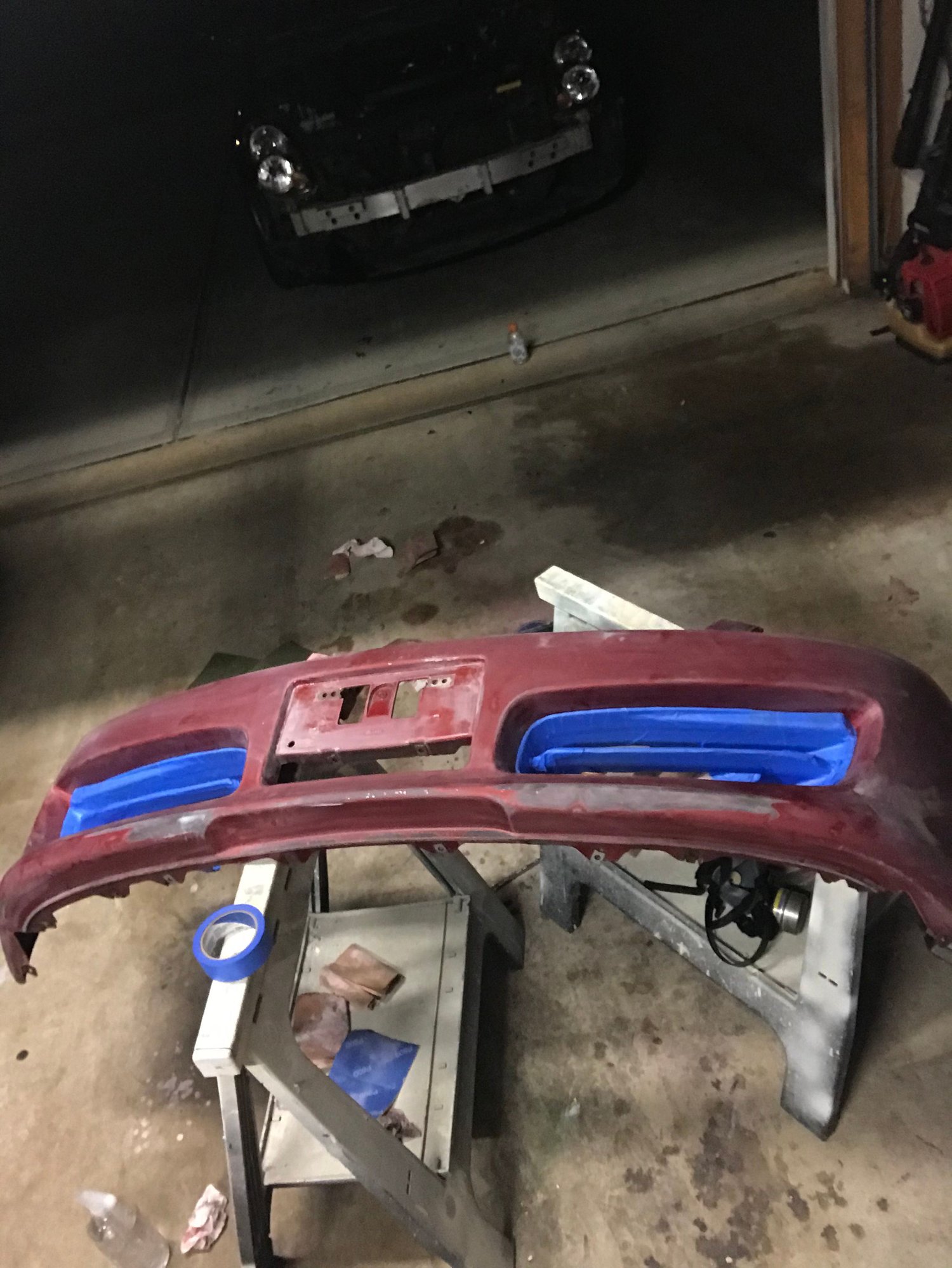

I also repainted the nismo bumper at this point as well. It was my first time attempting anything like this myself so im pretty proud of the results. Its not professional by any grade but i did it in my backyard so idc

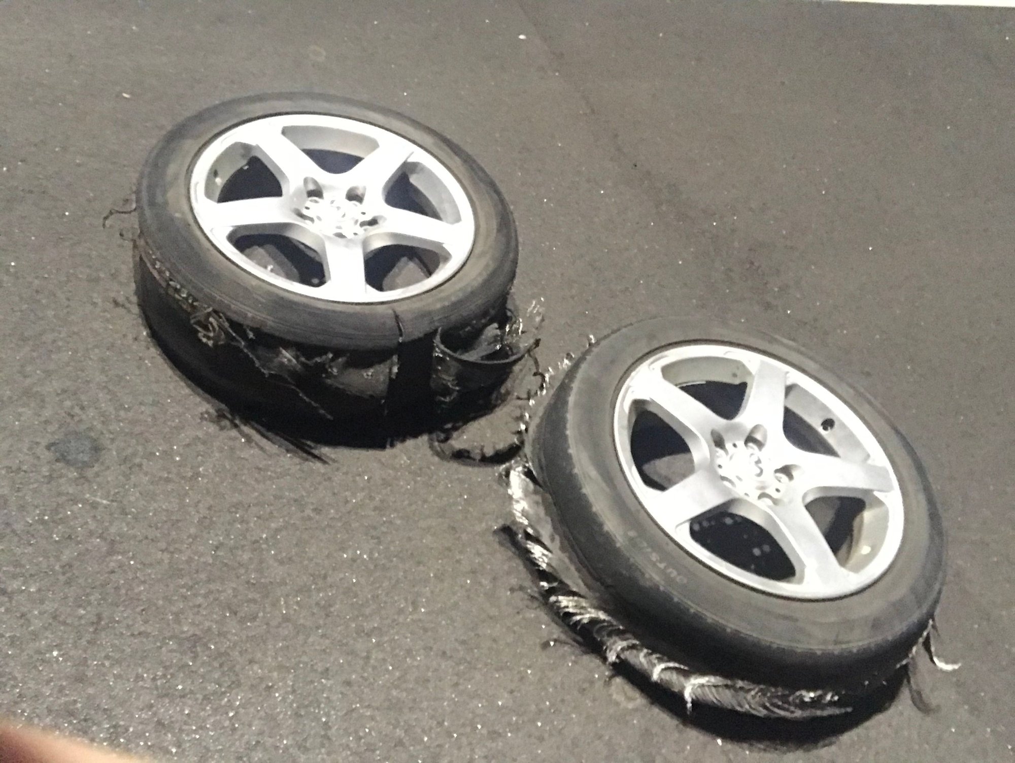

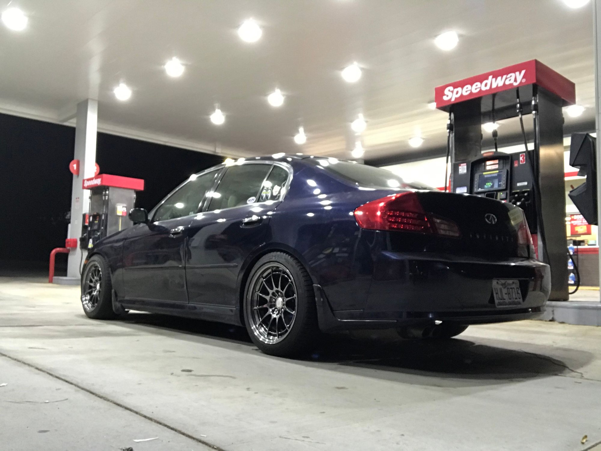

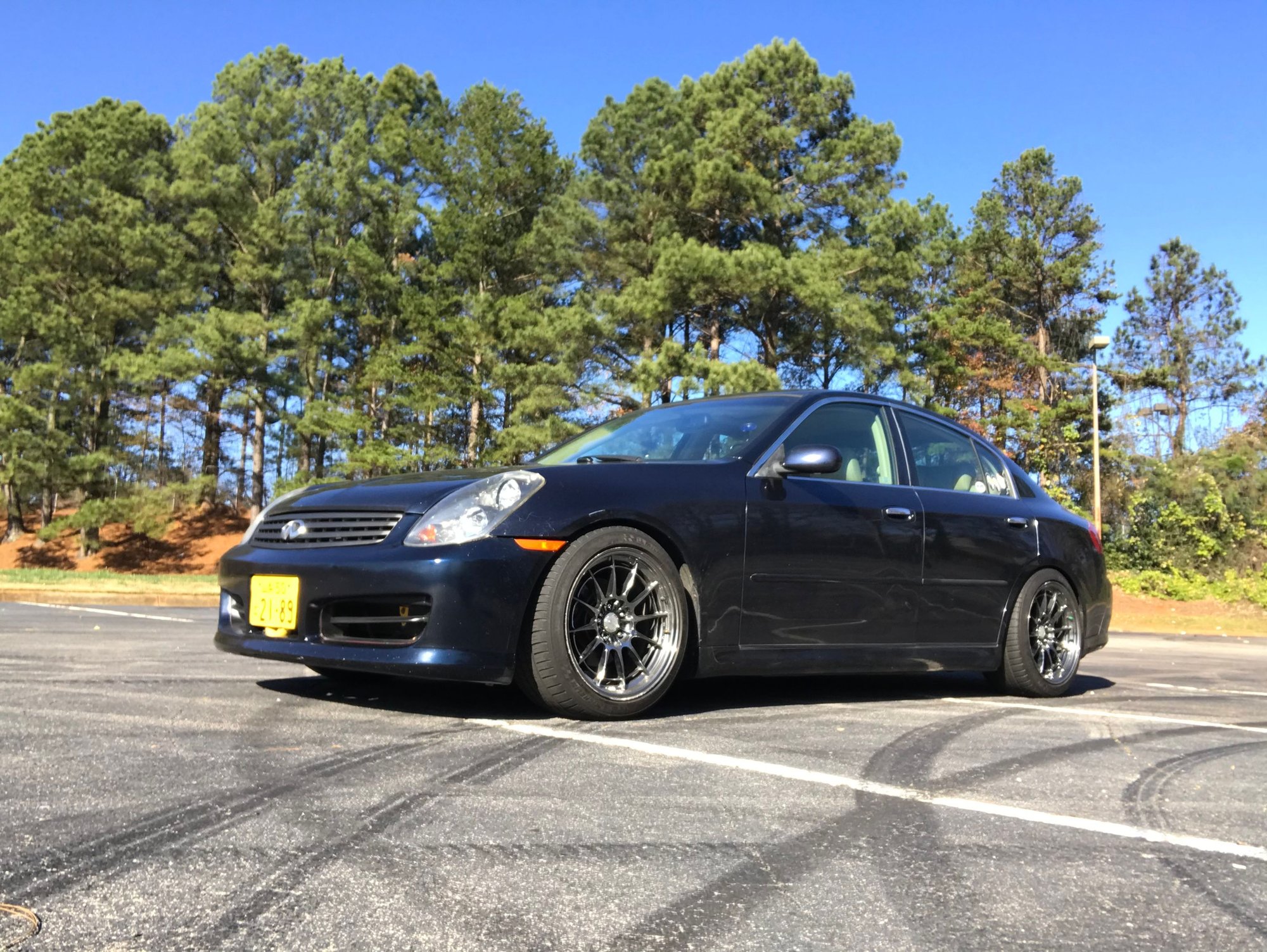

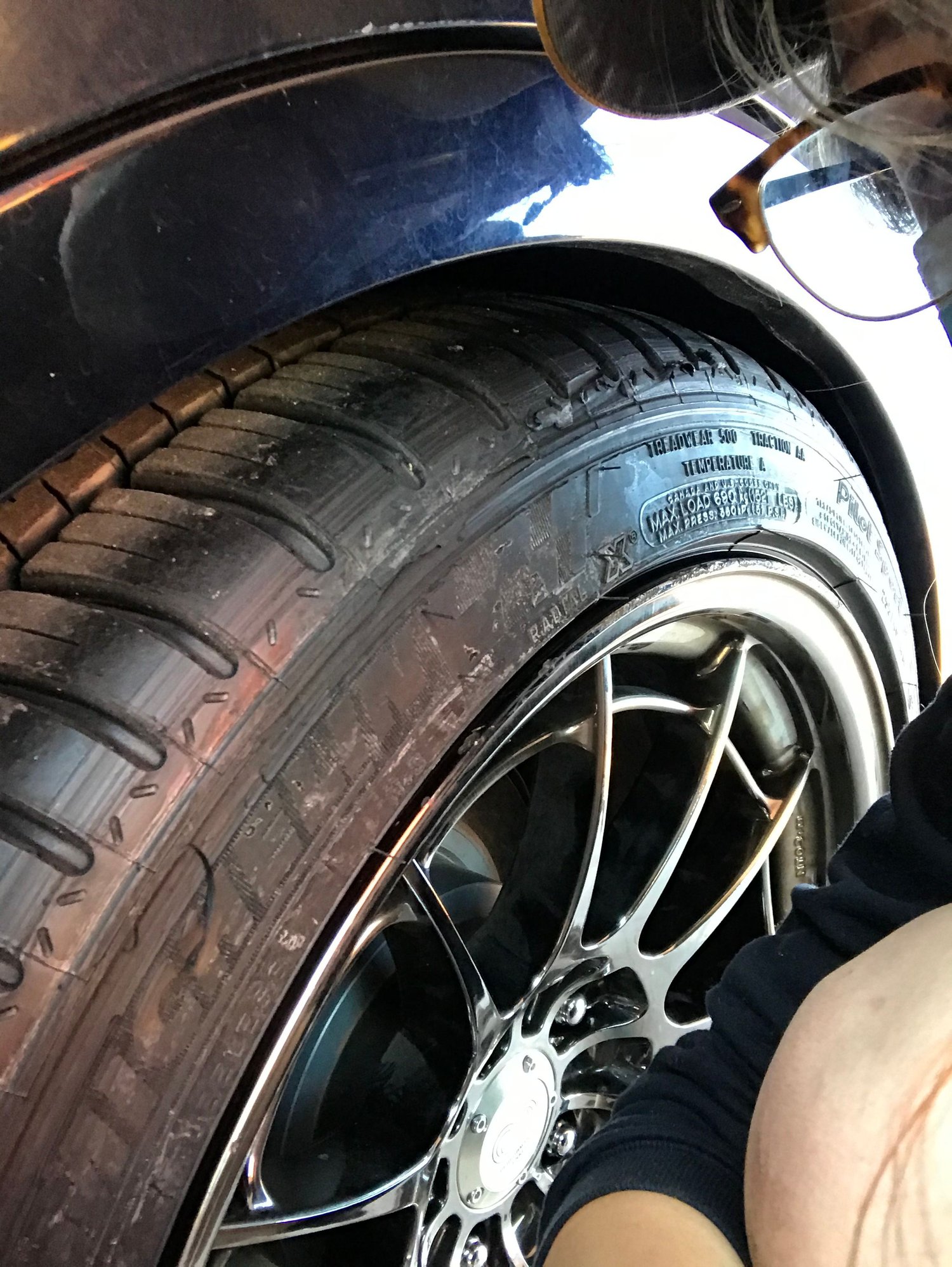

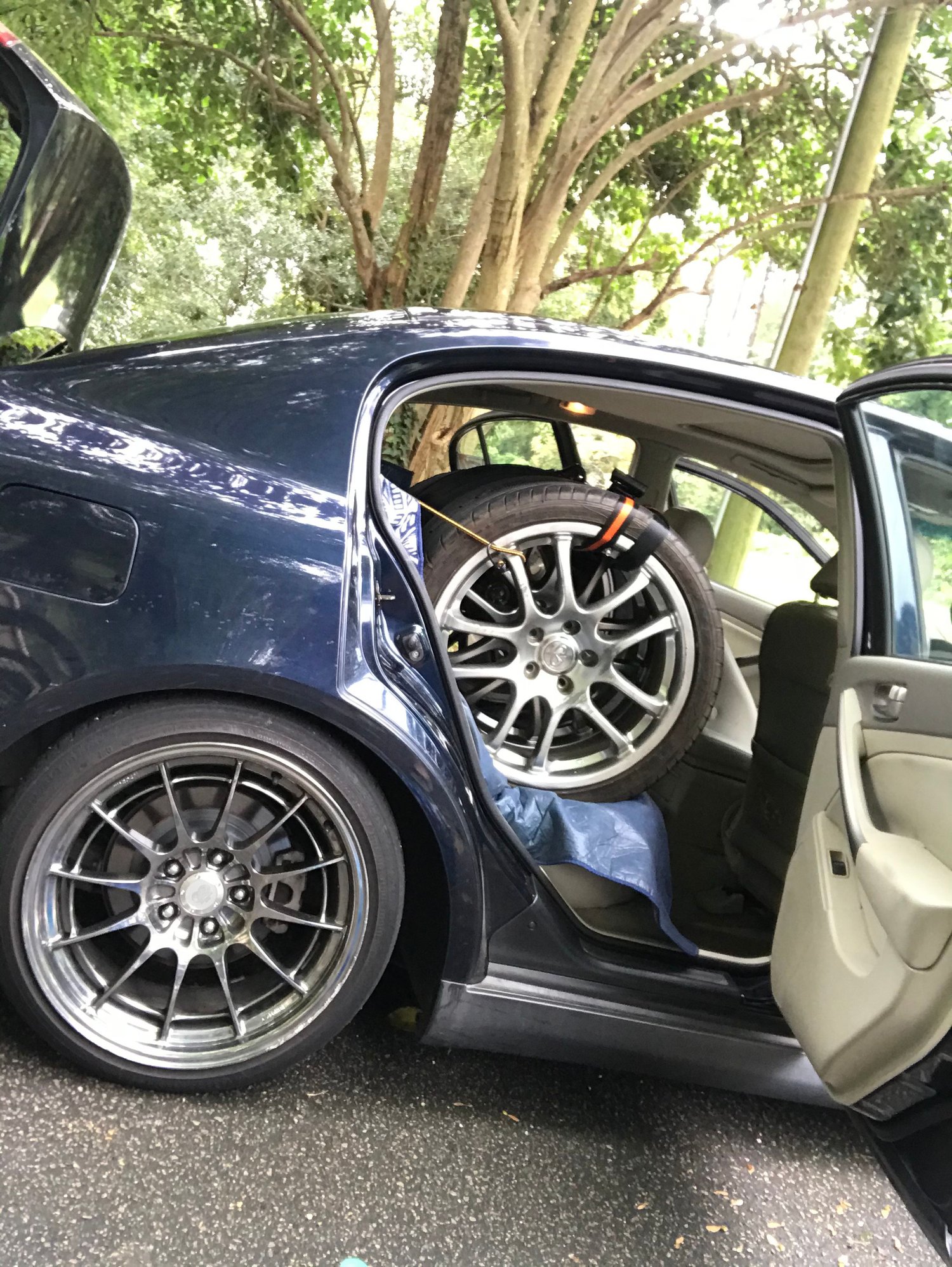

With all this hard driving i burned through the Conti's that came on my Enkei's pretty quickly. On a friends reccomendation I picked up some michilen pilot sports that were on closeout and I got quite possibly the meatiest fitment i've ever seen on a g35.
LOOK AT THIS!!!!
MEGA MEAT
IT BARELY FITS!!

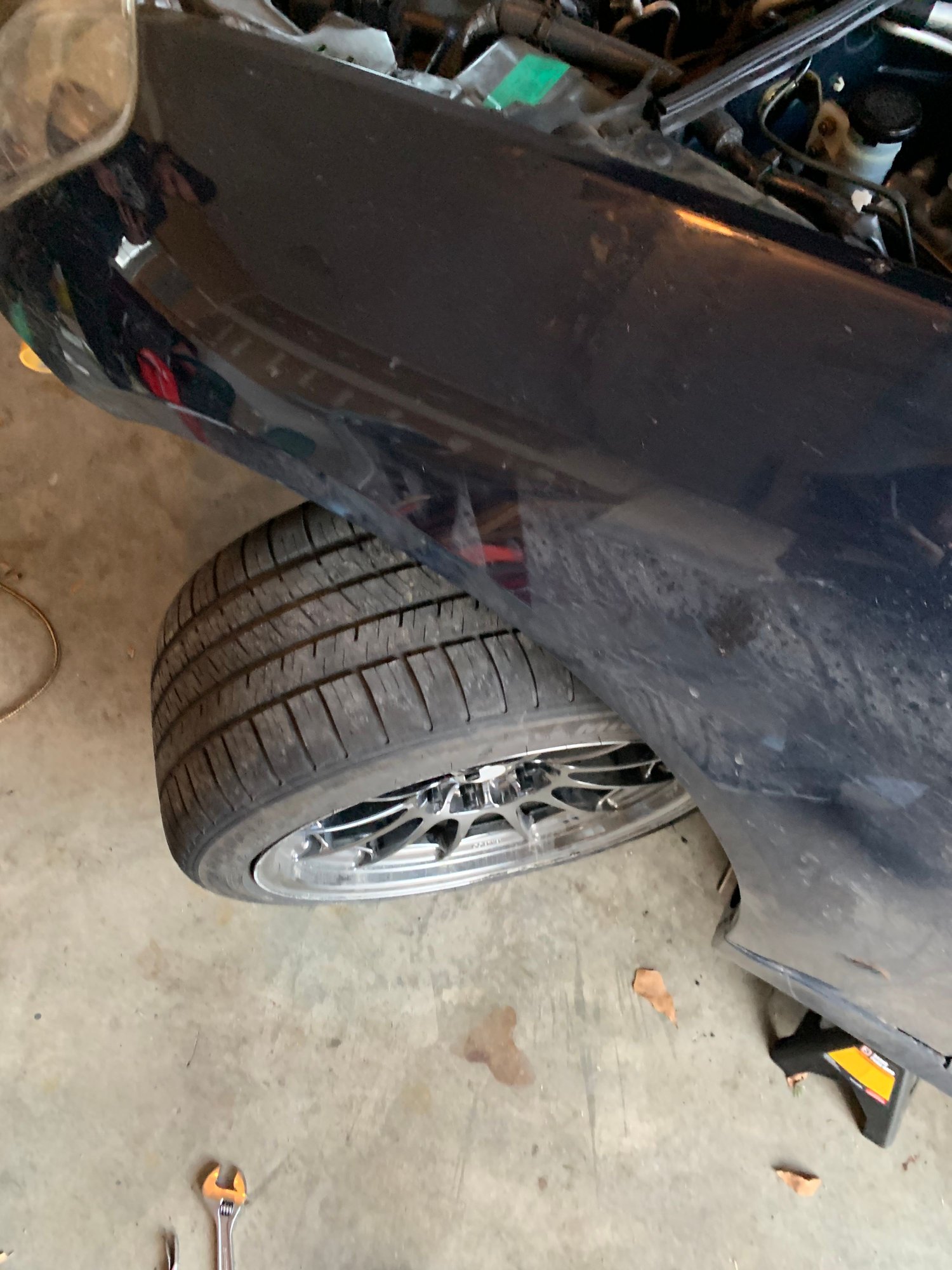

After a quite a bit of fender rolling and beating them with a hammer they finally stopped rubbing.
I dailed the G at this point welded diff, fat tires and all.

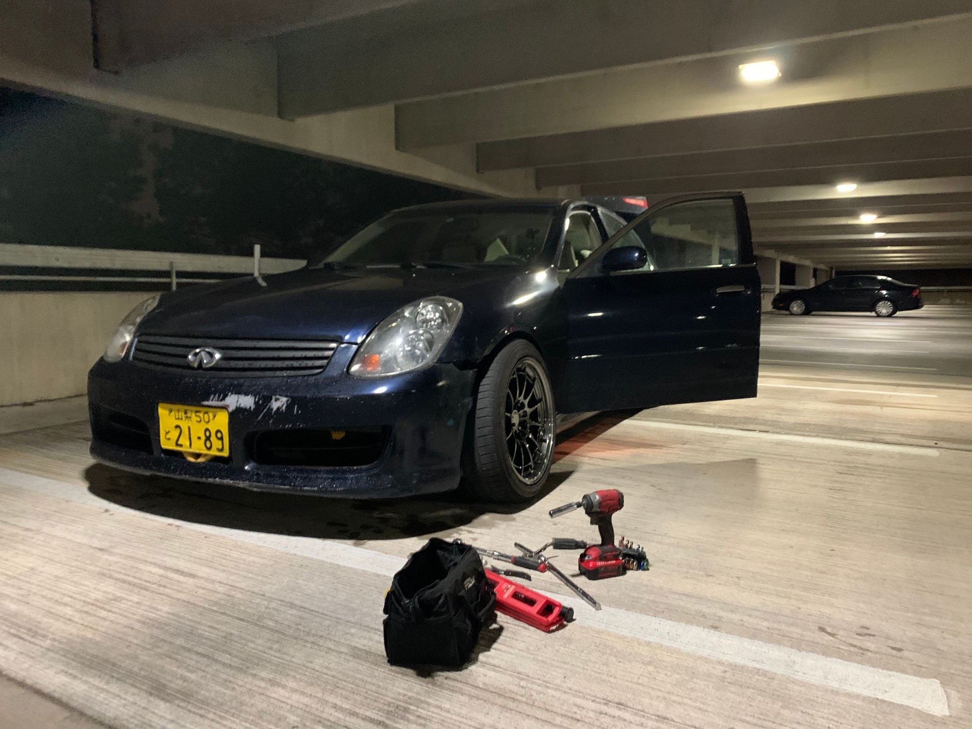

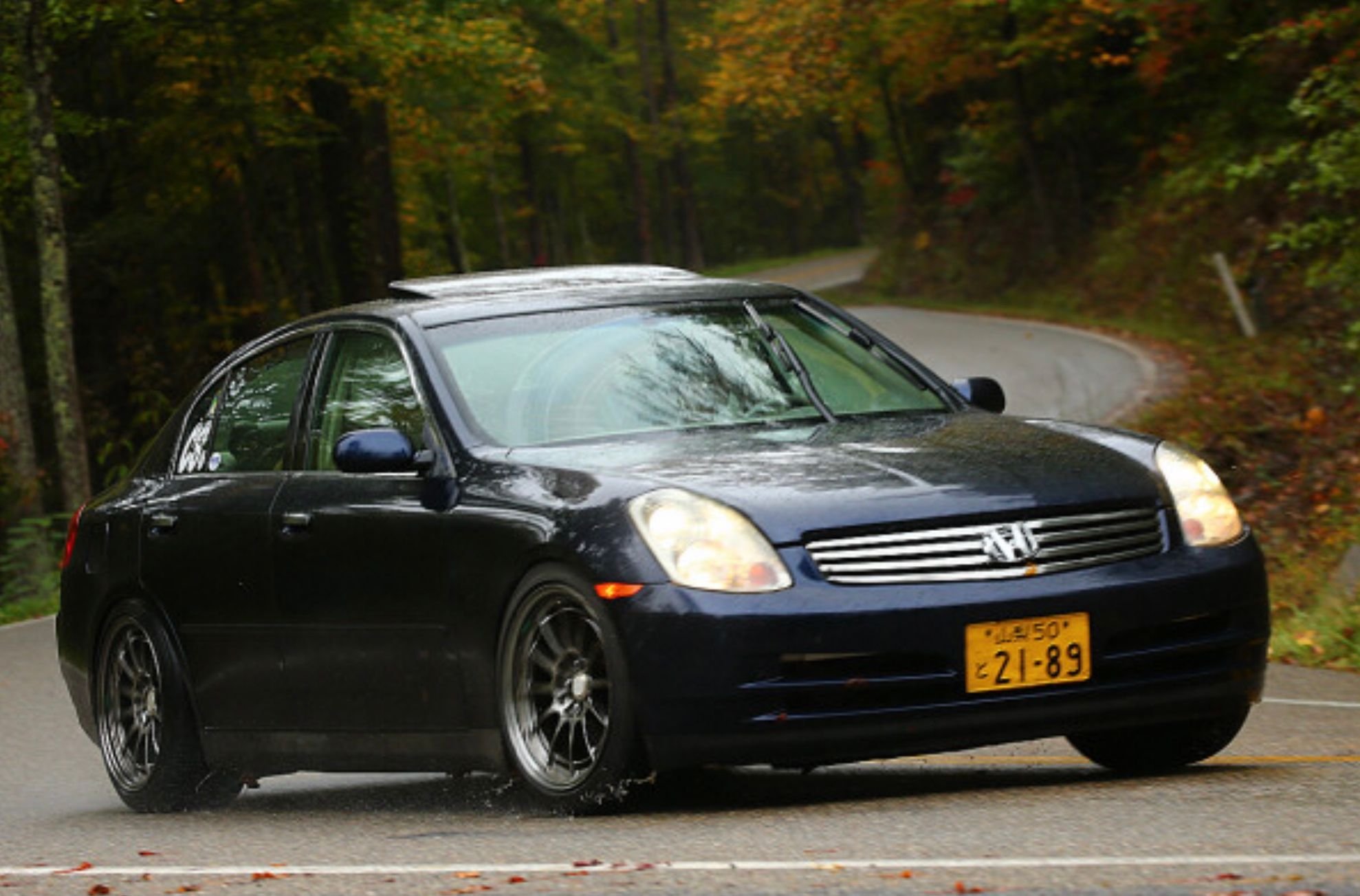

My buddies were planning a trip to Tail of the Dragon for Classic Hondas and you just dont say no to a Dragon Trip
I had to fit in somehow
Even with the welded diff the G did really good on the dragon! I was even able to keep up with the hondas thorugh the twisties!

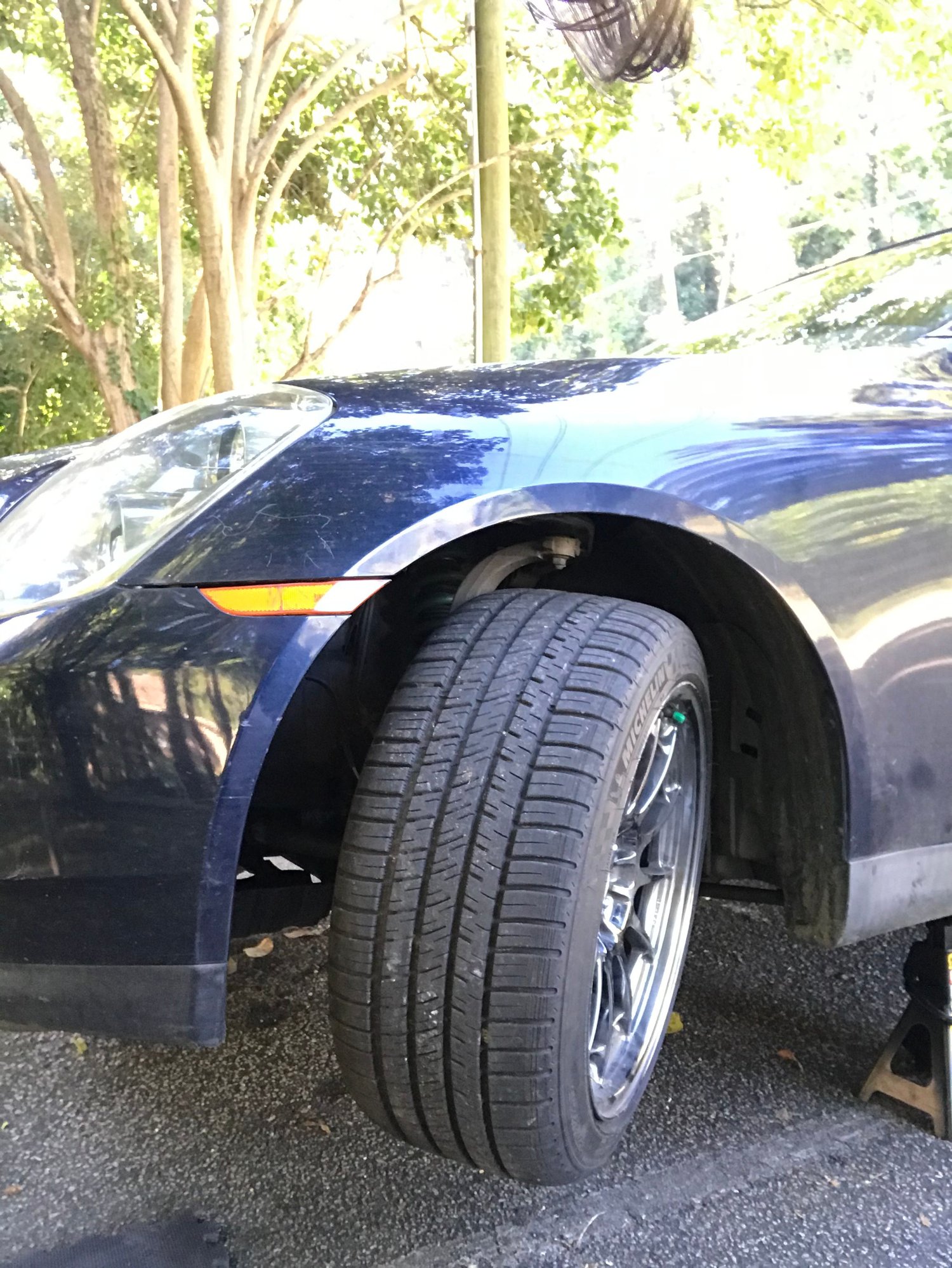

So the second problem with g35's and drifting is angle. These cars have such bad angle from the factory that they just want to whip themselves around. You almost have to drive it like an older Z. I ordered a set of the GK Tech knuckles and they showed after I got back from the dragon!
look at all that angle!

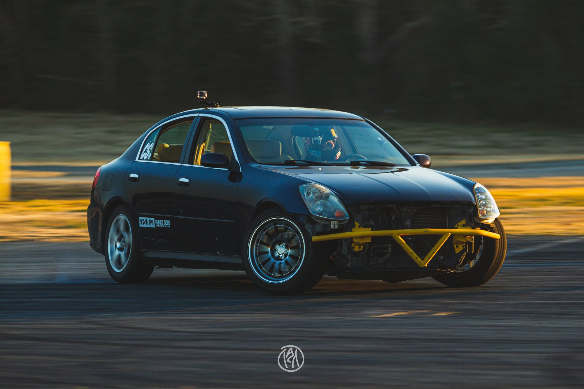

I had a chance to put the knuckles through their paces at my first 2 Day drift event. I stocked up on tires and camped out at the drag strip. I made a bunch of friends that weekend and I'd say thats where I felt like I found a community where I truly belonged.
Stack of tires waiting to get destroyed
I also finally got some photos of my car on track!!!
Also I feel like this is where i finally started to get the hang of drifting. I was gettng super close to linking the full course but i was struggling with the downhill section. The knuckles made a huge difference in controlability though. You have way faster steering response too! (though this probably came from replacing the tie rods with heim joints)

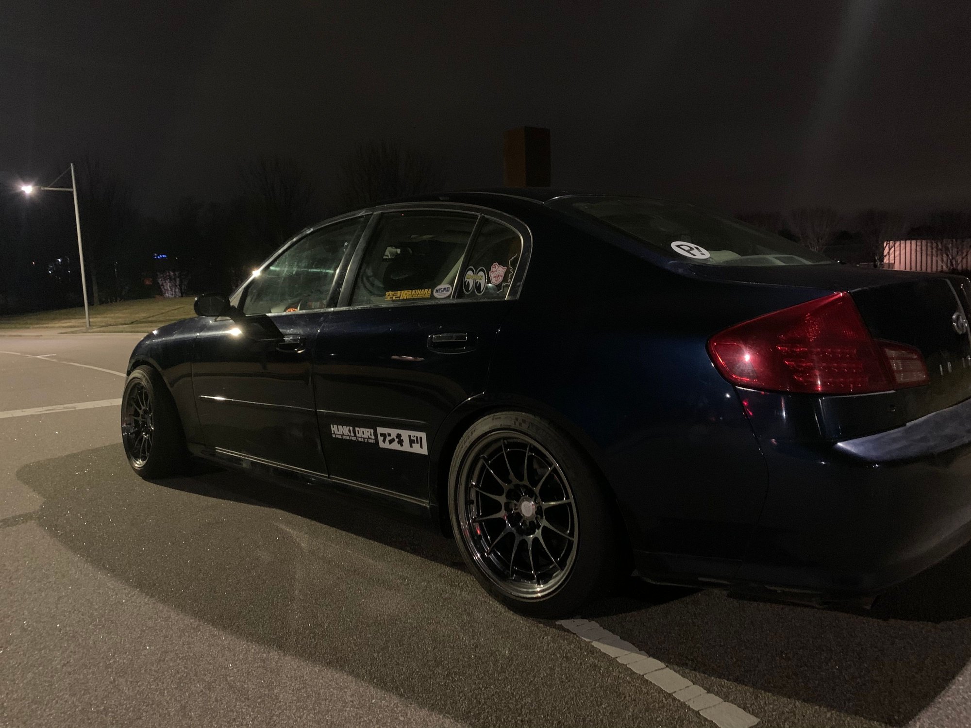

Slommy iv, slommy stylin

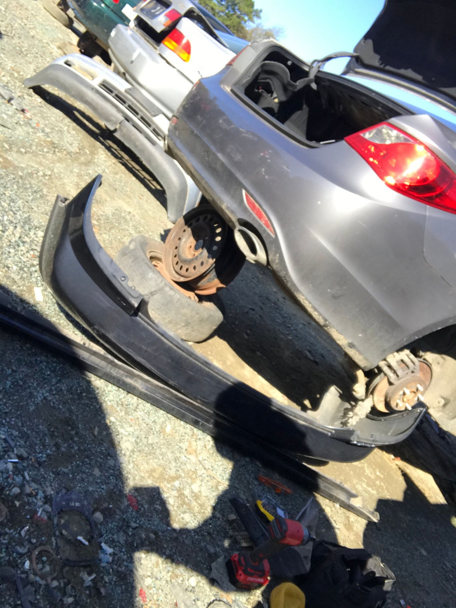

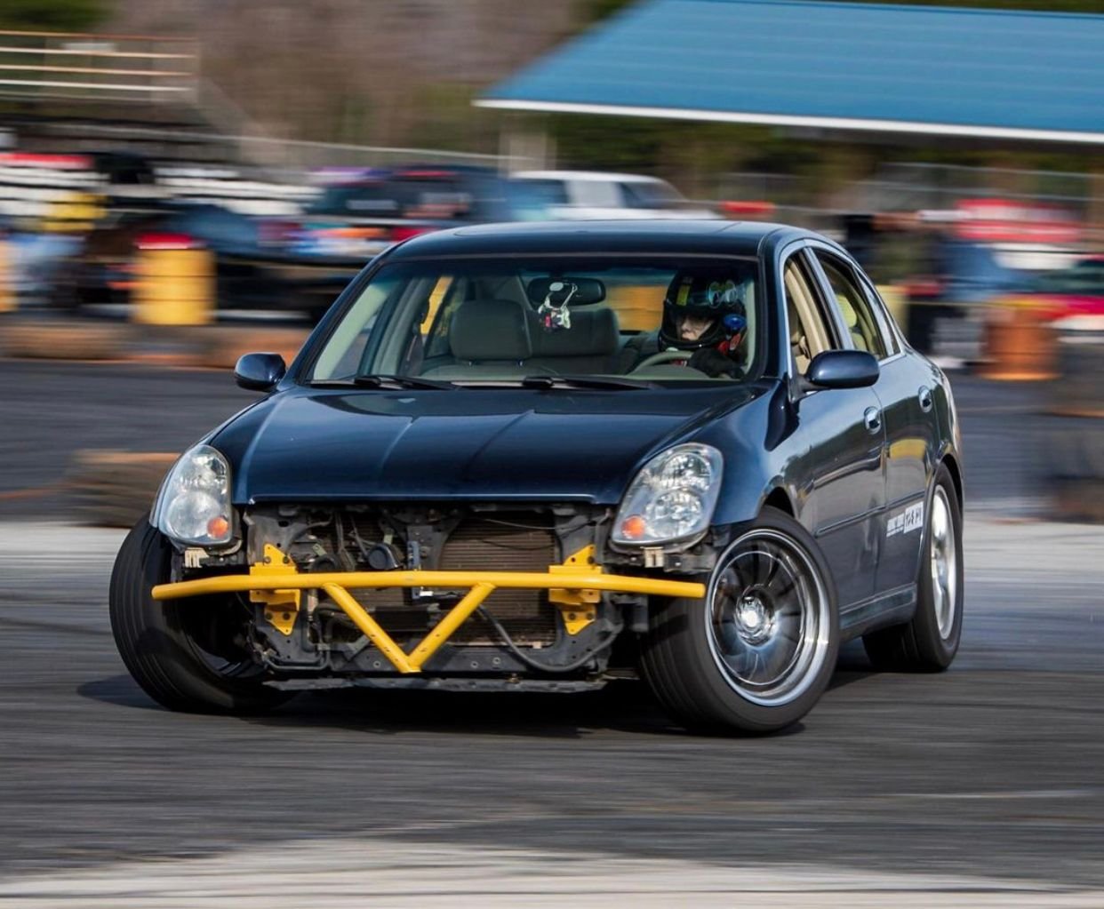

I was really unhappy with how the nismo bumper looked with the unpainted plastic skirts and rear lip. I thought about trying to get a nismo kit but people want stupid amounts of money for those now. Then another twilight blue 06 sedan showed up in the scrapyard and i said OK BET

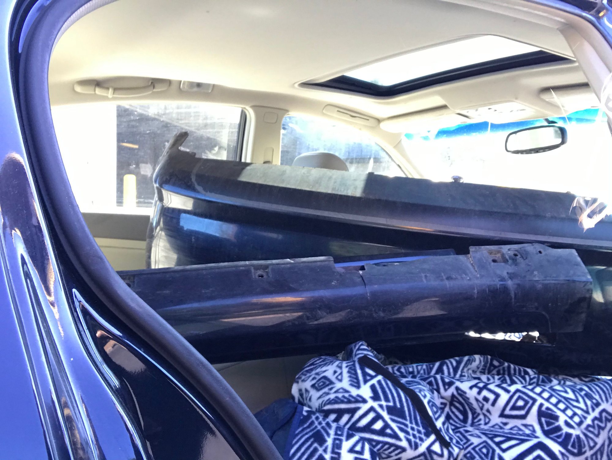

Another example of the power of sedans. Rear bumper and a pair of skirts with room to spare.
After fitting it and cleaning her up I was suuuuuuper satisfied with the results. She looked so good!!!!

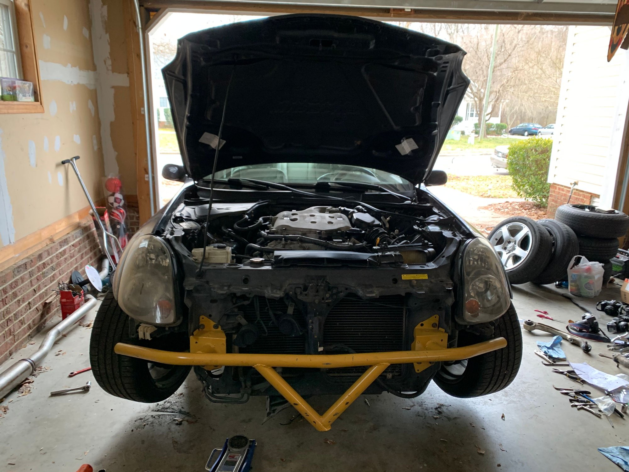

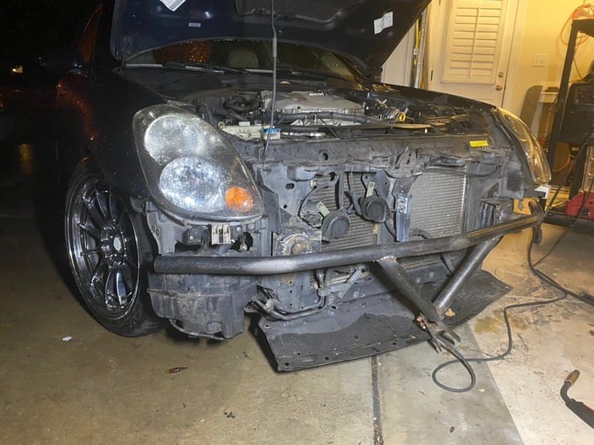

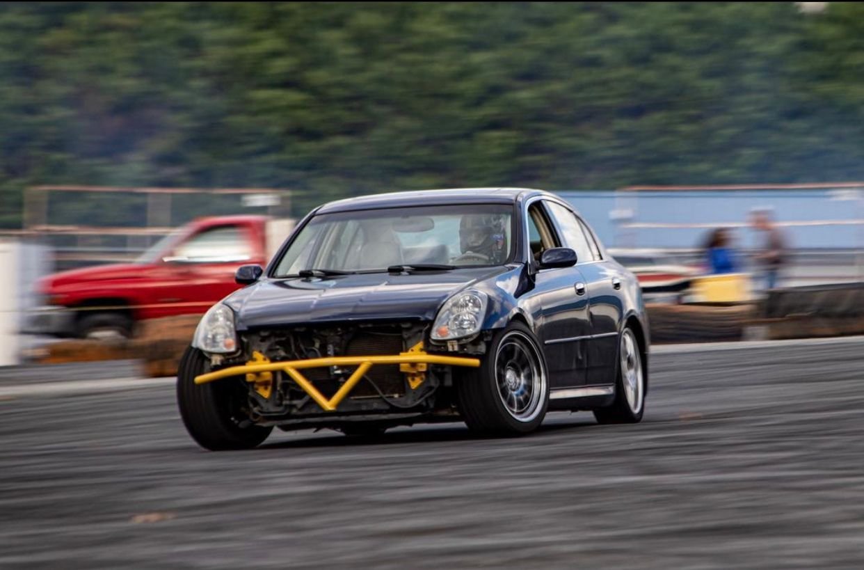

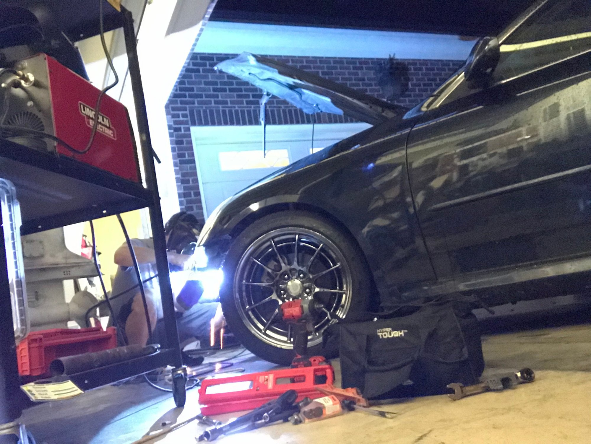

After deciding drifting was the thing for me, i had a friend I made fab me up a bash bar. I had watched too many cars run right into tractor tires and destroy their radiators or core supports.
So the number one thing for me was I wanted this to fit under the nismo bumper so it wouldnt stand out and look too much like a drift missile. With a bit of trimming she fit perfectly!

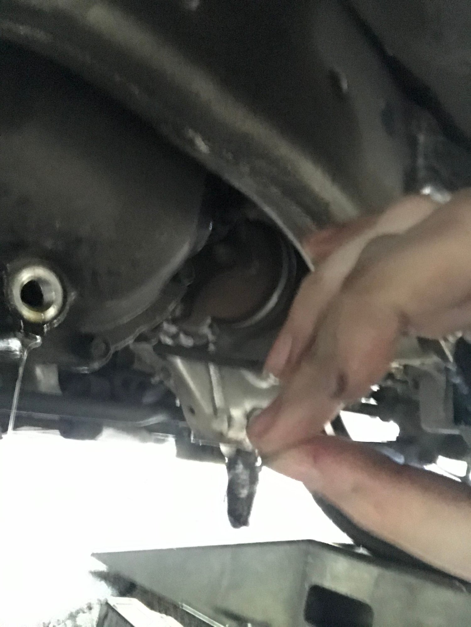

Also replaced the knock sensor at this time. Infiniti quoted me 1400 just to get the part and there was no way I was going to pay that. I picked up a replacment harness from z1, did my plugs and cleaned my injectors as well.
the culprit of my missing 20hp
With slommy back on the road and looking fresh as ****, it was time to take her back out on track.

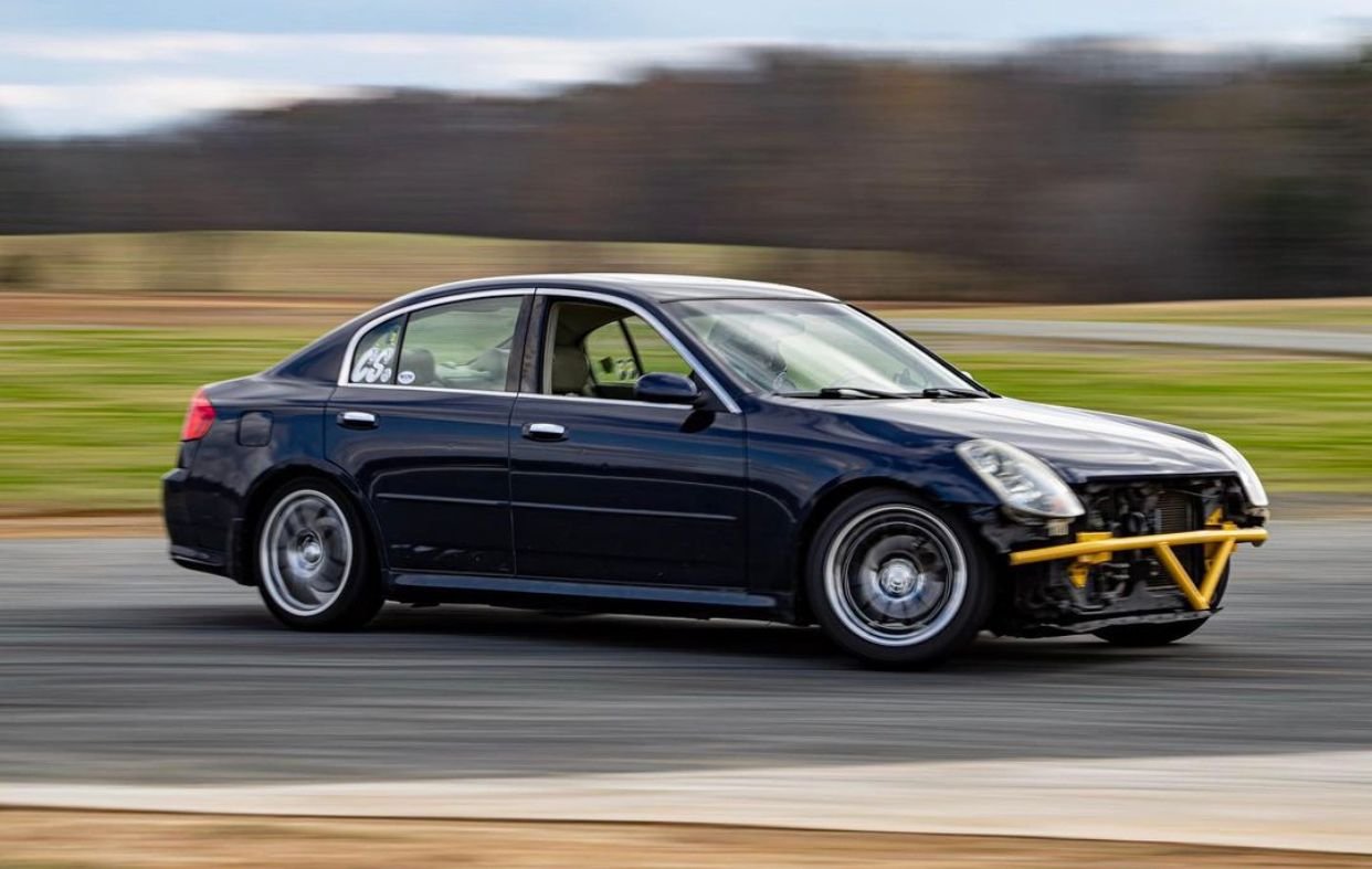

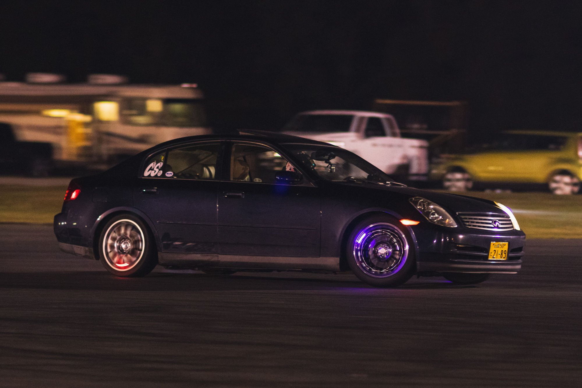

November was here and i was at my fourth drift event ready to thrash my car!
SHE LOOKS SO GOOD!!!
I was noticing improvements each time i went out. I was still struggling with figuring out line and managing speed, but I was having a blast out there!!!

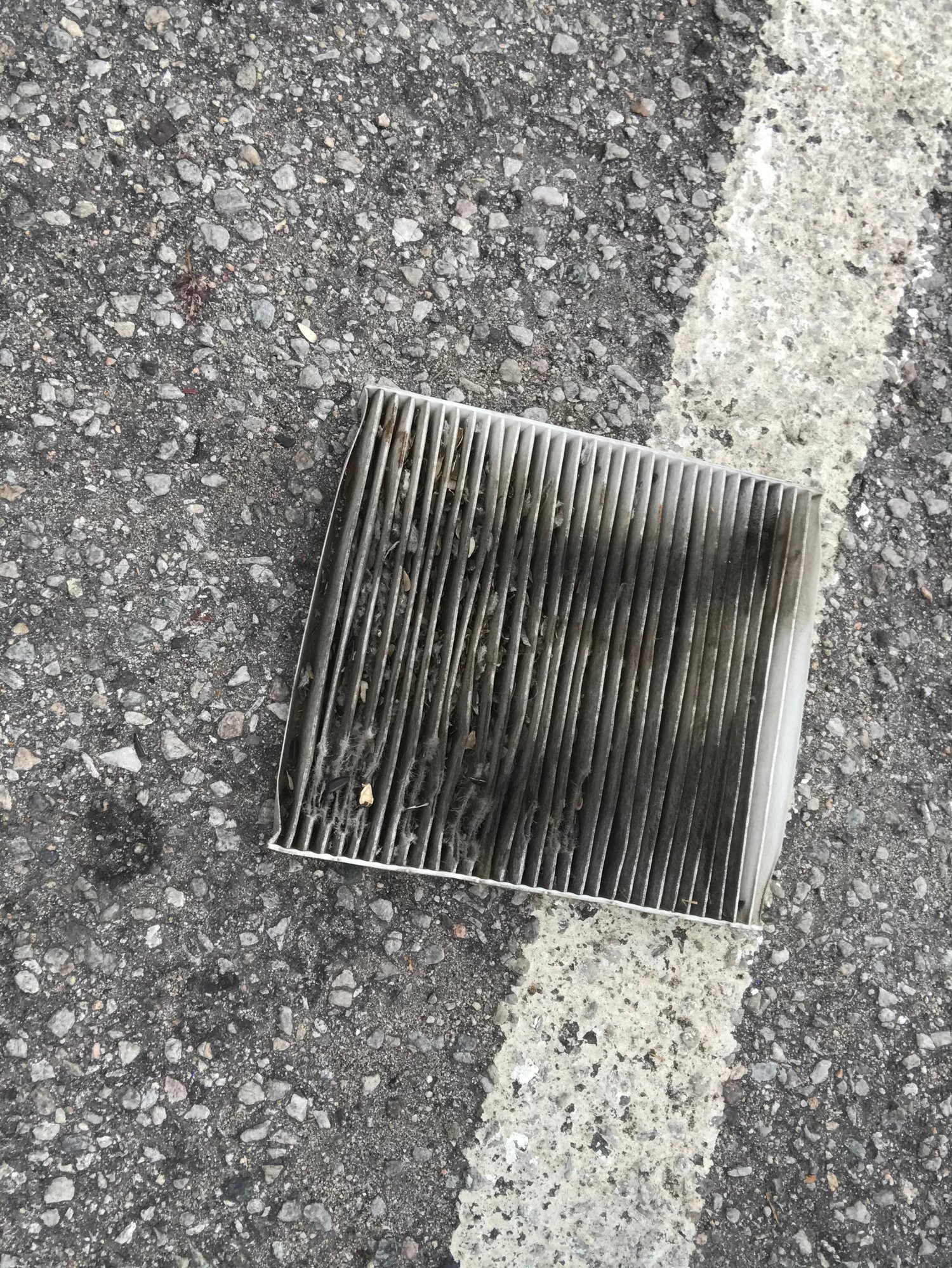

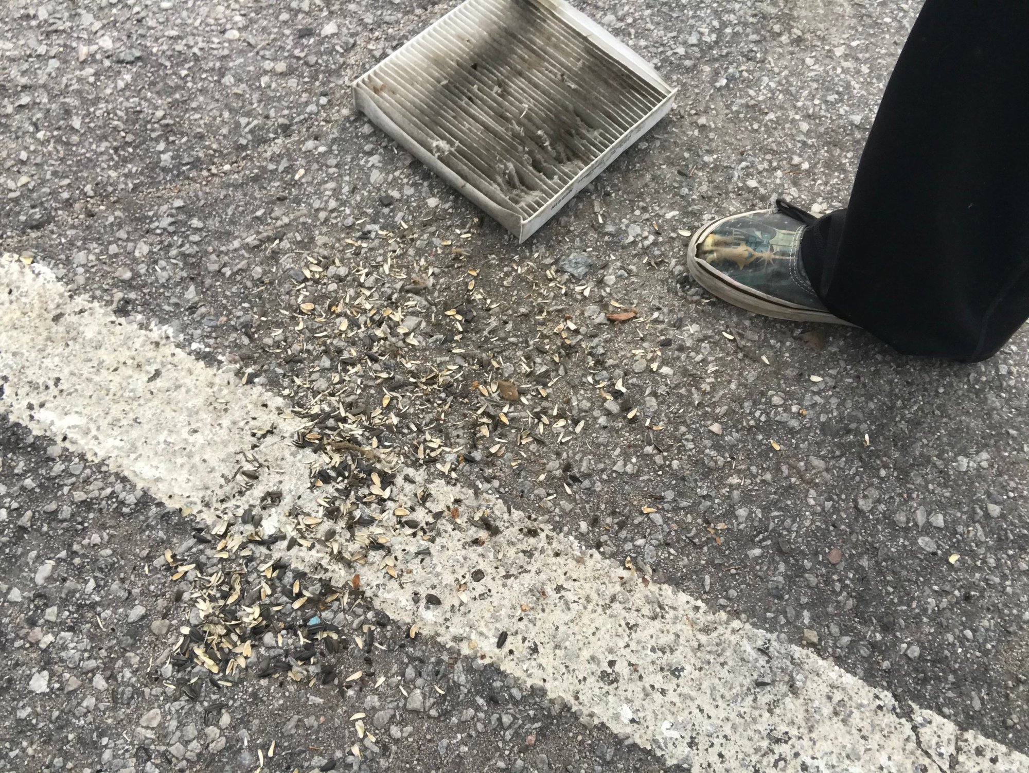

Check your cabin air filters kids!!

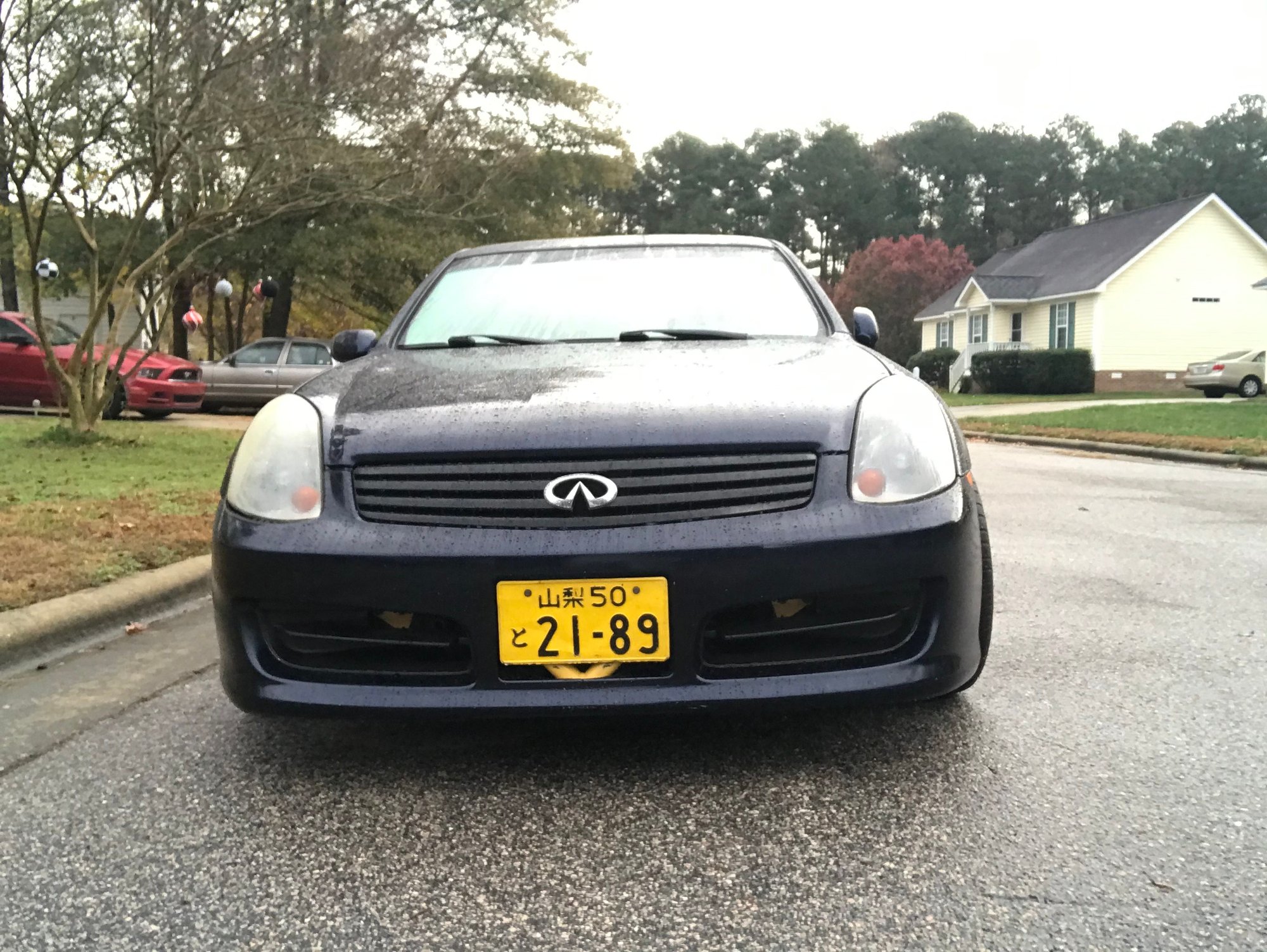

Painted the grill black on a whim and was thrilled with the results
And here's how she sat on December 2nd 2020. I was already thrilled with how the car was coming along!!!

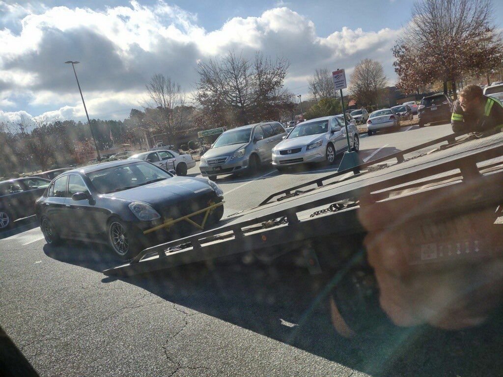

So a lot of things happened in December. A looooooot of things. It started when I noticed a strange noise coming from the rear of the car. It almost sounded like a ratchet. So I decided since I had never changed the fluid on that welded I bought I light as well….
wellllllll fug
well the diff is still locked so I can still drive it right? Of course! Just use a magnet and clean all that out!
Piedmont drift threw a girls day and I was so hype for it. I even ordered seat rails for my bride so I could get it in! I made my Roomate take off so I could finally take him drifting. And…
fug

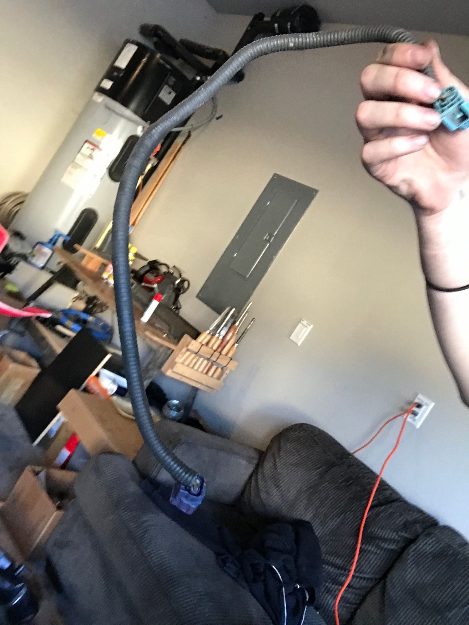

Guy had a blowout in front of me on the way back from the tire shop the day before and I guess it hit the crank position sensor on the bottom of the engine
So these cars will run with them but not start.
Wish I had caught this before the tow truck came. I could’ve avoided a tow fee.

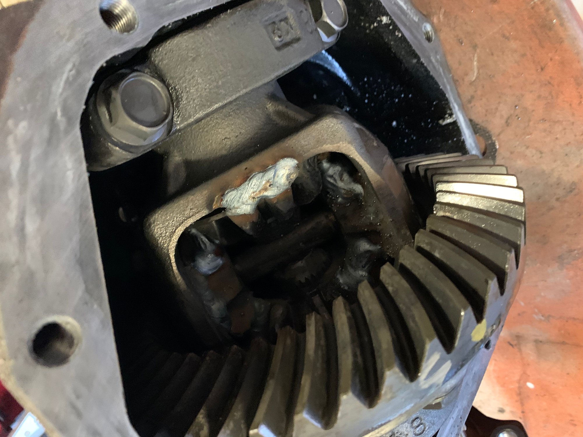

and then a week later the diff gave up.
Welds broke and I was back to that open diff life.

Next time you get a diff welded make sure they cut a plate to put in it instead of just welding the 4 corners. Weld that plate in on all sides to COMPLETELY stiffen up those gears, that will be good for anything you throw at it N/A. I can pretty much guarantee if it broke they only did just 4 corner spot welds and called it good.

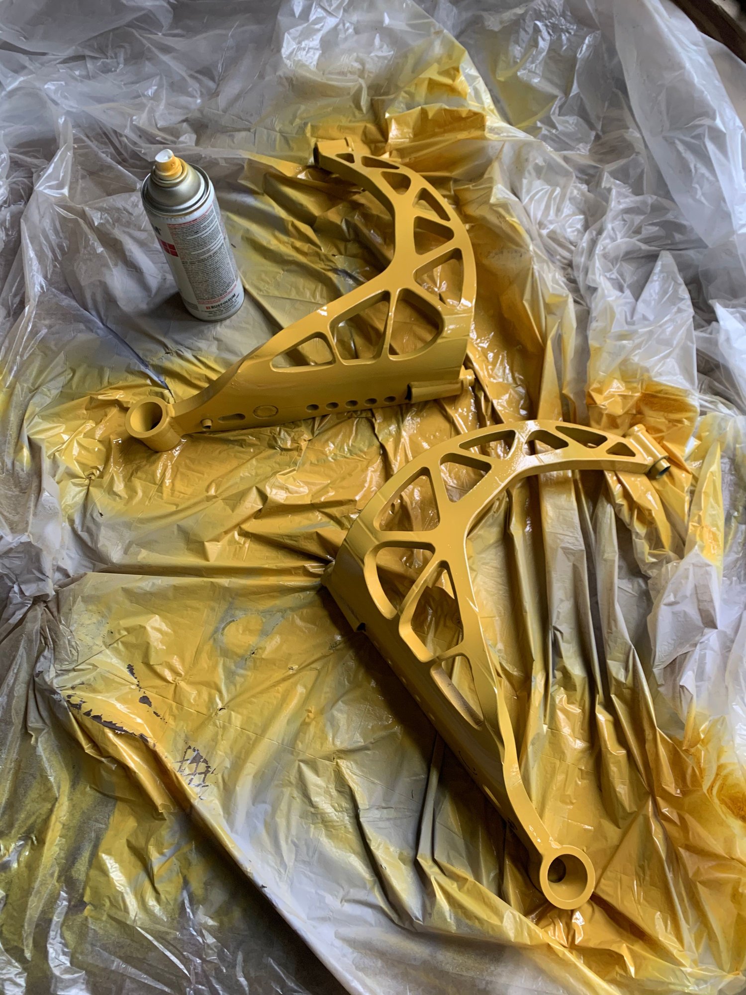

Painted the puppies yellow to match the bash bar.
Turns out these ****ers were a pain in the *** to get on

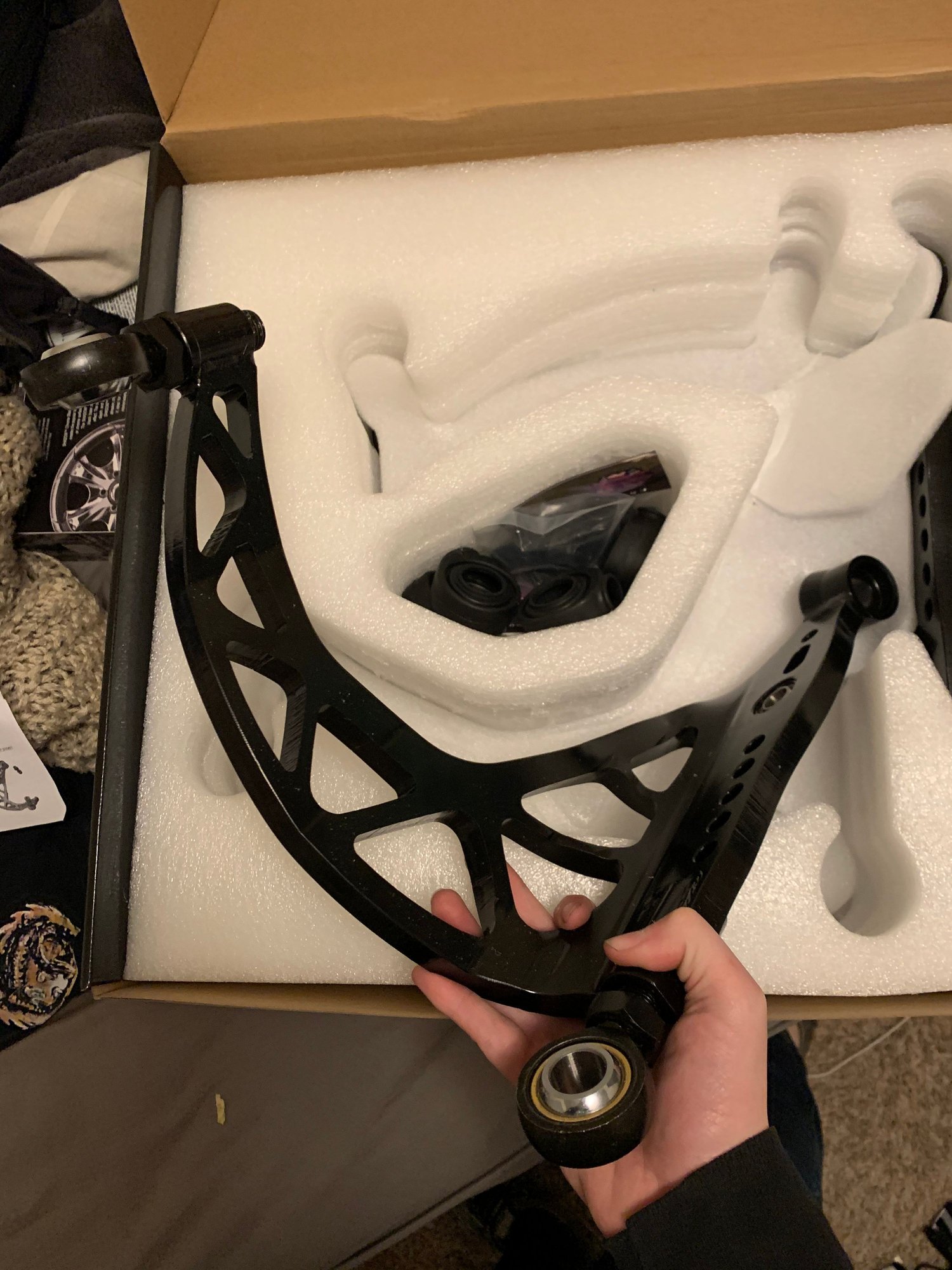

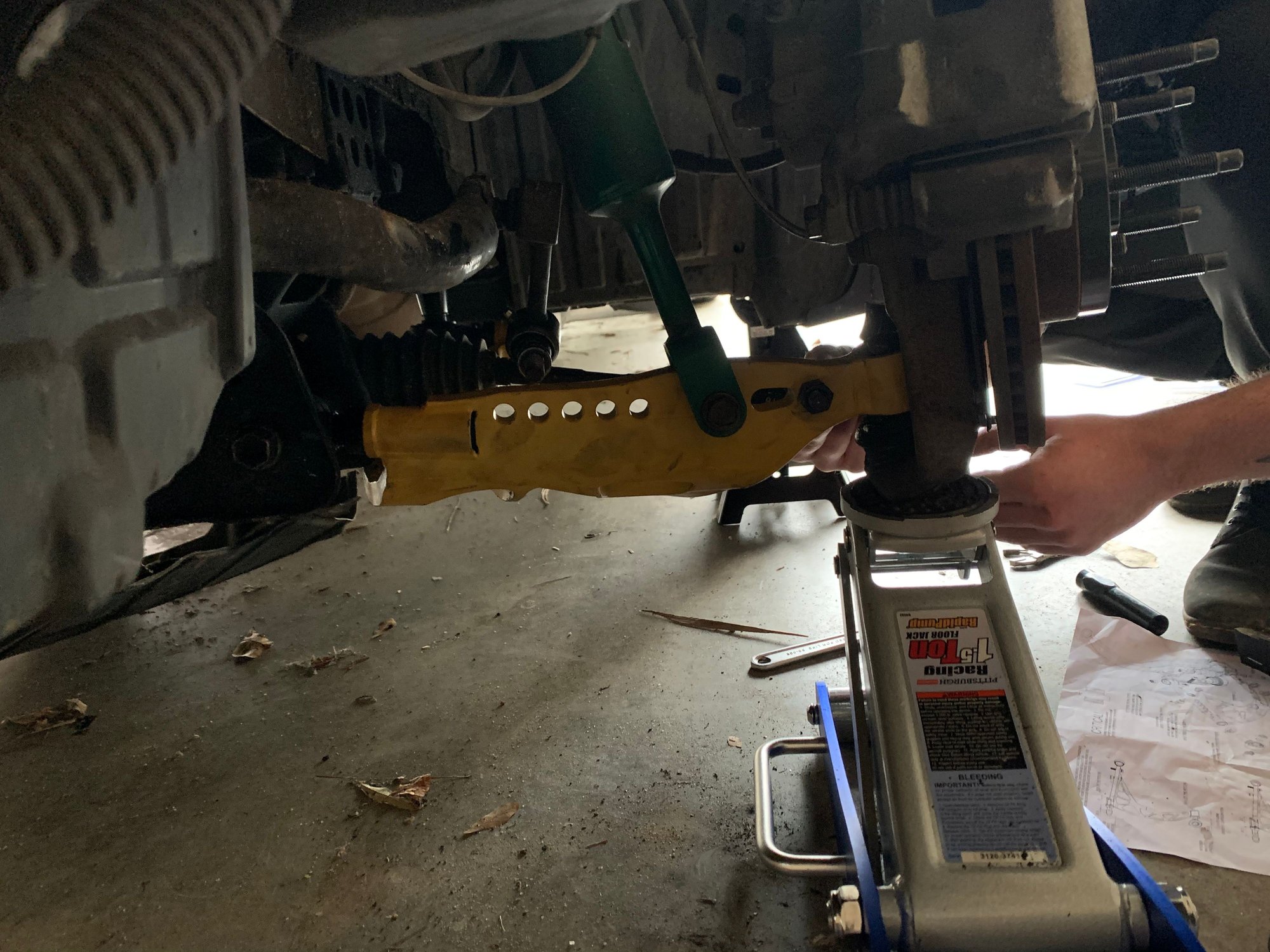

So the big reason I went with the GK Tech Kit over any of the other kits was the fact it changes the control arm to a single piece design eliminating the crazy caster change these cars get with lots of steering angle
A week later I got to try them out at piedmont and i mark this event as one of the big turning points for me drifting.
It rained the whole event and I had never run the track in the wet before. The surface taught me about car control and was really where i felt like i got it and I had full control of the car.
Also, can i talk about just how much the arms do for these cars? its unreal. the car handles so much better now. The car is so planted and put together.

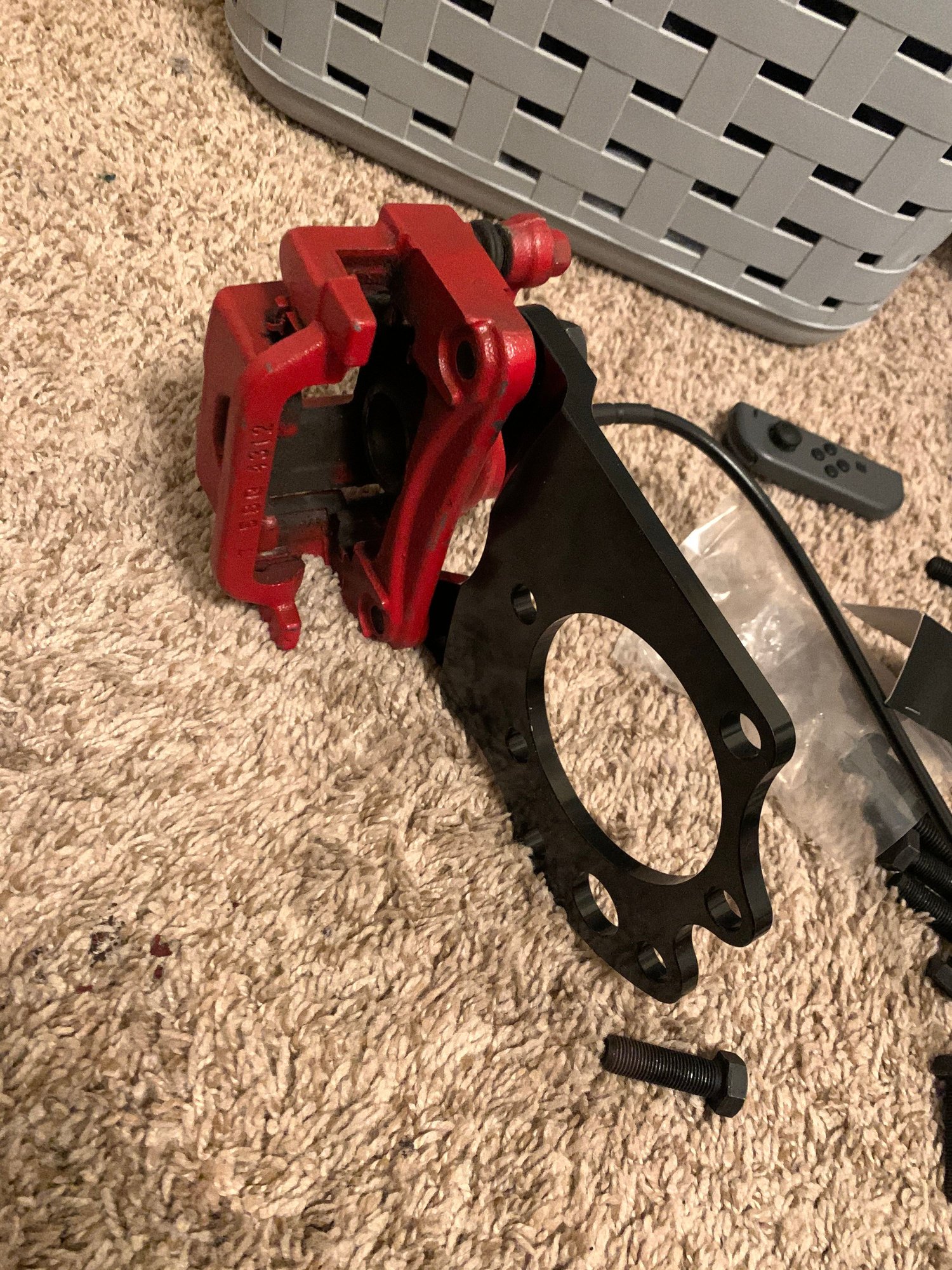

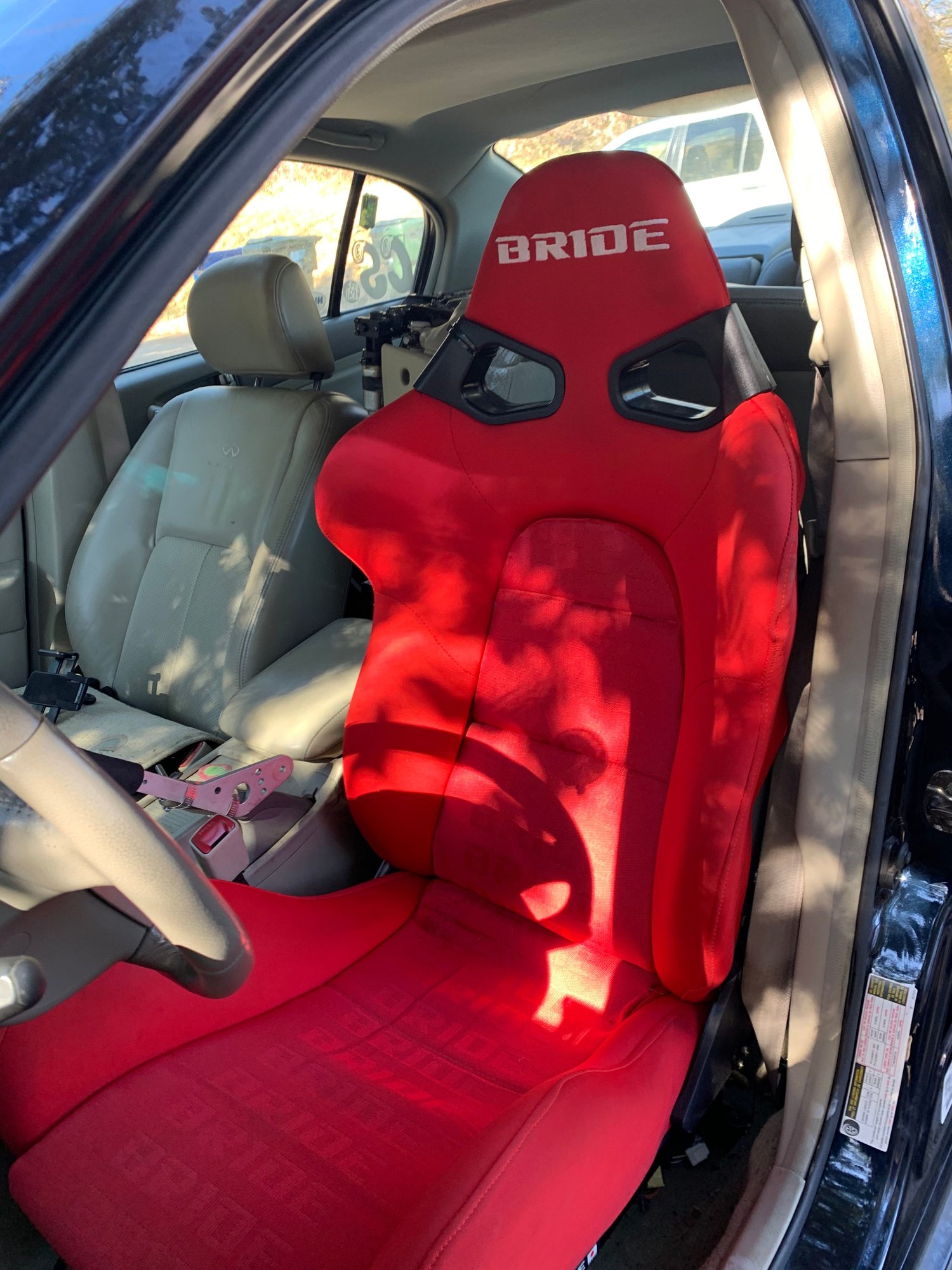

Picked up some dual caliper brackets from another g35 owner on FB
Next item on the itinerary was seat! I ordred a seat bracket back in december and it finally showed up in February! Turns out the Bride I thought was a Cuga was actually a Cuga HL, a seat they stopped making brackets for in like 2010. But after a bit of "persuasion" and custom bracket extensions made out of a MR2 Seatbelt cross brace we got it to fit! I knew the stock g35 seats were going to be heavy, but I didnt realize just how heavy they were going to be. I can barely pick them up.
Honestly between the seat, coilovers, and control arms. I dont know what is a better mod.

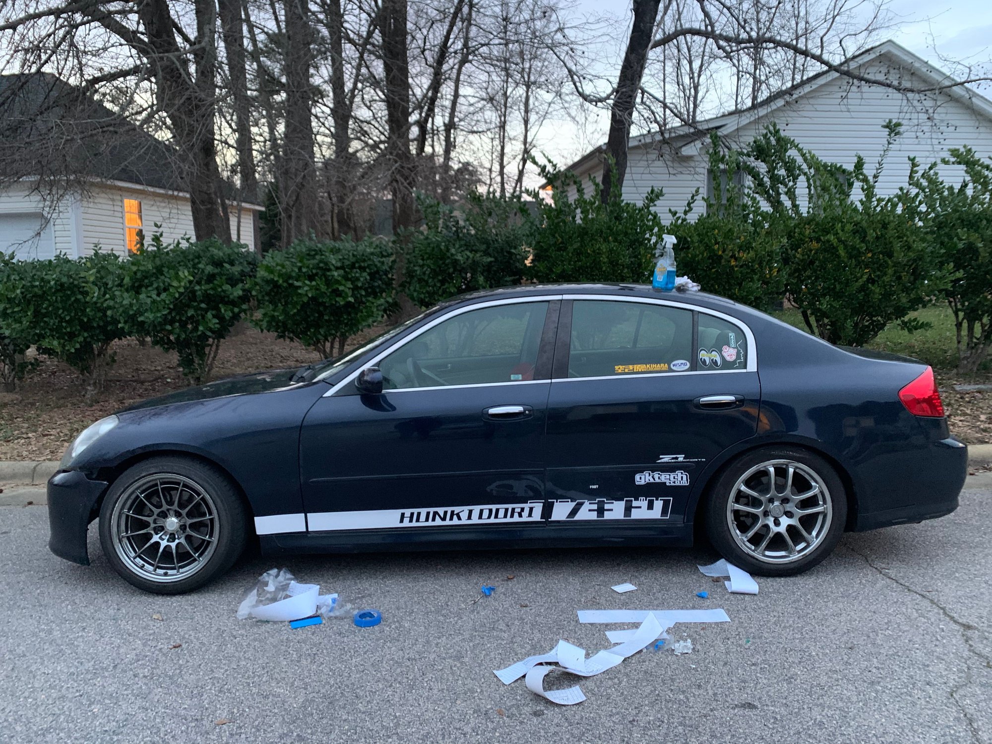

With the car feeling much better it was time to do some more creative things to it.
After becoming obsessed with the team charme JZX and Verossa as well as the garage33 g35 I knew I wanted to do a similar look. I had no idea what it was called at the time so i kinda just did my own thing.
getting more use out of that vinyl cutter i bought
It turned out sooooo much better than i was expecting. Slommy had developed such a pressence and personality.

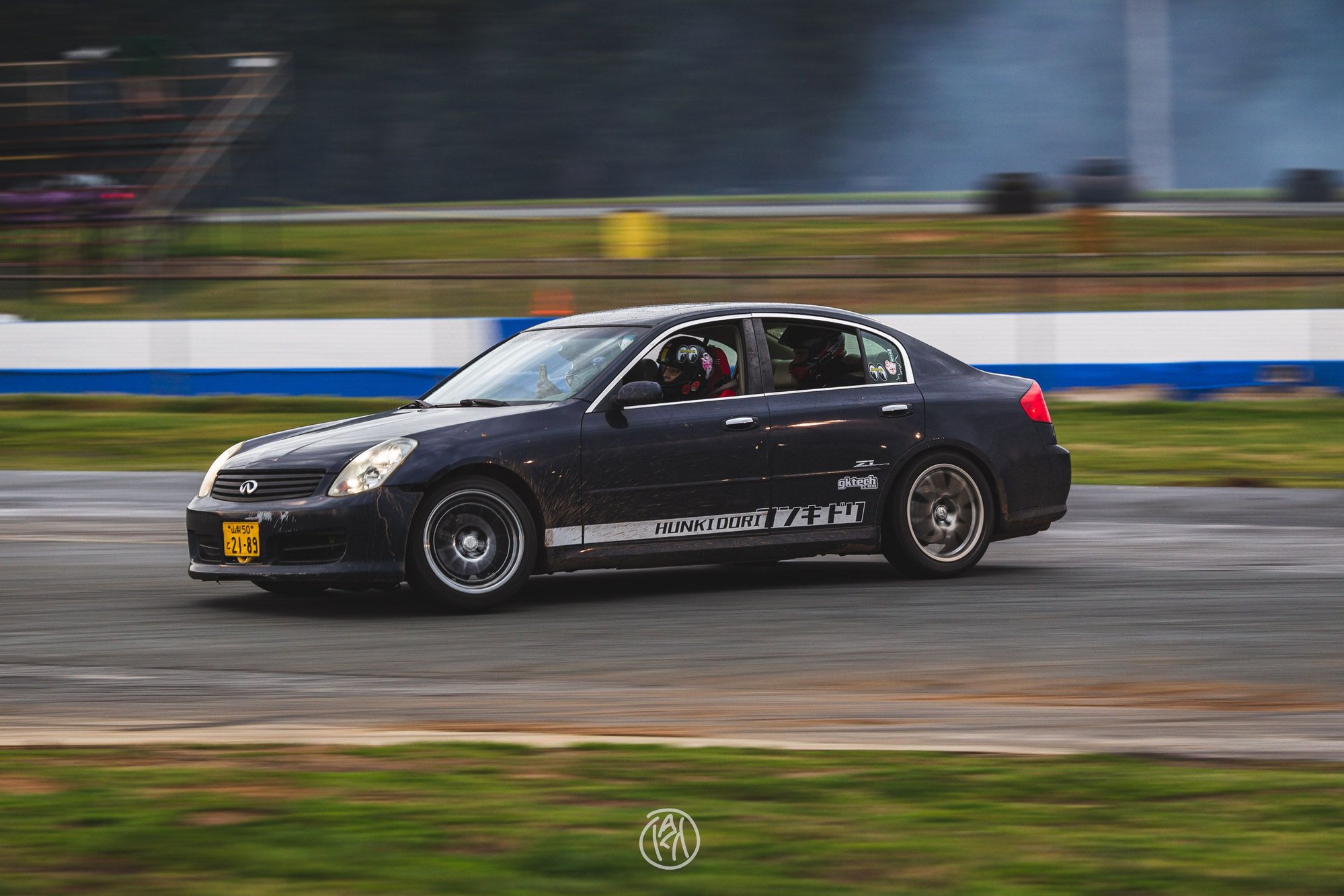

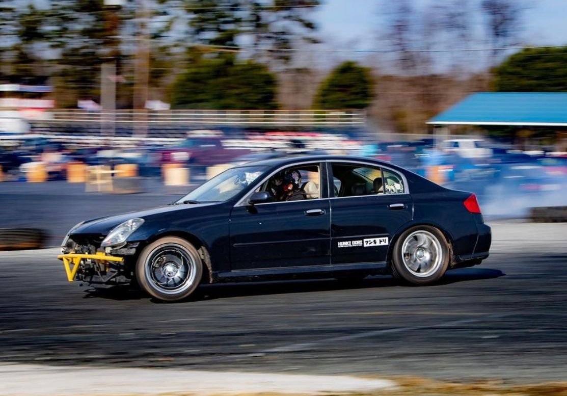

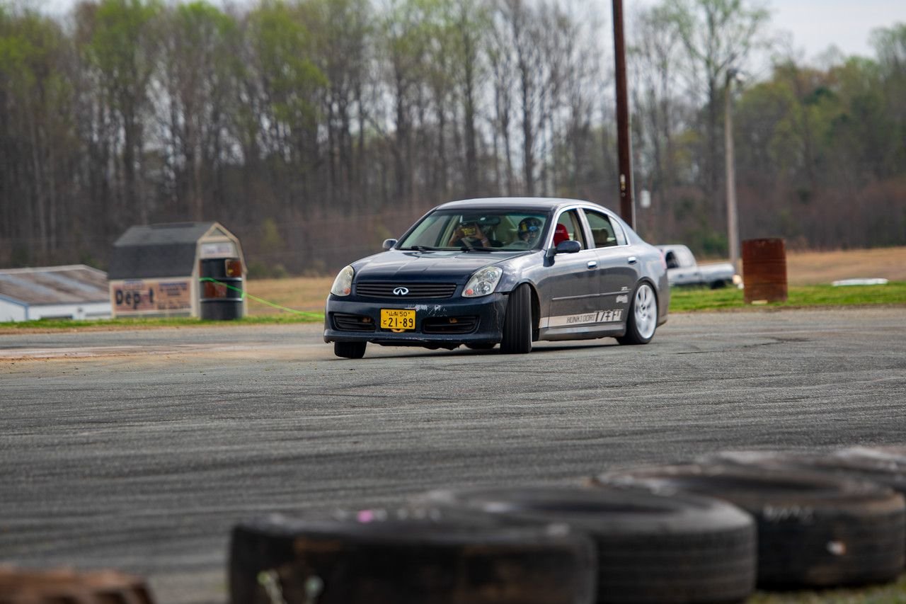

Slommy finally looked as cool as she drove! This was the next Piedmont 2 day up in March. This was also my first event with the seat in the car. SUUUUUUUCHHH A HUGE DIFFERENCE OH MY GOD
Even convinced one of my buddies to bring his MR-S out! Im kinda jaded with him tho. His very first time drifting at piedmont, guy was able to link the course by the end of the day.
My event ended early unfortunately. Mid way through sunday i had a pretty bad off and the impact from it must have been the final straw for my driver side motor mount.
But i wasnt too bothered! It was a fantastic weekend full of drifting and hanging with my bros!
