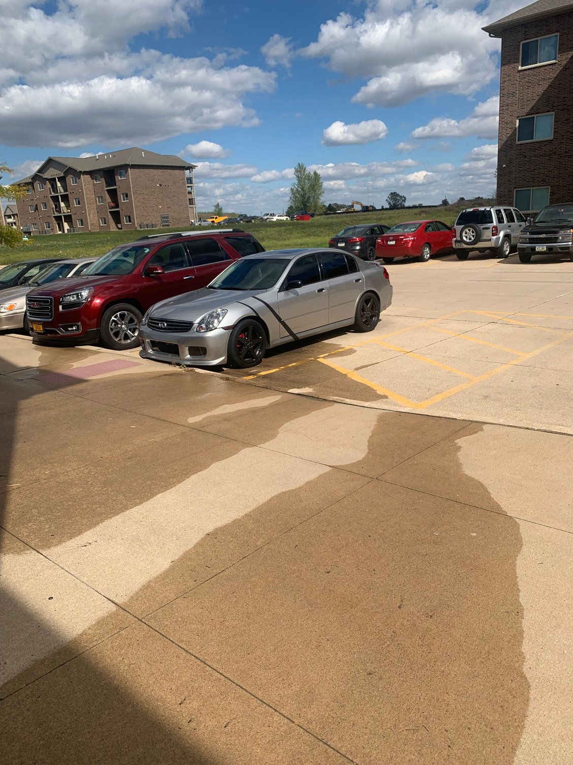

I have a aftermarket front bumper, including custom rims and tires and a few accents of black.
Question 2005 Infiniti G35 Sedan Questions
Just recently join the website, I was wondering if anyone had any mods that would improve proformance and which modifcation should I buy first that would make the most bang for your buck because currently I'm in college and don't have tons of time to work and earn money. In the title is my car, a 2005 Infiniti G35 Sedan. So far for performance I installed a new air intake, and a muffler delete. Budget wise I'm work with around 1500 and I was thinking on spending 500 on Raceland Infiniti G35 Classic Coilovers. Any Info is appreciated!
