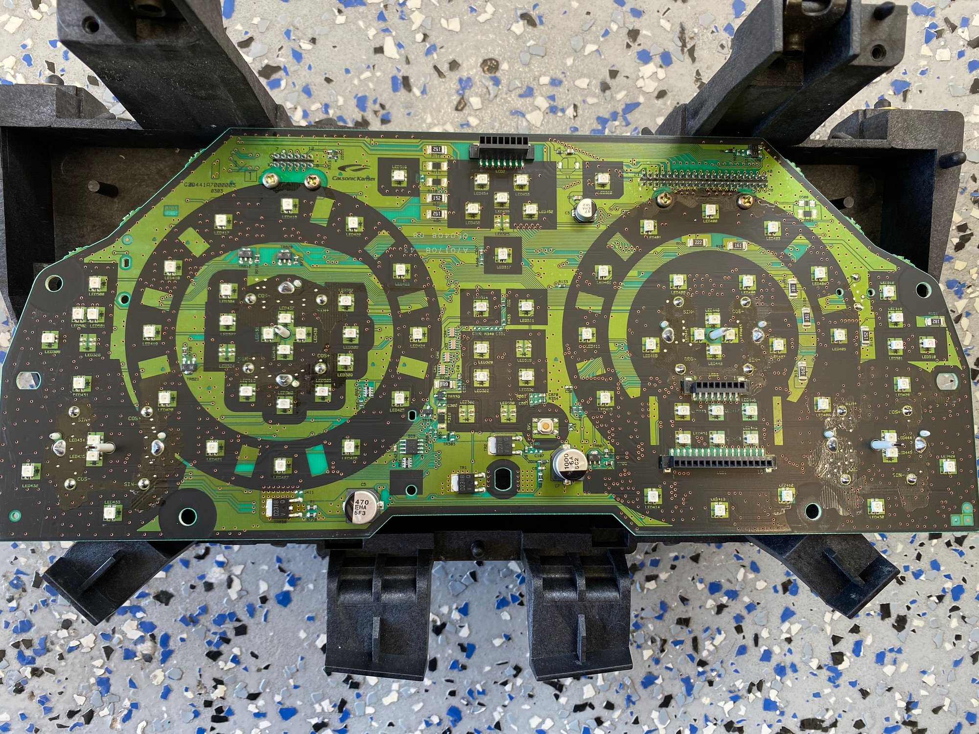

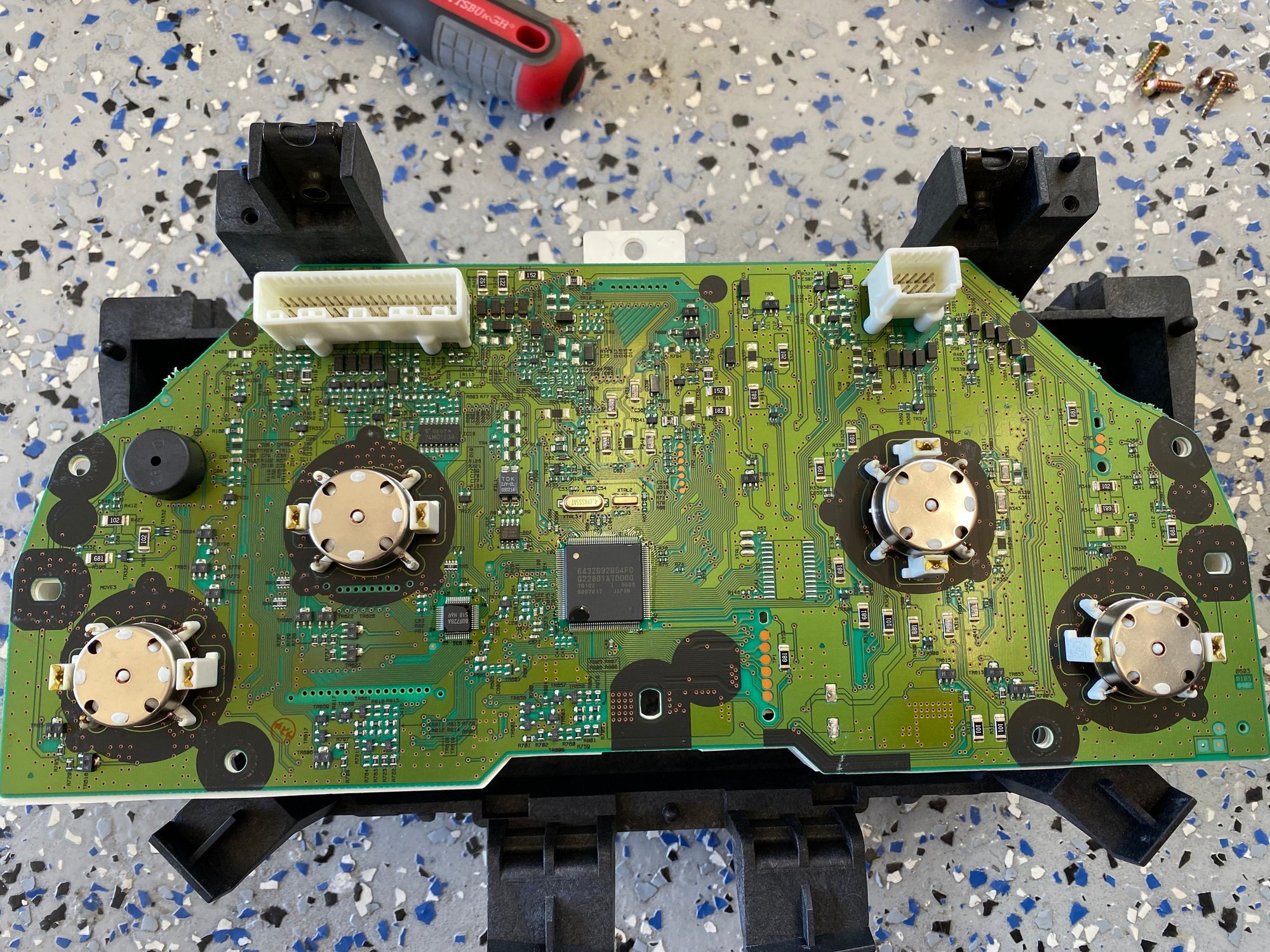

Sounds like most of your problems are due to a bad cluster. I dunno what Nissan did when they made the clusters for these cars but the PCB boards inside suck asś. It seems they have a tendency to break contact due to cracked solder joints and even inside the actual circuit lines in the board itself.
I had the erratic fuel gauge issue on my car…someone figured out that there are a few resistors on the board that need to be re-soldered and that will fix the issue. I have done this fix to multiple clusters already.
As for the manumatic issue, if you have verified that the micro-switches at the shifter assembly aren’t the problem, then that issue is also due to your cluster. (I’m betting it is).
I bought many used clusters in hopes of experimenting and figuring out “the fix” for the notorious manumatic issue but had no luck. There are about a thousand resistors and other kinda electronic chips on the board….really really tiny ones. I used a fine point soldering iron to re-solder all the ones I possibly could, but that didnt help. Most of the chips are impossible to solder by hand because of their micro size. I have even went over the whole board with a heat gun in an attempt to soften up the solder and maybe re-weld and broken contacts. Still no help!
In my experimenting with multiple cluster gauges, I found many of them had LED lights that were intermittent, and would come on if I actually bent the board slightly in a certain way, or applied pressure in some parts of the board. I’m pretty sure it was because of broken contacts throughout the inside of the board circuits. I encountered these kinda issues with cruise control lights, blinker lights, parking brake lights, rpm backlight lights, and the digital odometer backlights. Some would be inop, some would be intermittent, some would flicker between bright and dim. And I know it wasn’t a burned out LED bulb because I would replace the LED bulb with a new one and it would still act the same.
Maybe an electrical engineer would be able to figure it out…but its way above my knowledge. I just ended up buying a few different used clusters and got lucky with the last one. Everything works fine now except for the SET light when I set my cruise control speed. I am willing to live with that lol.
Here’s a few pics of the cluster board if u wanna see:
