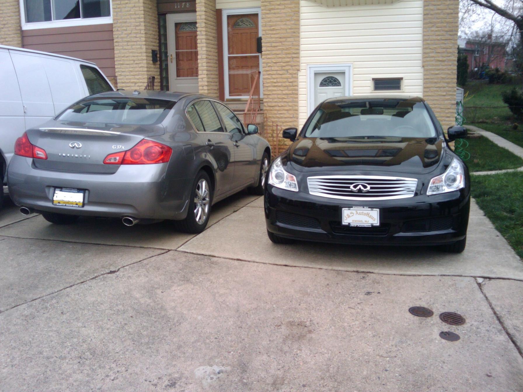

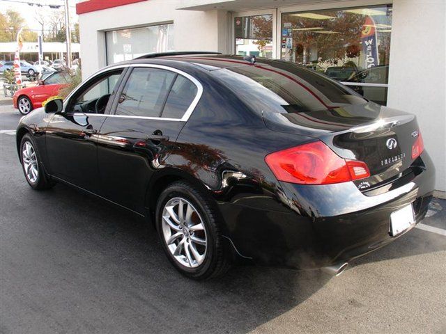

First off, i'd like to introduce myself and say that i've been reading up on the G for a while before buying one and now i have
If anyone here owned a KH3 2007 G35x from Pepe Infiniti in White Plains, NY with all the packages & toys/wood trim, i just bought your car
I'm very excited, as my previous car was a '97 maxima GLE
