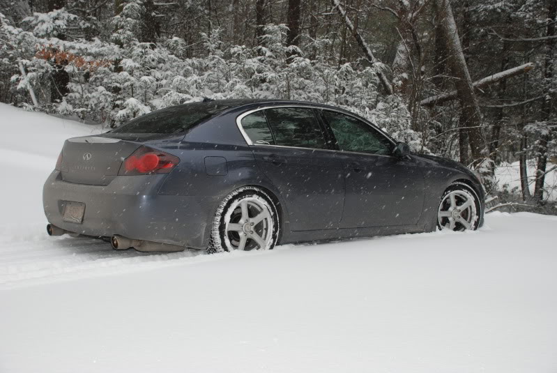

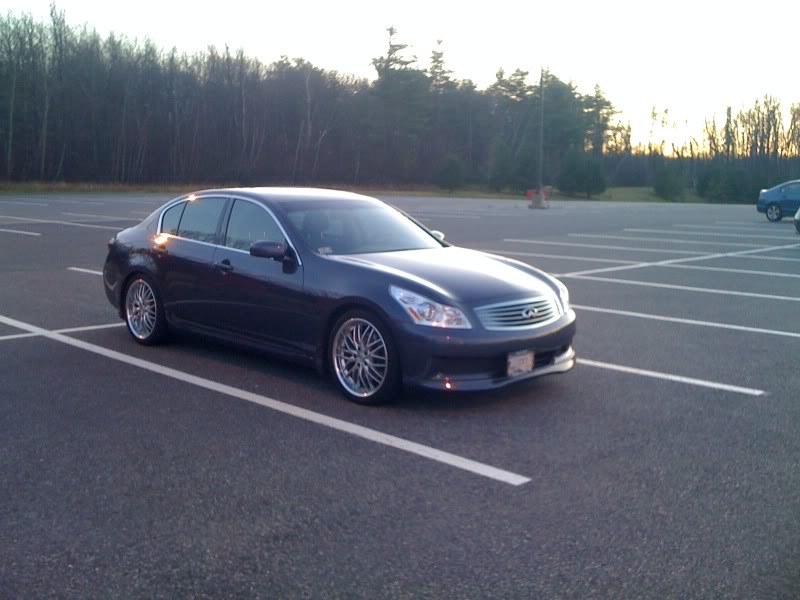

I run 19x8.5's in the summer (245-40-19) and I have a dedicated set of 17's with Blizzaks for the winter.
SUMMER
WINTER

love the pics

Originally Posted by AesonVirus
SUMMER
Which wheels are those? Getting my 07 x on Saturday (hopefully) and starting to look for some summer wheels?
Also, (obviously haven't search for the proper threads yet...) are those just the stock wheels you use for winter or do you go narrower?

I like this calculator....
http://www.autos.ca/tools/tirecalc/tirecalc.htm
It tells you everything, including how far of your speedo will be.
My wheels are MRR GT-1's in Hyper Silver
They come in Black or Chrome as well.
Same size as OEM for my winter setup
I got the winter wheels and tires from Tire Rack for under $800... not a bad deal.
