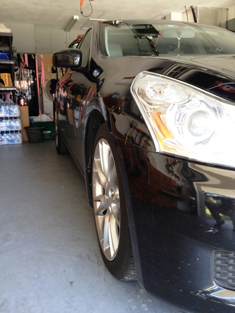

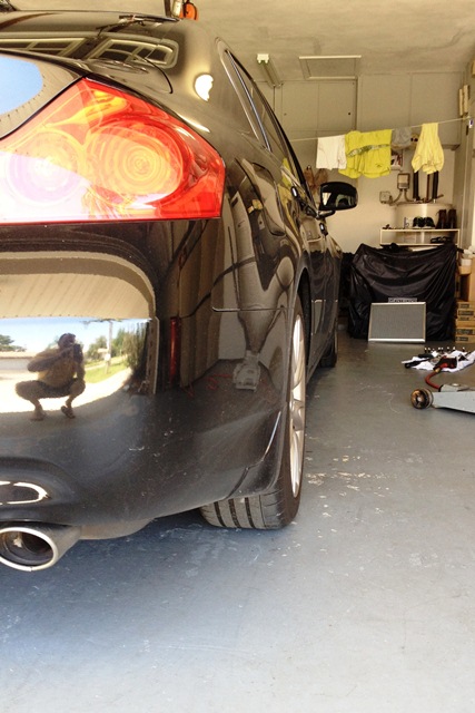

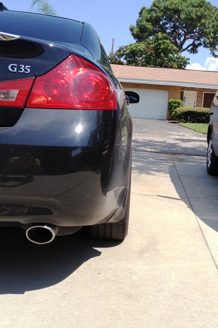

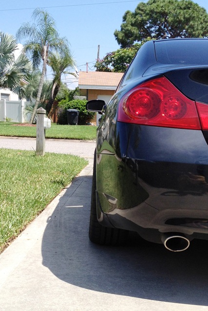

I am not posting pictures as a DIY as it is pretty straight forward. One tip, scour the mounting surface on the brake to clean it up and remove any debris. I also used red loctite on the install.
I have been eyeballing the car ever since I did the 370Z springs and trimmed my spring perches. Just didn't look quite right - a little froggy!
I went by b2autodesigns in Tampa and Adrian (?) and I took a good look at it with a full tank of gas. The fronts had plenty of room but since I have sport wheels (1/2" wider in the back) not so much in the back. My original thought was 15mm front and 20mm back but we thought that 20mm front and 25mm back would look better.
I bought their spacers - extremely high quality! I bought a set of 20mm and 25mm. I did the passenger side first mounting the 25mm on the back and the 20mm on the front. The front looked great, but the rear stuck out too far. So, I mounted the 25mm on the front left and the 20mm on the reay to do a mounted comparison. Drove the car a little to get everything settled. Pictures say a lot.
The 25mm front and 20mm rear looked a lot better, so I switched the other side. In retrospect, 20mm front and 15mm rear would probably look as good or a little less aggressive. But I am happy so far. Give you an update after the first tank. Here's the rears...
Attached Thumbnails 08 G35 Sedan wheel spacer install-lr-25mm.jpg   08 G35 Sedan wheel spacer install-rr-stock.jpg   08 G35 Sedan wheel spacer install-rr-20mm.jpg

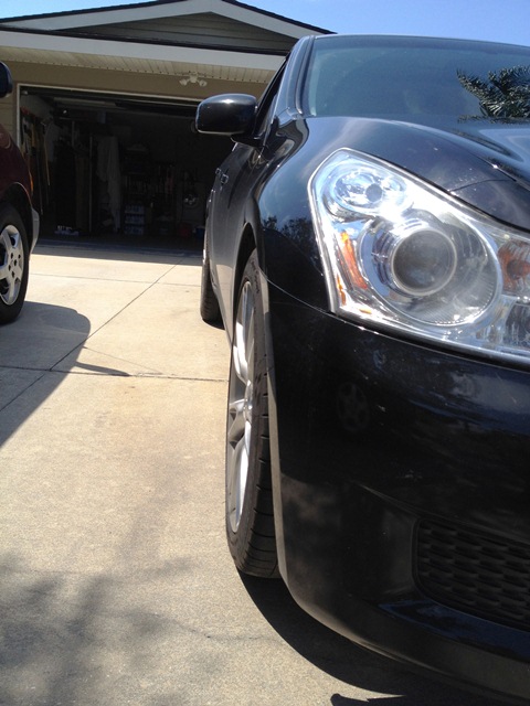

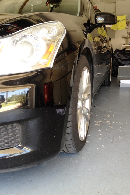

now the fronts
Here are all three options: stock, 20mm and 25mm.
Attached Thumbnails 08 G35 Sedan wheel spacer install-rf-stock-2.jpg   08 G35 Sedan wheel spacer install-rf-20mm.jpg   08 G35 Sedan wheel spacer install-rf-25mm.jpg

20 in the back looks good , looks like the 25s poke them out a bit. I was told to never use locktite on spacers, wasn't given a reason though
