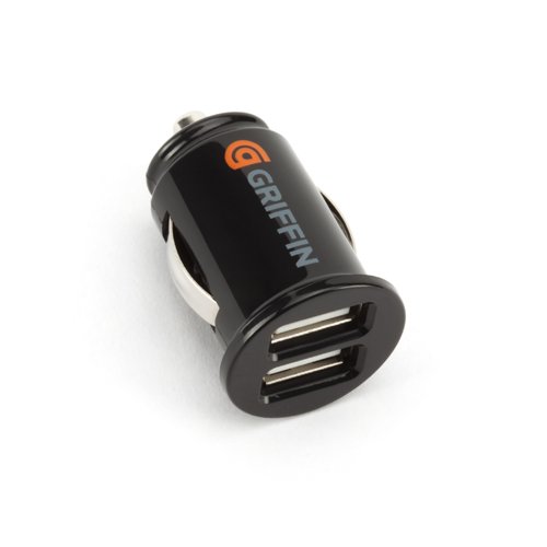

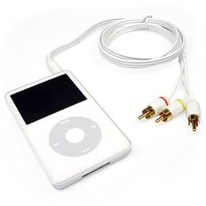

I have this set up in my 07 G35S:
This cable, http://ecx.images-amazon.com/images/...L._AA1500_.jpg
And then I got this to charge my iPod while it's playing, http://ecx.images-amazon.com/images/...uL._SL500_.jpg.
Definitely not a bed set up, IMO.
Where did you get that cable tho?
Old Nov 23, 2012 | 04:49 PM
samuel1021's Avatar
Joined: Oct 2010
Posts: 94
Amazon. Just search iPod RCA cable, and the adapter is the Griffin Powerjolt.
Old Nov 23, 2012 | 06:14 PM
ngckevin's Avatar
Joined: Nov 2012
Posts: 7
Alright, just bought them, thank you so much
