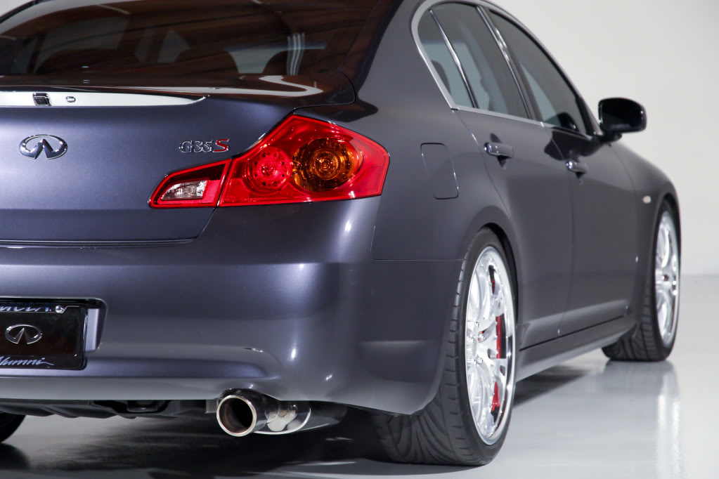

You have a better chance of clearing now with a 43mm rear offset on a 10" wheel. I had a 48mm offset which means that your tire will poke out only 5mm more assuming you went with a 285 tire and camber is in spec.
Judging by this picture and knowing that the rear fenders are factory rolled, I would guess you can get the 285 tire to work.
