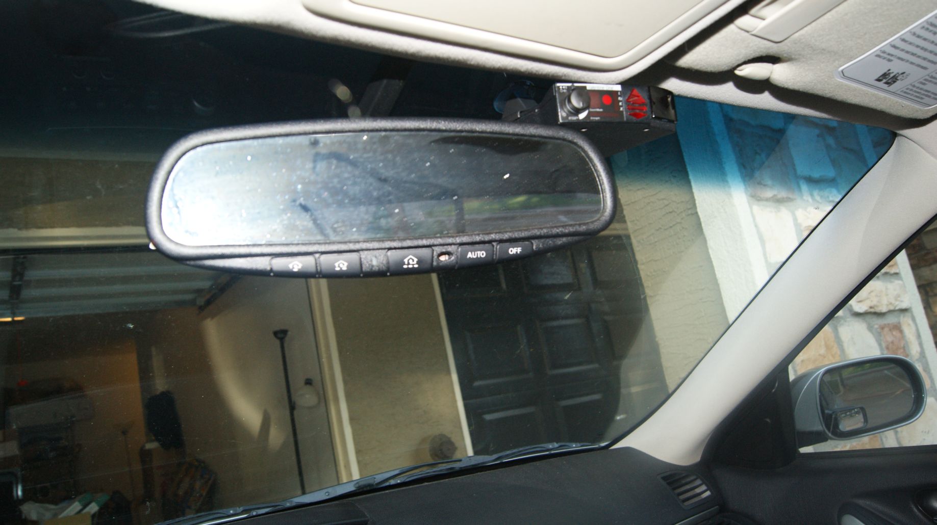

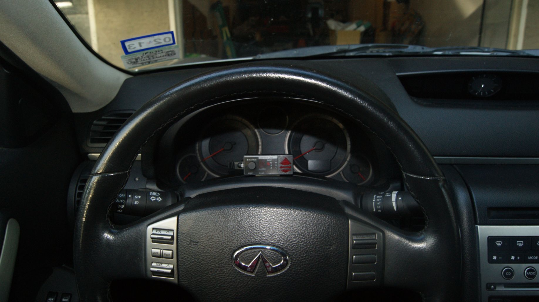

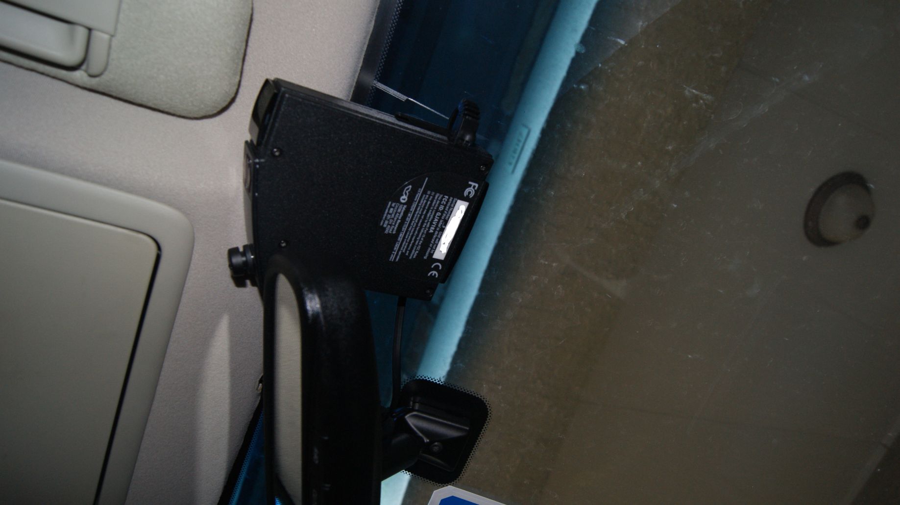

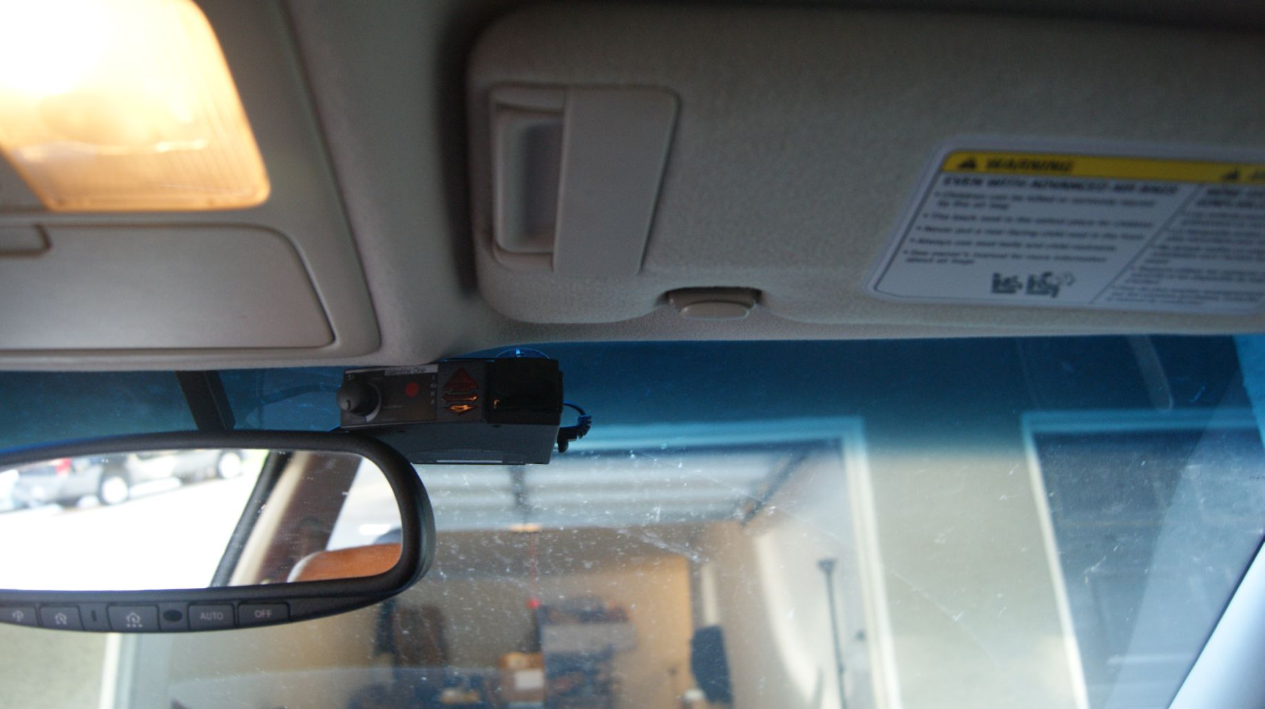

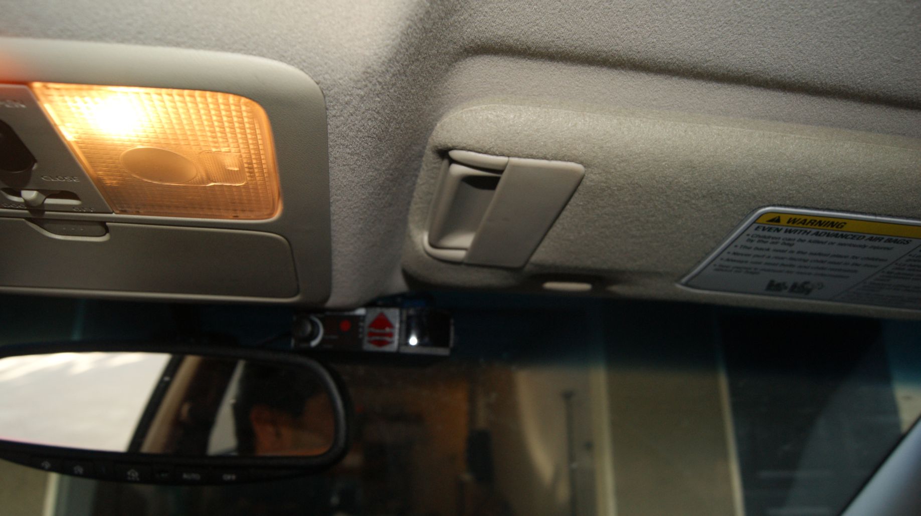

Only one correct way to mount and install a valentine. Stops wasting money on a FREAKING phone cable that is priced roughly 20x what it is worth. Stop paying for mounts when the one included in your radar package is perfectly fine and level. I would recommend buying the valentine savvy for installation simplicity and filtering capabilities.
Attached Thumbnails Just ordered a Valentine 1...some Qs-dsc00178.jpg   Just ordered a Valentine 1...some Qs-dsc00183.jpg   Just ordered a Valentine 1...some Qs-dsc00172.jpg   Just ordered a Valentine 1...some Qs-dsc00173.jpg   Just ordered a Valentine 1...some Qs-dsc00189.jpg

looks good...but i think i will put mine on drivers side mirror..can you see all displays from that side ok? My only problem is my fast pass is on the right side

Anyone who even tries to view the display on that side is just flat out stoopid for even trying to get their eyes off the road. If you look at the picture previously attached and the picture I am reattaching again. You will see the valentine concealed display that redirects all output to a remote location. A location right in your field of view and right in front of the speed cluster. This makes it extremely easy to hit the mute button, mount the radar up high for getting long range hits and out of the heat / thieving eyes. Well worth the $35 I spent on the Concealed Display.
There is no point to even trying to get any sort of laser reception with a RADAR detector and that is why you should not choose a laser optimal mounting but instead choose radar optimal mounting. Pick up a laser interceptor if you are wanting to suppress laser and make the cops life miserable.
edit: If you choose the driver side mirror you will be blocking the rear antenna when you put your visor down unless you are putting it in the middle of the windshield. I prefer it on the passenger side and would move the toll tag on the other side if you have to. I don't have passengers all the time and if they are in the seat and decide to put the visor down. I know that my radar rear reception will be partially compromised. You want clear sight along with as high as possible for best radar reception.
