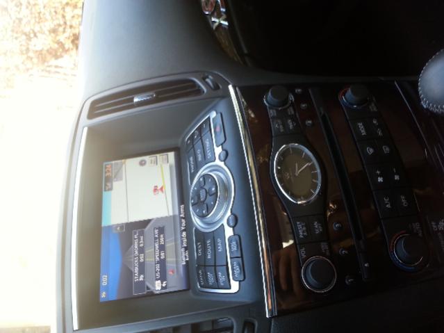

You can do it - a few of us on here have. You need the new monitor, new control unit, and the dash harness. It costs about 1k for the unit/monitor, 4-500 for the harness, and about a full day to do all the wiring changes. (unless you get really lucky and find a junkyard somewhat ignorant as to what they have.)
Bear in mind that you need a new faceplate - which won't match the rest of your trim unless you do a full 2010 console/ trim conversion (as I did,) which adds about another 750 - 1k to the cost.
If I haven't scared you off yet, pm me - I have pdfs showing the wiring changes.

Bluetooth Audio Question (AV Control Unit Swap?)-forumrunner_20131128_155309.jpg
