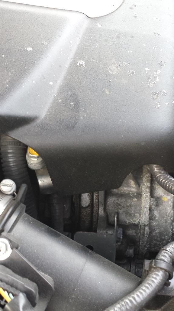

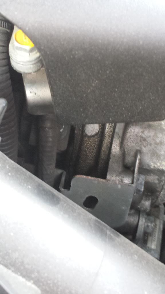

Hey guys the area where you had the oil leak around the timing cover did it happen to look like this??
Notice the spot where I wiped this oily substance off with my index finger in those 2 pictures.
