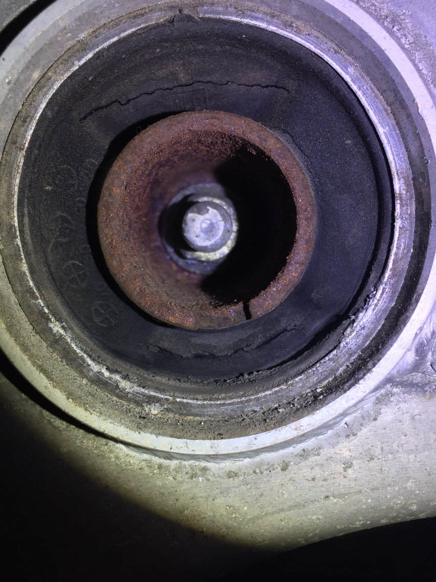

Does it seem to be an engine problem? My G had worn out driveline bushings which gave an odd feeling going on-off throttle that felt like lugging at low speeds.
