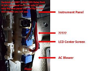

Anybody know what the 2nd relay in the attached picture is for? (2007 G35 sedan).
I'm tracking down an intermittent LCD screen issue whereby the volume and fan icons dont show up.
Attached Thumbnails Interior relay identification-2007-infiniti-g35-relay-rack2.jpg

No idea what those are, take it off and s3e what doesn't work

Cleric, I've already done that (go back and look at the pic)

Only other thing I can think it would be is a cruise control relay, I know it's one of those standard blue nissan ones but I've never had to search for it.

Why not grab the FSM for your vehicle and look at the wiring diagrams?

Rear window defogger, thanks for the encouragement Coffeysm I've been meaning to dig the FSM to actually FIND THE PAGE THAT SHOWS THE BACK of the relay board lol, now I know exactly where it's at.
http://www.nicoclub.com/service-manu...7_G35_Sedan/pg
Page 93 gobbell1
