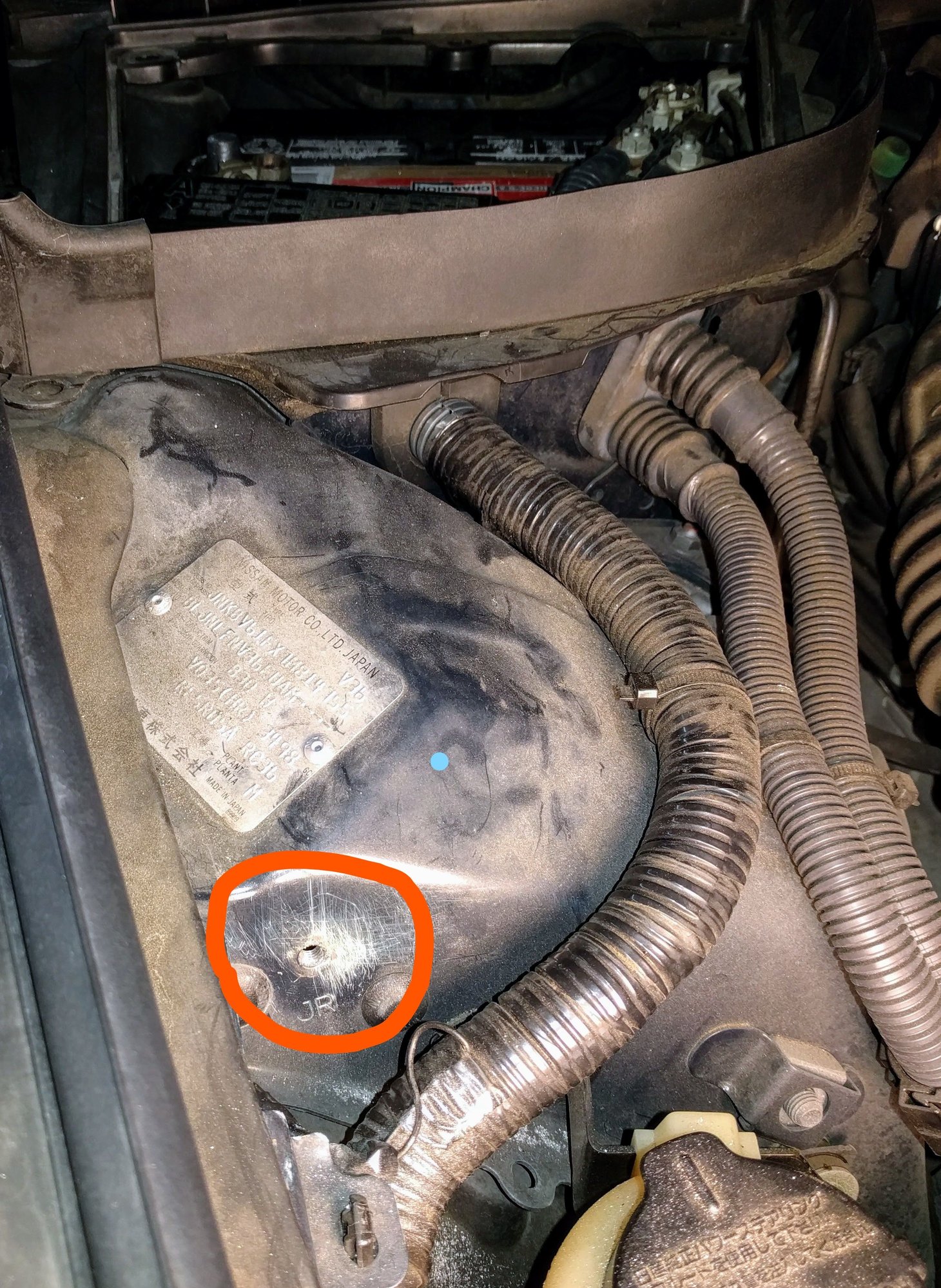

I was cleaning the engine grounds as I was having an electrical problem. When I tightened down the bolt, the head snapped. I was able to remove the bolt using an easy out (ironically named). Just need to get a replacement bolt. Anyone know what size it is? Thanks in advance for any help. The car is a 2007 g35x.

I'm pretty sure it's a 6mm x 1.0 pitch x 14mm long, they have a special anti corrosion coating and it's a specific fastener. Can't seem to find it in the online parts catalog, it's a SUPER common fastener and it's literally the same bolts used on every single Nissan. I'd hit up a wrecking yard and pull one off the ground system of anything Nissan/Infiniti they use them all over the engine bay.
