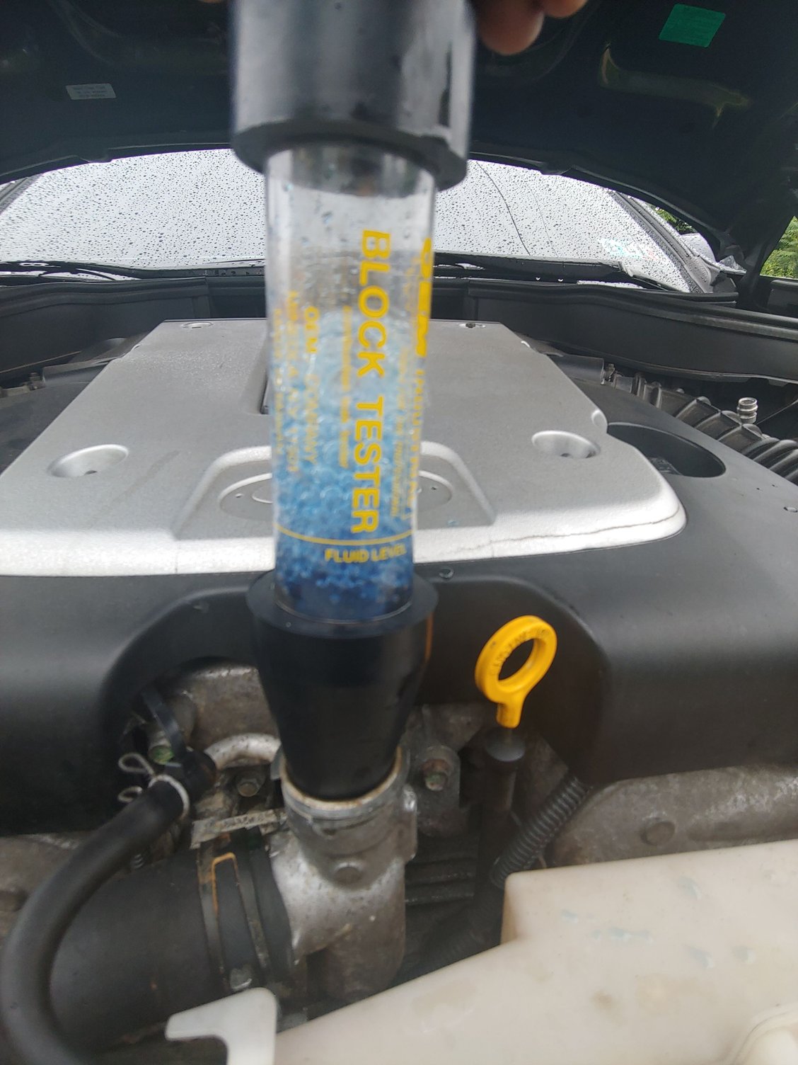

Test completed.
Let the car warm up a bit an ran the test
Came back negative for exhaust leaks in the coolant ☺
To confirm a working tester I went to the rear of the car and tested the exhaust and it turned yellow immediately
