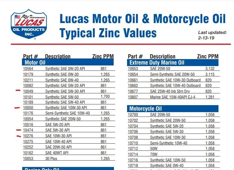

This chart from Lucas Oil lays out exact zinc levels for their various oils, I think the synthetic 5W-30 part number 10049, or the synthetic 10W-30 part number 10050 for hotter environments would be ideal for the HR engine.
I think Nissan does recommend "ester oil" (synthetic oil) for the HR engine but I'm not sure, if you don't need/want synthetic then use conventional 5W-30 part number 10474, or conventional 10W-30 part number 10276.
