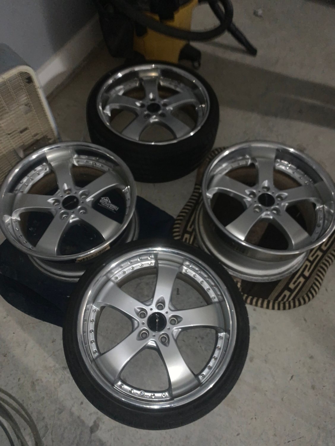

What tires should I run for my rears

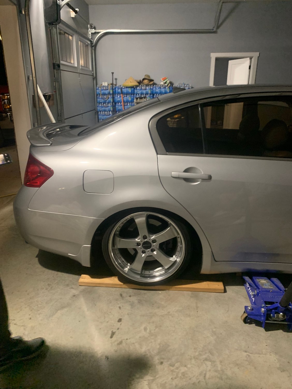

I bought a pair of ssr Vienna sovereign. They didn’t come with tires but the previous owner said he was running 265/35/19. I don’t have much camber I just lowered my car so I might have to roll my fenders or get more camber so if anyone can help with specs that’d be appreciated! Rears are 19x10 with 37 offset
Front wheel on rears

If the fronts are the same offset, you should only see about a 12mm (half inch) poke and clear hopefully rather easily.
Tire size you want to be within 3% range diameter of stock. If you just run them square you could probably get away with it on the sedan and get the best tire wear that way.

If they are too tall
Or
too short
they will throw /activate VDC when there is speed differential on the wheels really easily, think tighter turns out on the road.

I ran +3% with zero issues

Yeah it's sort of hit/miss right at 3% difference, tire wear and pressure starts to matter a lot since that can change rolling diameter. Anything over 3% though and it's almost definitely triggering the VDC/SLIP light.
