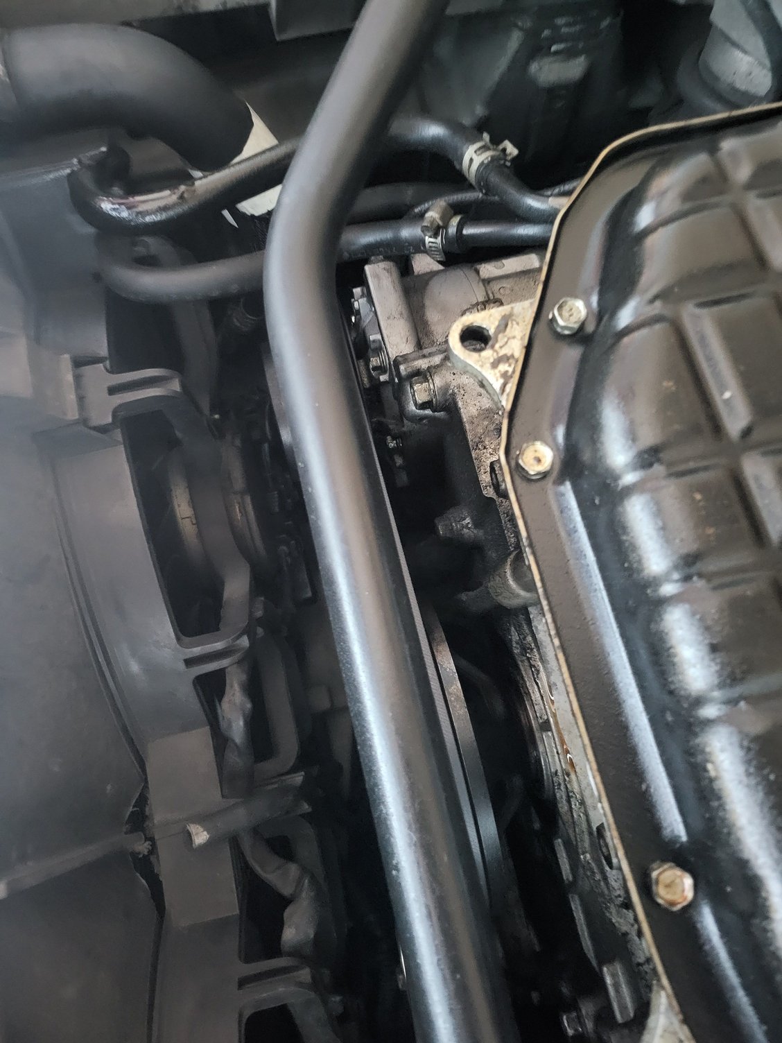

So i got everthing apart and it looks like my power steering o rings are leaking everwhere as well as you can see in the picture. I got new pullys and tensioner. Now i am waiting for the gasket for the passanger side cover. I also just hit 270000 miles 😅 car drives amazing still.
I am wondering if the power steering leak is what was causing oil everywhere due to it splashing on the pullys?
most likely. clean everything as well as you can and see if it comes back.

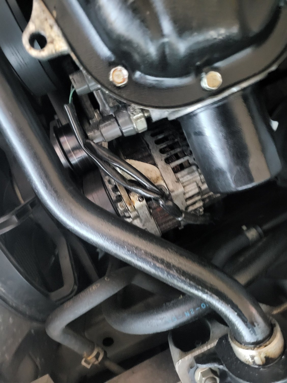

Bad news. Its leaking and it looks like its leaking more.
So the oil leak looks like it is coming from under this tensioner bracket thing. any ideas?

can't tell sh* from the pic, but the only thing there is the vvt/vct cover (aka "the fun" one). spray a ton of brake clean and see if you can tell where it's coming from.

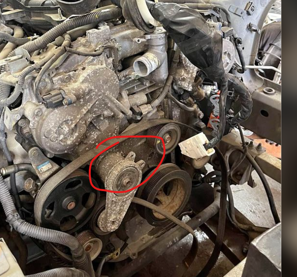

It looks like the oil is coming from this area (this pic is not my car) but what else other than the cover be oil coming from

nothing much else there. how bad is the leak? are you sure it's oil and not p/s?

pretty bad to be honest. i get low on oil in 2 weeks. time. it only leaks once the car turns off after a drive. It taste like oil lol...
Would you happen to know if the tensioner bracket bolt holds oil of any sort?
Old Oct 5, 2024 | 01:50 PM
99zx2turd's Avatar
Joined: Apr 2016
Posts: 299
Likes: 47
i don't believe so. my hunch is that it is that vct cover, unfortunately. you will have to move the p/s pump out of the way (don't think you have to unhook the lines) to get to the two bolts on the pass side that hold that tensioner bracket in place. you can loosen them up and the bracket should slide out. no idea why they had to "over-engineer" it on that side...

I know right haha. Yeah ima try to get back in there again and see what happened. Maybe i under tightened the bolts. I did noticed though that one bolt was helicoid. so maybe that has something to do with it. thanks for the insight though man! very much appreciated.
