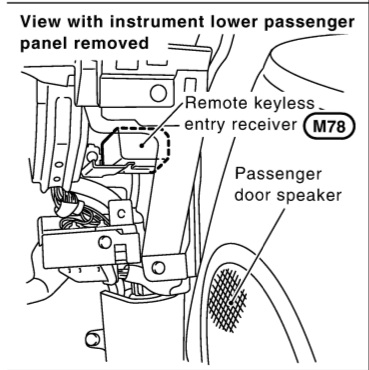

The receiver is near the same spot as the I-Key unit. Manual shows this:

ok awesome, is there any way to visually check for faults on the reciever? Like solder joints? how hard is it to remove the casing?

No idea man, it's probably pretty sealed up. The black boxes aren't built to be serviced, just swapped out.
But seriously, look at those fuses before you do anything.
