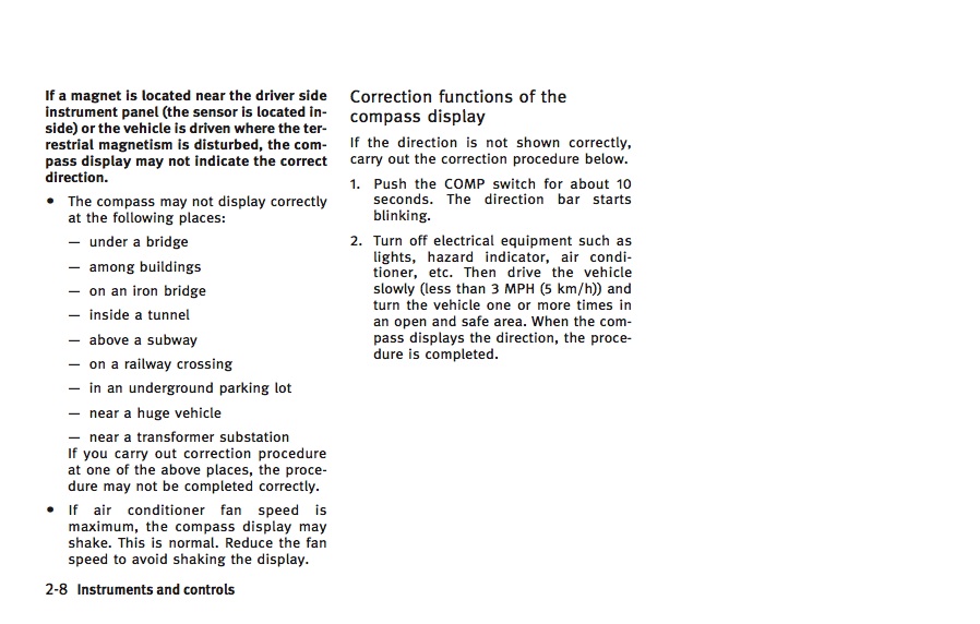

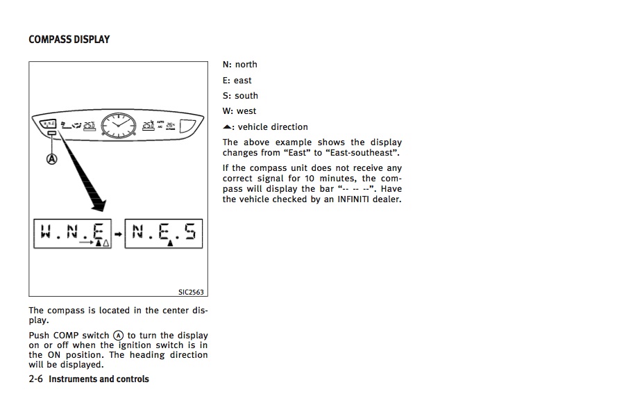

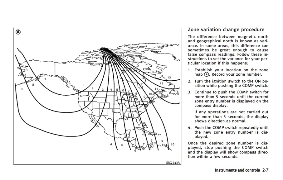

I bought a used 2003 G35 Rally Edition and it had no owners manual in it the compass is not set and I don't know how to do it. If anyone knows how to do this could you please e-mail me at tkloop@hotmail.com and explain it to me I would greatly appreciate the instructions on this.

If it's the same rig as '05, '06, here are the relevant pages:
Attached Thumbnails Setting The Compass ?-2-6.jpg   Setting The Compass ?-2-7.jpg   Setting The Compass ?-2-8.jpg
