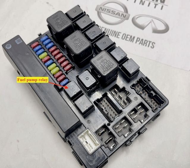

Ah, your original got wet, understood. I'm pretty sure you can swap individual relays in and out of these IPDMs so what about replacing the bad fuel pump relay in the 1st IPDM you tried? Did other things work ok with that one? Maybe you can build one good IPDM out of the 3(?) that you have now. Just an idea.
If your fuse #75 is blown your rear lamps (parking lights) and side markers should not still be working. There shouldn't be any power running through that relay and energizing that circuit so that's a bizarre result. Turn signals and stop lamps are different circuits.

Well that relay isn't interchangeable its inside the IPDM, I can post pictures when Im home, but its wired to a circuit board and you cant really change them without breaking the IPDM, and I'll write it out clearly I know I'm being a mess.

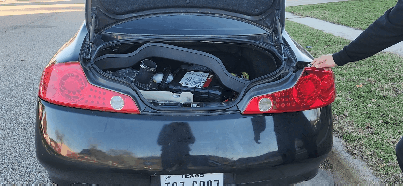

Okay so I found this. Once i fixed this wire Im back to my original issue
This is my original issue. When I turn the right blinker it bleeds over. However if i put that wire back and tighten down the tail light it doesnt bleed i just lose my running tail lights
