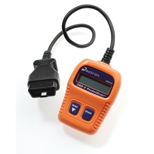

This is what I use, erase my p1284 code weekly.
~$50, make sure to get the one that handles can protocol.
niice, where did you buy that?
Old Sep 13, 2007 | 09:09 PM
ma_sha1's Avatar
Joined: Mar 2005
Posts: 824
Ebay or Amazon.com, forgot which place.
