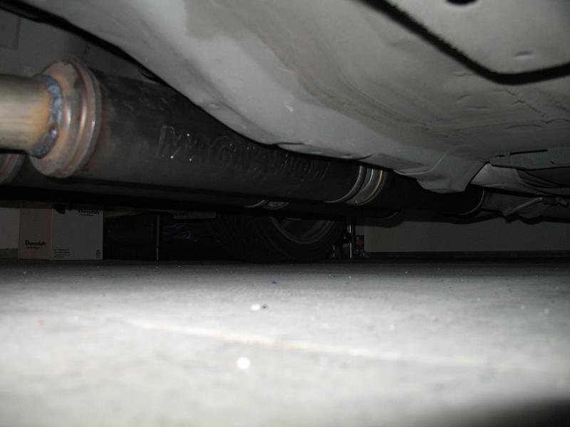

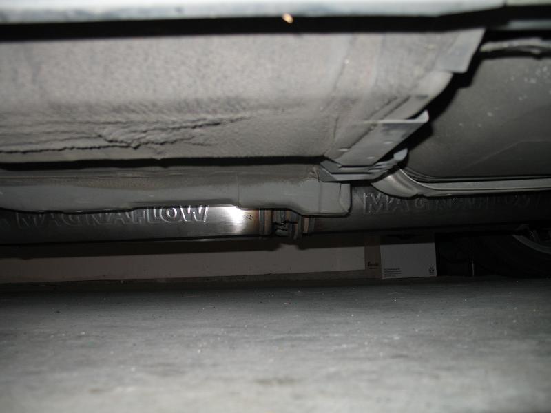

Cool. Just make sure when they weld them in that they leave enough room for more if you ever want to get quieter. I got 2 18" back to back and it is quiet, smooth POWER.
Attached Thumbnails New resonators...-magna2.jpg   New resonators...-magna7.jpg

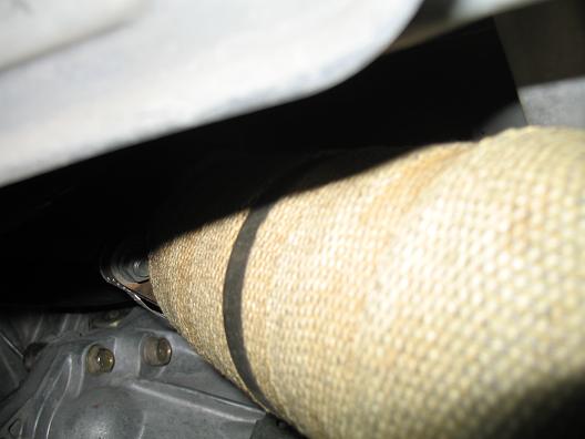

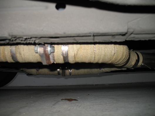

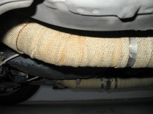

I noticed the same thing. It will tone down a bit more over time, but the 3-3.3K "Rasp" will be there with testpipes or HFC. All you can do is minimize it. Another thing that really helps is to thermal wrap the tubing after the actual catalyst section of the HFC and then all the way to the X-pipe. Wrap it really tight to dampen the ringing/resonance of the pipe as the gas flows. Kind of time consuming to do, but it made a big difference on mine.
Attached Thumbnails New resonators...-wrap1.jpg   New resonators...-wrap2.jpg   New resonators...-wrap3.jpg

Any autoparts store that sells some level of aftermarket performance should have header wrap. I used the Thermotec 2" wide. No issues with heat buildup, but don't wrap the actual (larger dia.) catalyst section as it needs to dissipate much more than the regular piping sections.
The rasp that you're hearing is resonance "ringing" of the tubing from the exhaust pulses. Stillen uses a very hard, high grade stainless that can ring like a bell or tuning fork at certain RPM. What you are doing by wrapping it, is damping the amplitude of the resonance. Think what would happen if you wrapped a chuch bell with a blanket. It wouldn't ring as loud would it? Same thing here and with the rubberized speaker damping in doors. Just make sure it is wrapped tight or all you are doing is muffling it, not actually damping.
