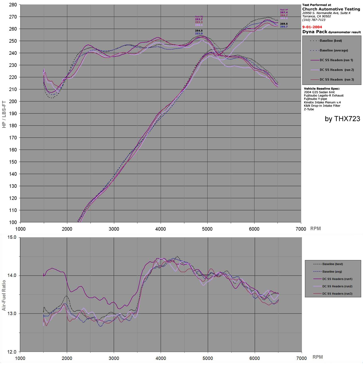

The pre/post dyno plot complete w. AF, as promised.
As you'll see, the pre/post curves were more or less the same, which was unfortunate but also a relief. Again the lost and gain between 2500 - 4500 gave the sensation the headers are really doing it's thing. Not the case really.
AF retune was not performed because, as you can see, it narely even budged. You can dismiss the one anomally for the 1st half of DC run #1. ECU was lethargic transitioning from closed- to open-loop operation.
An ECU retune was eventually emposed to combat the funky AF hike @ 4000rpm, a trait that was observed on many stock G35 and 350Z. No appreciable power increase were noted after the retune.
Tony @ Motordyne have also dyno'd his DC Sports based Top Speed headers (I believe). It was not entirely shocking when his curves turned out to be a mirror image of mine, exhibiting the same lost and gains. Overall, no gain for him either.
Sloppymax,
I can't comment on the Hot Shot headers. It is plausible they are not based on the same DC Sports design, that so many companies seemed to have ripped. If your AF did change significantly then that's far more encouraging than mine.

yes, under hood temp did take a hike from the now missing heat shields. I double insulated my clutch line just in case. What I really need is to fab a set of custom heat shields. However, after countless of track events ... I have yet observed any ill effects. *knock on wood*

THX723, thanks for the info/review.
One of the reasons I think im going with the Strup SS headers is because of my doubts about any performance gains, unless its crawfords headers. Taking a risk on a cheaper product makes me feel better, rather than spending 200 more for the DC sports SS headers.
Anyhow, these headers would be beneficial for my future goal, which is a Vortech SC.
I'm hoping I have better luck with NA header power; the cipher logs will tell alot when the time comes.

You're quite welcome skater!
I wish you the best and let us know how they work out.
As mentioned above, I'm really not expecting the Stupp unit to perform any different than the DC Sports design it was based on.
Perhaps by adding Vortech to the equation will the increase in flow finally deem these headers worthwhile. If I were you, I'd holding off until you have the Vortech installed then peform a proper pre/post header analysis.

Headers will do little good without a reflash or other fuel mix tweak. I was in the low-mid 14's after header install and the ECU was trimming timing due to detected knock I couldn't even hear, but showed up on the dyno datalog. After reflash by Technosquare, it was right on the money at 13.2 and the power difference was about 9 HP and 11 TQ. I will post the dyno sheets if I can find the CD (been over a year ago).
Bottom line? Don't expect much after just bolting some headers on, maybe even see a loss due to lean/timing pull. The ECU is very narrow minded and cannot deal with flow outside a set range. But clearly there was room for flow improvement on the manifolds since the '07HR uses basically an OEM header.

ballisticus,
The notion of ECU retune for optimize gain is well accepted. It's the right thing to do.
However, your gains from Technosquare ECU flash more than touched up on just the AF. Included in the reflash are a slew of tweaks including ignition timing. All of which have been shown to gains ~10hp on a bone stock car (read that as no headers involved). So the question to ask yourself is, of the 9hp you have gained what part of that was from the headers or simply the ECU tweak?
The point is unless you have performed an ECU reset prior to your baseline dyno, it is simply all too likely you have got yourself a "false low" as baseline. Please read here to get a whiff of what all the fuss is about regarding ECU reset before Dyno runs.
Fact is I have also addressed the AF and only the AF after all my mods. There was no appreciable gain from the practice. We're not dealing with Force Inductions where AF lays a greater role on allowable timing advance and lots of power to be unlocked.
