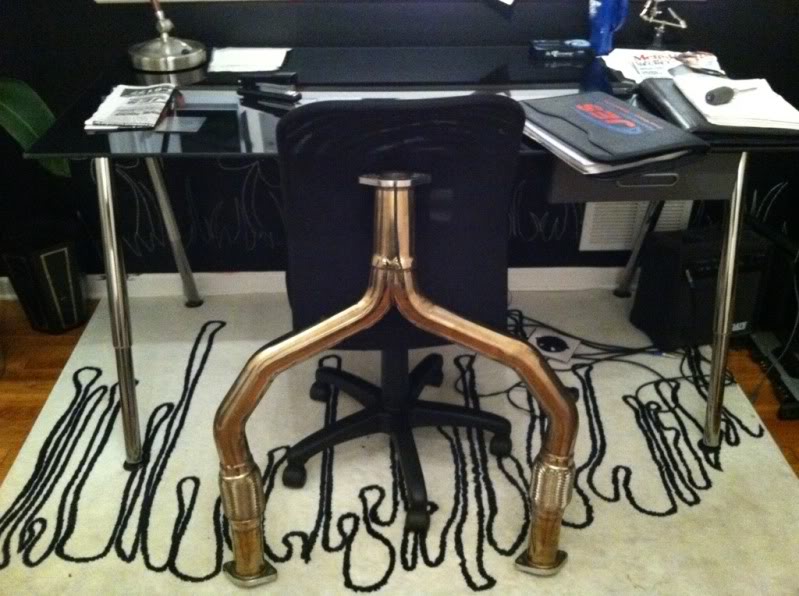

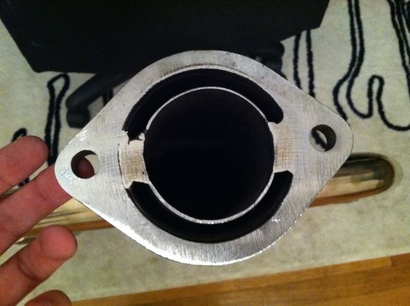

So I am a bit of a stubborn person. I refused to think I would have to deal with rasp when adding test pipes to a stock exhaust, so I started thinking for a solution. I went with ehh quality Megan resonated test pipes and a M2 HR design Y pipe that is 2.5" merging to 3". Oh boy did it sound nice under very light load, but 1/3 throttle and beyond was rasp city. I immediately removed it and put the stock DE Y pipe on. Rasp was reduced but still there, obviously from the 2.5" test pipe hitting the 2.25" stock y pipe flange. Also the non HR design merge point made the tone not as sexy. So what to do, what to do??? I had my friend fabricate a 8" gradual reducer inside the 3" merge of the HR y pipe to a 2.5" end.
Here are the pics.

So now I have a 2.5" all the way through exhaust!!!!!!!

So why all this trouble? Well I drive 3-4k miles a month, I want no drone/audible hwy exhaust, no cop attention, and I am supercharging the motor so squeezing every N/A hp out is not my goal.
>>>>Fabricator said if this works well he will weld a 1/4" flange with the reducer on it, so people can slip this into their existing 3" y pipe on a stock exhaust it is a very tight snug that requires the last 1.5" to be hammered in.<<<<<<
