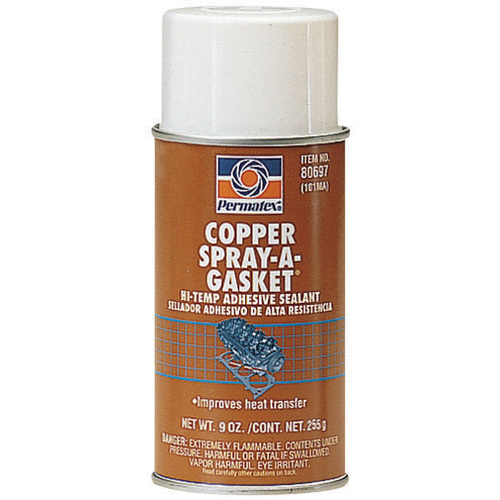

Should be a flat multilayer metal gasket if I remember correctly... Here is a link and IPB. Item 9, rear muffler gasket. $8.08
http://www.infinitipartsusa.com/2006...tm?searching=Y
You could also pick a gasket up at your local auto parts store, or try flipping the old and spraying it with high temp copper gasket spray and torquing to spec and see if that does the trick.
Hope this helps!

Thanks alote man. Much apprciated
