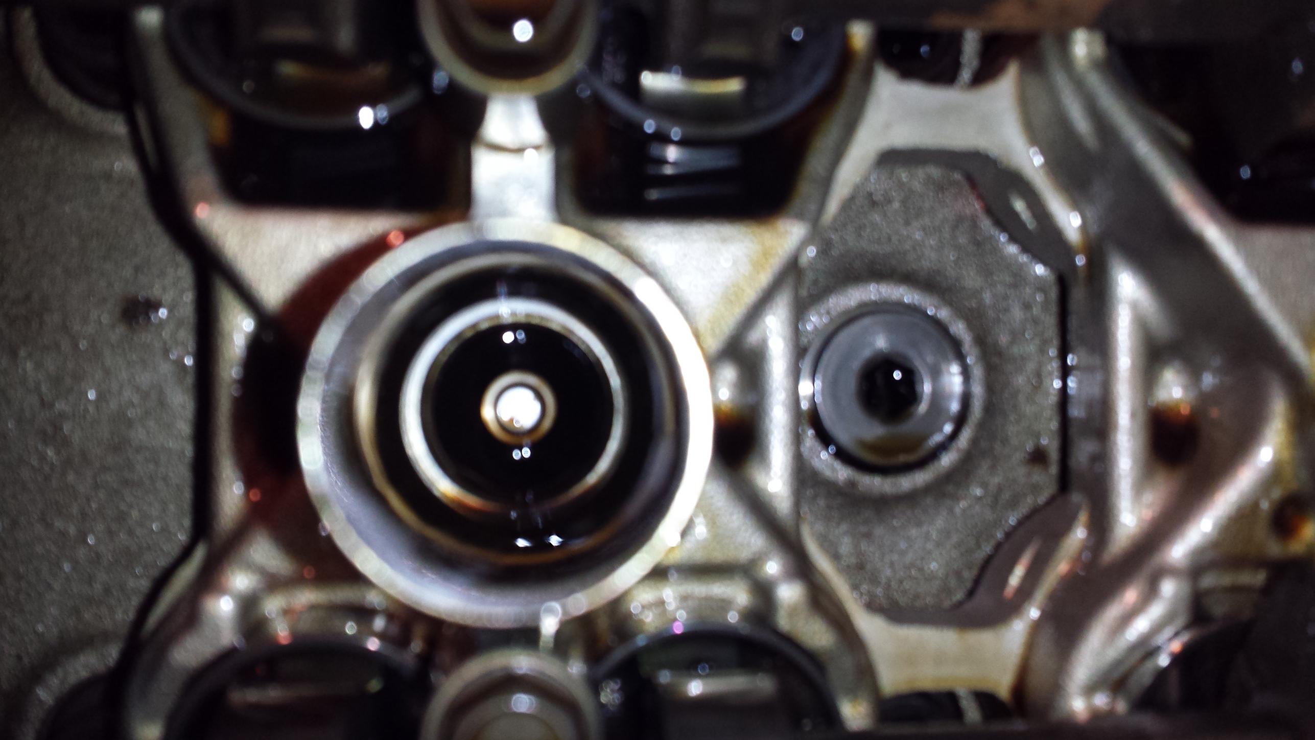

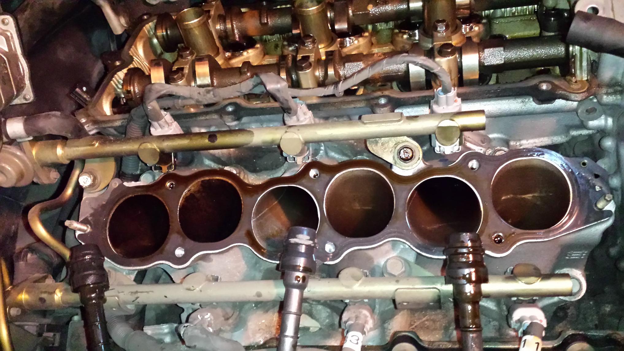

So yesterday I worked on my car..sorta.. and while removing everything the last 2 far intake were really dirty with oil. And also the 1st, and last coil pack driver side had oil I'm them? The car does misfire a tiny bit. Idk if could be cause of the valve tick it has or coil pack not making contact cause of the oil. I tried cleaning some of it off...
Here are some pics.
Attached Thumbnails oil in intake and coil packs?  help-20140310_201011.jpg   oil in intake and coil packs?  help-20140310_201056.jpg

Common problem. Need to replace your valve covers since the seals are moulded in and can't be replaced alone.
Thanks buddy I was a lil worried
