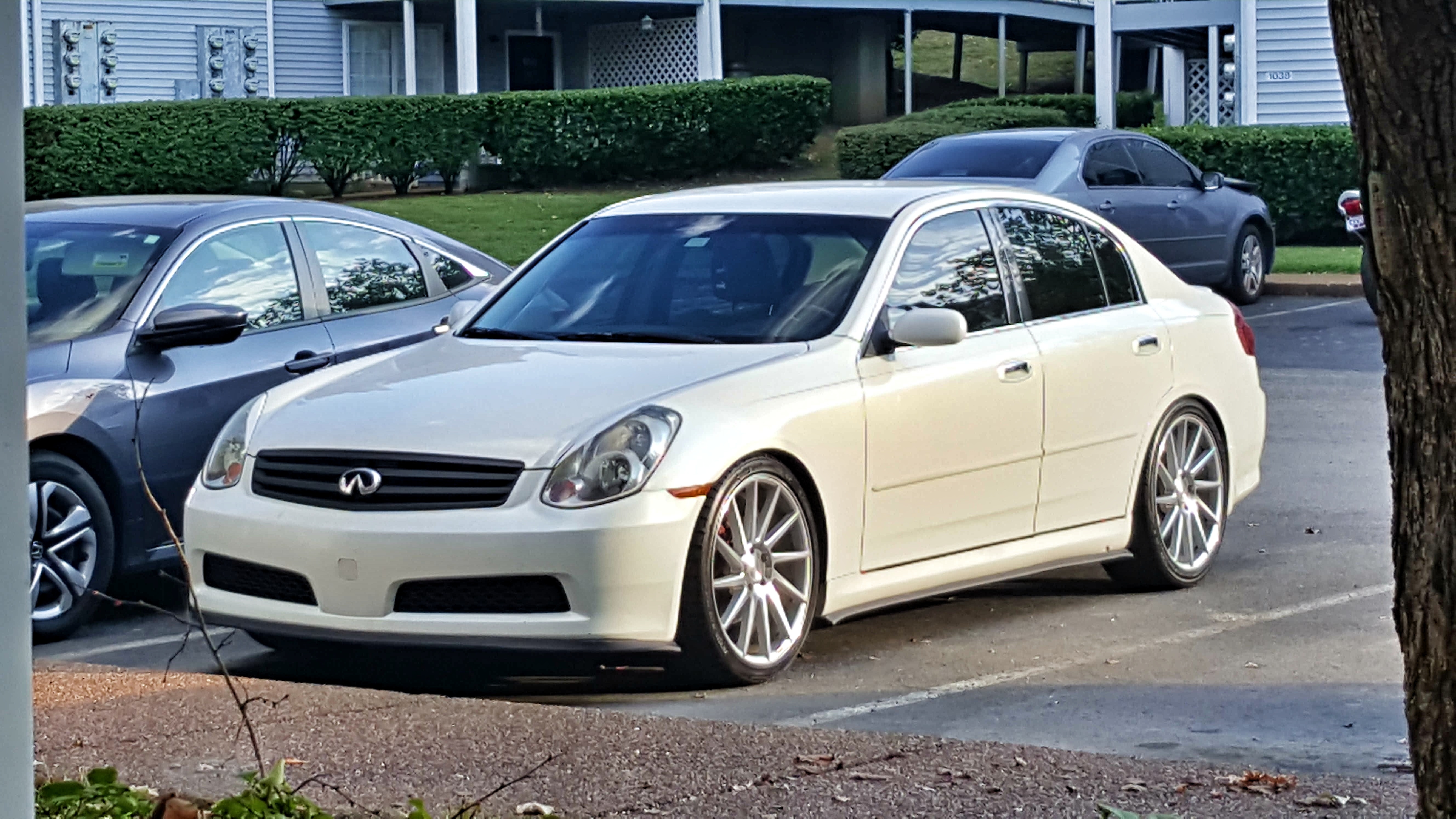

Hey guys I have an 06 G35 sedan 5AT and I'm looking to buy a muffler or possibly a resonator. A new exhaust system or even just one of the components i.e. y pipe, test pipes, hfc's, etc. is out of the budget. I looked at installing a coupe mid pipe but it's too big to have it shipped and there aren't really any local ones for sale.
1. I'm looking for no drone.
2. I'm looking to have a slightlty deeper/throatier sound without it being very loud.
Do you guys recommend the thrush muffler 17655, a flowmaster muffler, or a vibrant resonator? I know there's the magnaflow muffler but $227 for a muffler just doesnt sit well with me.
Thx.
