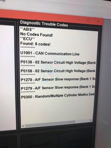

So I bought the car in December, its an '03 g35 coupe. I rented a uhaul truck and trailer because the car was 3 hours away. Backstory from previous owner was that he couldn't pass inspection and had bought an sti so the car had been parked for several months. Over the course of owning the car, I kept it in my parking lot and fixed a bunch of cosmetic things (bumpers, not working sunroof, oil leak). Last week i finally registered the car and took it out for a spin. Car has a slight misfire once its reaching operating temp. The first day i drove i can feel a misfire/bog from 1-3k rpm's. After that, car would pull fine. I thought it was bad gas since the car sat for so long and the tank was on E. I filled up tank and drove it some more. After driving it the second day it didnt bog but it felt like the car would misfire at idle. I pulled the codes and this is what i go after driving just two days in a row:
-P1148:
closed loop bank 1
-P0300:
Random-multiple misfire detected
-P0138:
Oxygen sensor circuit high voltage bank 1 sensor 2
-P0158:
Oxygen sensor circuit high voltage bank 2 sensor 2
-P1276:
Air fuel sensor 1 heater bank 1
-P0158:
the rest are the codes mentioned above but PENDING.. I did change the oil and spark plugs prior to registering the car. From what i can see the previous owner deleted the cats and car also has an intake. I ordered some ARK high flow cats and pray the car will read the air fuel better. Any suggestions??

OK so I replaced the Bank 1 sensor 1 and cleared the CEL. Drove the car and its still sputtering really bad between 1k-3k RPM, after that it pulls super smooth and hard. I searched around and read that the PCV valve may cause this so i replaced the valve. Drove the car after replacing it and it ran beautiful for about 5 minutes and back to the terrible idle and bad hesitation and sputtering. The 02 sensor i put in and the PCV valve i purchased from the dealer.
Also while it was idling rough, i pulled each coil and they all seem to be fine (rough idle got worse every time i pulled the plug). Did the same with MAF sensor, seems to be good. I also reset the idle right after i replaced the PCV valve, and like i said, car idled beautiful and was accelerating just fine for about 5 minutes. Now I'm back to square one. When i parked the car, check engine light came back on so i ran the codes. Now instead of 11, I'm down to 6 codes.
-P0138
Bank 1 Sensor 2 CONFIRMED
-P0158
Bank 2 Sensor 2 CONFIRMED
-P0138
PENDING
-P0158
PENDING
-P1278
Air fuel Sensor 1 Heater Bank 1
PENDING
-P1279
PENDING
I'm not sure why I'm getting the Sensor 1 heater bank 1 code since i replaced the 02 sensor and inspected the wires and everything looks fine. The random misfire code did not come back but the sputter is terrible, just as bad as a misfire. Also, for the bank 1 and bank 2 sensor 2, i ordered high flow cats, I'm hoping that fixes those two codes. If anyone can point me on the right direction for this hesitation and terrible idle please let me know. Really appreciate it!!

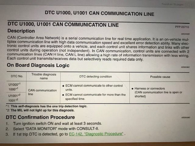

UPDATE:
So i sourced a good harness and installed it on the car. Car still has the same exact symptoms. and the same codes came back up. I am leaning towards the ECM now.
Now, before I wasn't getting the U1000 code only the U1001. So Im assuming because the previous harness was hacked, maybe it fried or shorted something out on the ECM.
According to the FSM it says it's either the connector or harness, but harness has been replaced. Also, all those 02 sensor codes are not the sensors since i put new sensors.
The FSM also directs to do the following troubleshooting...
I've done the idle relearn and nothing. I also replaced the CMP which is the cam sensors (replaced both driver and passenger). The CKP i haven't replaced, but as you can see it suggests to replace ECM. I'll try that out and hopefully that does it.
