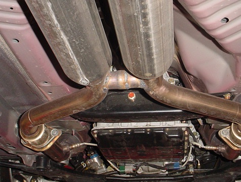

Shawn,
You might want to consider installing a H-pipe to balance out the Injen's true dual flow. When I installed mine, it improved the sound (deeper) and felt a little better low end torque. I agree with your review 100%. My experience with my Injen was very similar.

Here's an old pic of the Injen SES, H pipe and Magnaflow resonator pipes. I went back to a Tanabe Y pipe and oem muffler.
