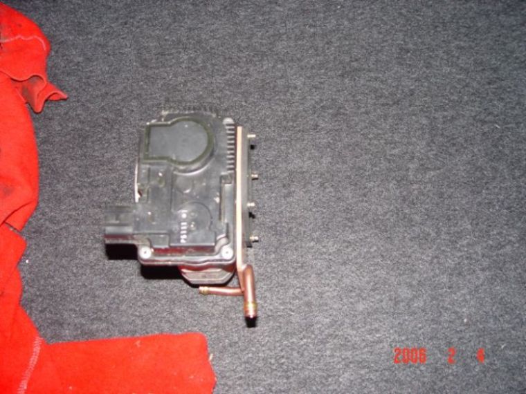

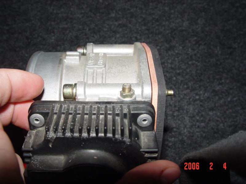

Originally Posted by Hydrazine
Longer or new bolts arent needed for the TB. You should be able to use the stock ones easily.
Tony
There are only 2-3 threads visible without even installing the last gasket. Here are some pictures of what I mean. I wouldn't trust 2 threads to hold the throttle body on. You almost need bolts as long as the four bolts you supply to hold the upper plenum down.
Rylan
Attached Thumbnails MREV Installed-throttle-body.jpg   MREV Installed-throttle-body2.jpg
Rylan
Ever wonder why a nut is only so thick???? There comes a point when you max a max. force of holding power, to put it in common terms. You'll be fine with the amount of threads you have, but if you feel better by buying longer ones........ do it. It's your piece of mind. My $.02
Rylan
Hi Rylan,
Yes, you are right. They do look short. I don't know why, but I have noticed that Nissan will sometimes use slightly different parts in their production. Bolts diameters, hose lengths/diameters, harness lengths, brackets, machining processes, gaskets, torq ratings and other various things. Its not always exactly the same every time.
It looks like your bolts are about 5mm shorter than what I usually see.
Hi Rylan,
We just went and bought longer bolts to snug up the throttle body then installed the original bolts with lock washer. Without the longer bolts it may have been tough to get in, but who knows. It all worked out in the end.
