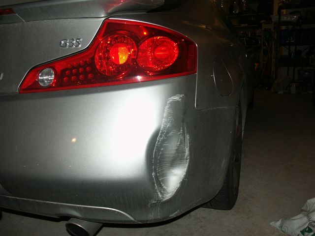

Just wondering if I need more than a new bumper fascia assembly. Since the damage is on the corner I am hoping that the components under the cover are not damaged (e.g. energy absorber and/or bumper reinforcement).

That big suckerpunch dent can be removed, but your bumper will have to be re-sprayed. Dont dish out for a new bumper, this 1 can be fixed...

try heating it up and pushing it out

easy fix pop out the dent with hair dryer or heat gun do minor body work if there are deep scratches or a crease prime then repaint

Thanks for the advice. I guess I have to remove the bumper, heat it, and push out the dent?

How much did your repair cost you? I have checked the damage and it is limited to 'just' the bumper cover. I am planning on removing and repairing it myself. I'll have it professionally painted and then I will re-install it. One shop gave me a quote of $930 for them to do everything - ouch again!

ya it's unbeliveable how much it cost to just repair the dent....it cost me about $800CND at Macco...can't remember the name...but something like that, they sure did a great job. just the difference of new paint and old paint... ya i believe if you just take the bumper to them should be cheaper.

wow that is a steap price it should be about 200 - 300 buck done
