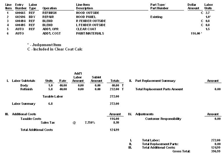

OK Here's the breakdown
Desc...............................Labor.......Pai nt
RPR Hood..........................3.0 .........2.8
Add for clear....................................1.1
Blnd RT Fender.................................1.0
Blnd LT Fender.................................1.0
R&I RT Fender Liner Front.....0.3
R&I LT Fender Liner Front.....0.3
R&I RT Fender Liner Rear......0.3
Tot..................................4.2.........5 .9
Totals
Parts=0
Body labor 4.2@40=$168
Paint Labor 5.9@40=$236
Paint Supplies 5.9@20=$118
Sub $522
Tax 8.26
Total $530.26

I just looked at the other estimate.
They quoted 4.2 hours just to spray the hood
They quoted 3.4 to remove my bumper, replace it, the energey absorbers the grill, emblem and headlights, reassemble, paint, finish, and aim the headlights. They're off their rocker....

Two thoughts:
1) Why does he have 3 hours of repair on the hood? That's the time quote for a medium-sized dent.
2) R/I on the fender liners is bogus, as if he is replacing your bumper they will already be off.
If you take off the 3hr repair, plus 1.2hr R/I costs, you're looking to shave about $170 off.
If your car is black, the blend isn't necessary, as well. Total quote would be ~$250.
G

That looks almost exactly like my writeup. They rated me at $45 n hr, but the came down.

My sled is desert platinum.
There are two scratches on the hood. No dents / dings / etc

Look better...? I threw in an hour of repair just for general cleanup and/or tiny dings they may look at.
G
