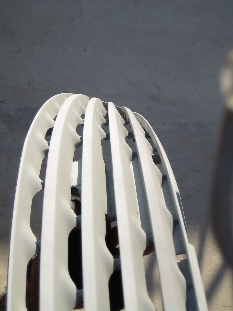

ahh so i finally got around to gettin mine done total work time over a 3 day span 4 hours of work time and this is what i got done so far
http://i29.photobucket.com/albums/c2...1/IMG_2489.jpg

wow, that looks great man! good job!

thanks, im currently working on a way to copy the bumps so i can put them to fallow the line of the rest of the grill 2 attempts fail....haha but ill keep trying

the best way to do it is to make a mold of one of the bumps then cast a few copies out of bondo/resin/glue. honestly though, after making the bumps for mine, they really aren't visible at most angles anyway. either way, best of luck to you man - grill looks great!

how did u make the mold for them? and thanks by the way
no mold - just formed them with layers of epoxy then topped them with a layer of bondo so i could get them smoother. it was certainly not easy nor is it the way i'd recommend others to do it.

thanks candlestick, ya...sounds kinda hard im gonna try something different see if i cant make a mold out of something who knows might come up with something great :-) haha

oo and bigc, did u cut out the back of the grill where the emblem was or did u just leave it as is....like so u could see through the whole grill...ya know...?

PM zackt69 about the bumps - he's making molds to patch the holes and may have some ideas about making molds for the bumps.
i didn't cut out the back of the grill at first, but quickly realized it would make life a lot easier (i should have taken Lawrence's advice). its much easier to sand down the back parts of the patch if the back is gone, plus it will be visible unless you paint it black.

ya i was thinking of going that route, but then i was also thinking of painting it ip too....but im not sure yet...

if you paint it IP, definitely cut out the back. paint the back parts black at the very least - i promise you that it will drive you crazy otherwise
