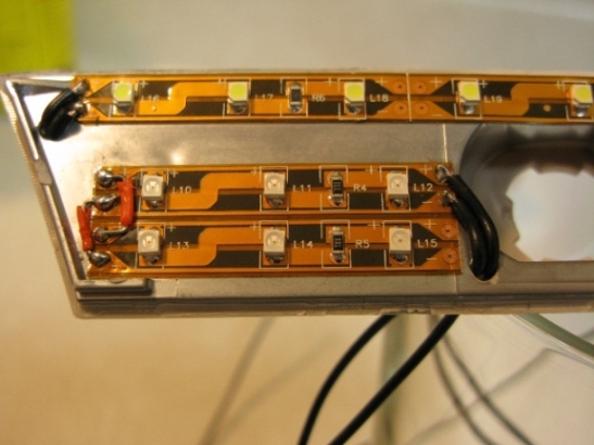

2. Prep and cut the notch - You'll need to make a small notch in the bulb shield for the white strip to bypass. After that clean the entire silver surface to be free from oil. I used Windex and just wipe gently. Cut the white strip (6 inch mark) and 45-degree the corners but don't cut the pads. Mount the white strip so it's INSIDE the edge. You don't want to interfere with the glue edge when putting it back on. The glue edge is not a perfect straight line so be cautious of this.
3. Amber LEDs - Clean the rest of the back piece where you will mount the amber leds. Cut the amber led's into (2) 2 inch sections. You'll have 6 leds as the 'blinker' portion of the light. I mounted the 2 strips on top of each other but below center so when the light was on the light would be coming from the center of the lens and not all out of the top.
4. Make Connections For each light youll need 4 pieces of wire. 3 pieces can be 8 inches long and 1 piece will be 16 inches long. The long wire is for the positive part of the blinker. Drill 2 holes in the back piece for the wires to go through, run your wires through and make the connections. Be cautious of the stiffness of your wire. If you dont prebend the wire you run the risk of the wire pulling up on the led strip and un-sticking it. I made sure there was no load on the strip before soldering. Solder all wires and ensure the long wire is to the positive of the white (top) strip. You will also need 2 small jumpers for the amber leds. Plus to plus and minus to minus. Ensure that you MARK THE WIRES after exiting them out the back. Once you rtv the holes you may have a hard time figuring out which is which but dont do this yet.

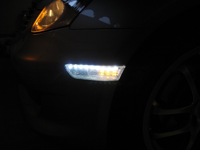

- Connect the amber-led positive (long wire) to the green-yellow blinker wire.
- Connect the white-led positive to the red (positive) side marker light. This is your constant on (running light.)
- Connect the white-led ground to the side marker ground (black wire.)
- Connect the amber-led ground to the white-led ground or the side marker ground. Turn your lights on and your white will light up. Your blinker will work independently from your running lights. Test all scenarios to be sure theyre working properly.
