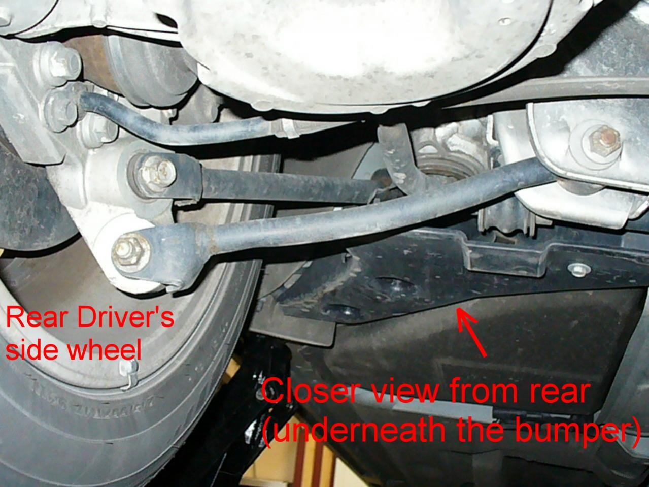

Attached some photos (sorry the bottom of my car is so dirty ya'll, plz don't flame).
First photo was taken from the driver's side, in between th wheel well and rear wheel (car is jacked up on that side). There are two studs that do not have nuts on them and there's a flange that is threaded. The two deep wells of the diffuser slide over the two studs and the hole in the diffuser should line up w/ that flange.

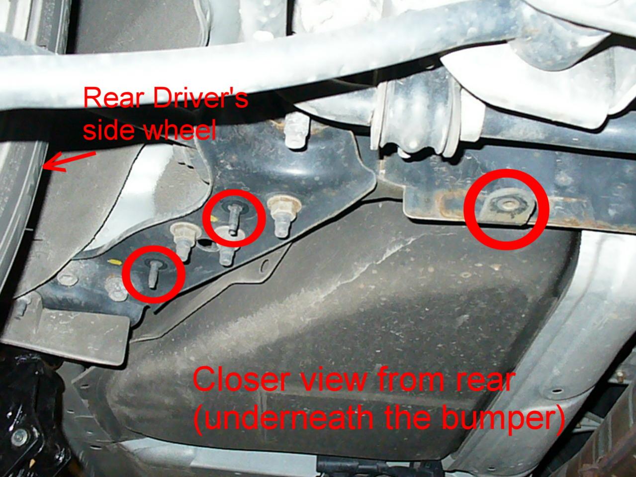

Second photo taken from same side, the arrows indicate the place where those two studs and flange should be under the diffuser.
Third photo taken from rear (right underneath the muffler), so you can see the orientation of rear wheel to where the diffuser mounts.

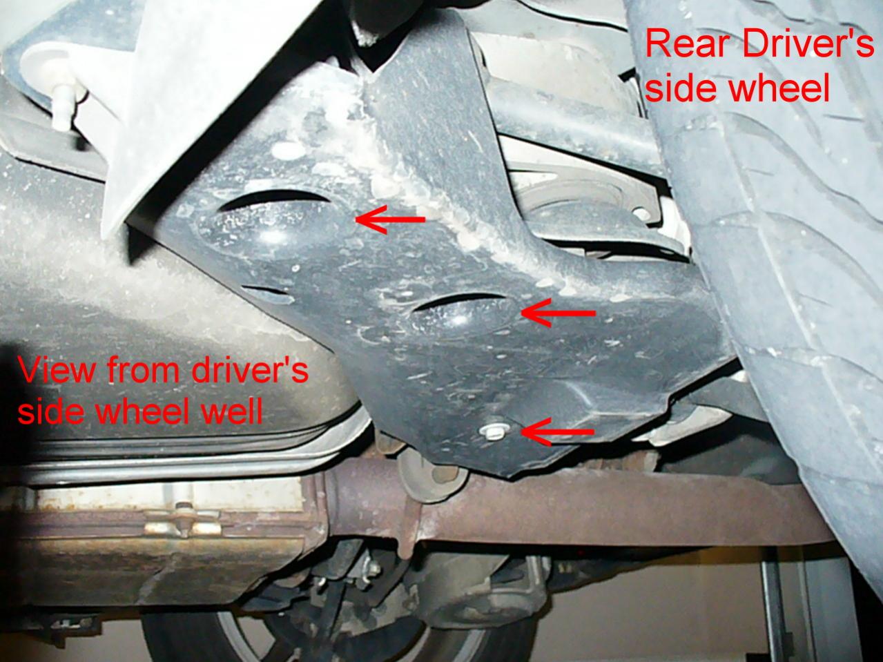

Fourth photo taken a little closer so you can see the diffuser (arrow). See the location of the two deep wells in the diffusers and bolt that screws into flange underneath?

That should take care of your driver's side. Now go do the same for the passenger side!
Good luck!!!
