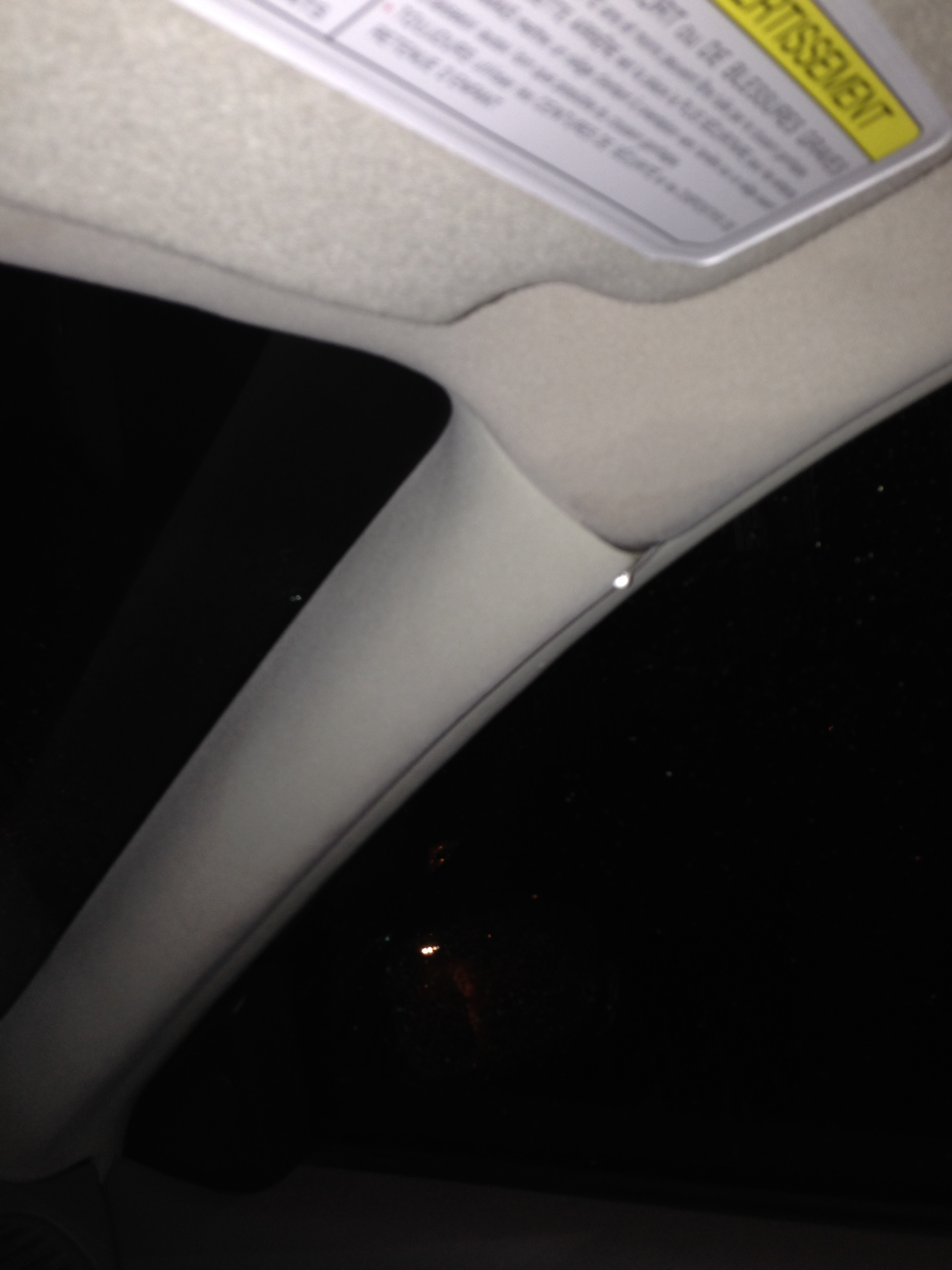

My interior on my 2003 G35 sedan has been leaking water for sometime now, I am not sure where the water is coming from. I've attached a picture. Is this a common problem among G35 owners?
I am thinking it might be coming from the windshield or the moonroof, but would like to get an opinion before I start checking things.

You can probably start by cleaning the sunroof drainage system. My mom's Matrix had an issue with water in the interior floor. She took it to a shop and the just used an air hose to clean out the drainage track in the sunroof. No water ever since.

Agreed, you have a drain plugged for the sunroof. Might have started as a spider's web and got packed full of leaves and dirt.

That was probably it. There was some slight black gunk inside the sunroof well. Took me awhile to find the hole *hehheh* , but after poking around with a small thin branch I was able to find it and clear it out. Now to wait until it rains again to see if it's fixed. Thanks again.
