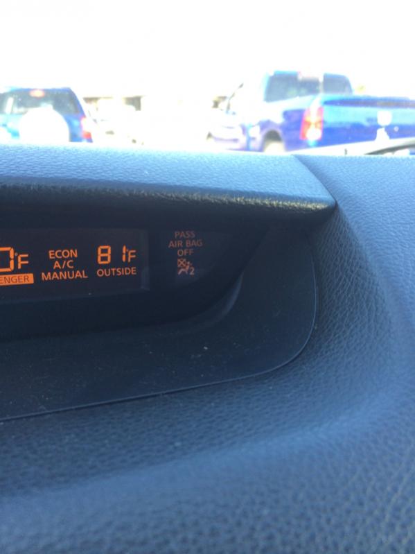

Been getting the passenger airbag-off light coming on lately while my girl sits in the seat. Scary. Anyone had this problem before? Solution?
Attached Thumbnails Pass. Airbag off?!-image-2391686739.jpg   Pass. Airbag off?!-image-188728036.jpg

If I remember right it's either a tsb for this or yo girl is skinny and the car thinks you got a child in front seat and turns it off.

Called Infiniti and the min. Weight is 100, She's 110 so that's not it

She needs to keep her back against the back rest. There is a sensor in the seat and I believe the back plate.

I know theres a weight pad under the bottom cushion. If thats bad Infiniti's only option is to replace the entire cushion. Of course used is an option.
