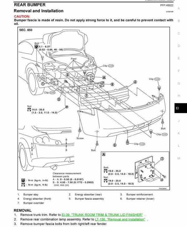

Can anybody that has recently removed their bumper confirm that the reinforcement bar is at the same plain as the rear license plate area? I only ask because I would like to mod the reinforcement bar to accept the tow bolt. Why, you ask. Well I plan to buy a nismo V3 front bumper which deletes the tow bolt cover.

This should be the - in the center of the rear bumper al the way on the right.
Attached Thumbnails Looking for anybody that has Recently removed there rear bumper-image-735347854.jpg

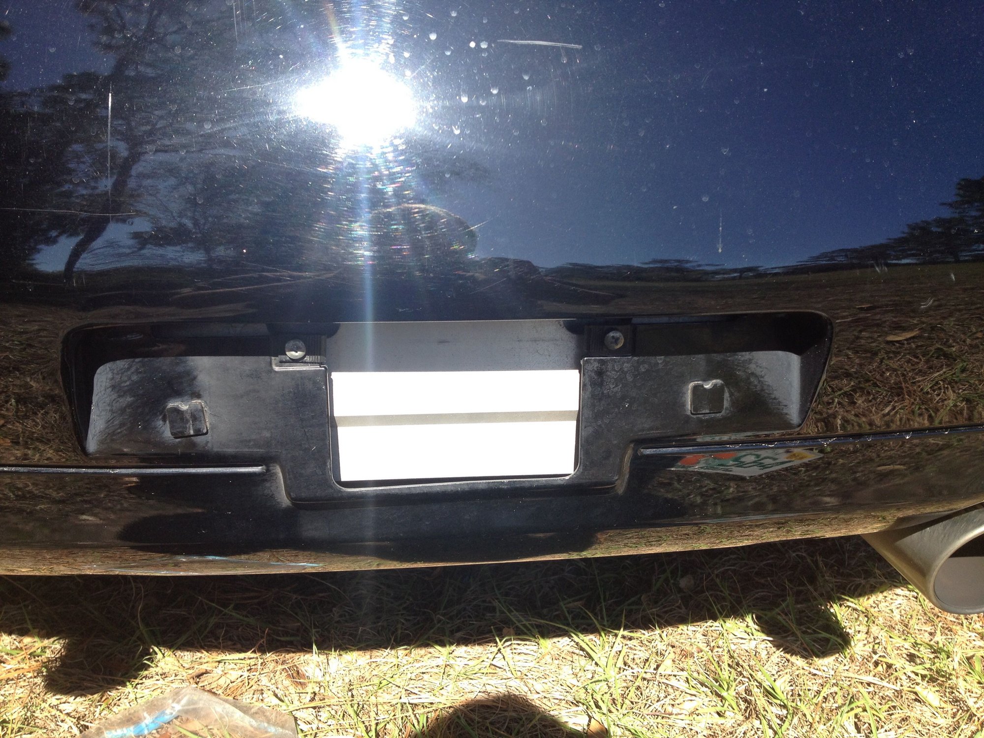

Its like I thought.. The rear reinforcement is right behind the plate. Now it's just a matter of mocking up and idea.
