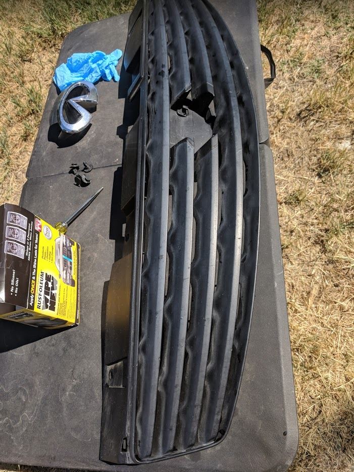

Once again Wipe New exceeds expectations, winter/spring of 2017 I sprayed my grill with a satin black finish. 1.5 years later it had severe oxidation as expected as well as quite a bit of water spots that don't come out in the weekly wash. I STRONGLY recommend removing the grill since it takes about 30 seconds and I've learned from experience that you do NOT want to get Wipe New on adjacent surfaces because it's hell to remove. Also be very careful with the emblem if you have it painted black as well, I don't know how this product behaves when applied to a plastic chromed finish but it would probably just make it a little hazy if anything.
It's pretty obvious which are the before and after pictures.
Wear gloves...
Only use this stuff in a WELL VENTILATED AREA, preferrably outdoors in the shade. If you apply this indoors use a proper respirator because it's incredibly powerful ****.
As stated numerous times on the bottle/instructions, "a little goes a loooooong way".
Ignore how filthy the rest of my car is, I didn't have time to wash this weekend so it's covered in highway bugs and splatter. Also ignore all the chips in the paint on my grill, it's the price you pay for being a daily driver
I'm sure that Wipe New would turn your matte black into a satin black, probably not enough shine to be considered gloss though.

I did put the grill in a wash sink and scrub it with a brush to get all the bugs and other crusty crap off it, that's all the only prep I did though.

Wowwww! That came out great!!!! I'm definitely doing this next weekend. Thanks Cleric!

Yeah and it will probably last a year as well, I was initially just going to repaint the grill but then I have to go get paint, clean the gun out when I'm done, etc... this was easy and I wanted to see if it would work
