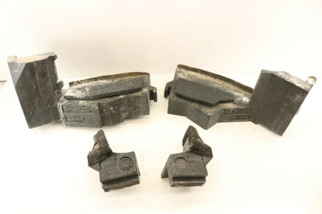

Hi All,
I was installing new head lights on the G35 coupe and I notice that the previous owner had remove just about all of the Foam Impact Absorbers from the car.
So I have gone out and purchased replacements but I am not clear where the two large left and right units go. Please see picture
Just in case the link does not work
I know where the little ones go but I am not sure about the taller left and right units.
I also have the larger full space impact absorber that covers the metal reinforcer
I have looked at the EI service manuals from Infiniti /Nissan and no go.
They show the parts in the exploded diagram but not how they are installed.
If anyone knows I would be very grateful for that information.
Many Thanks!

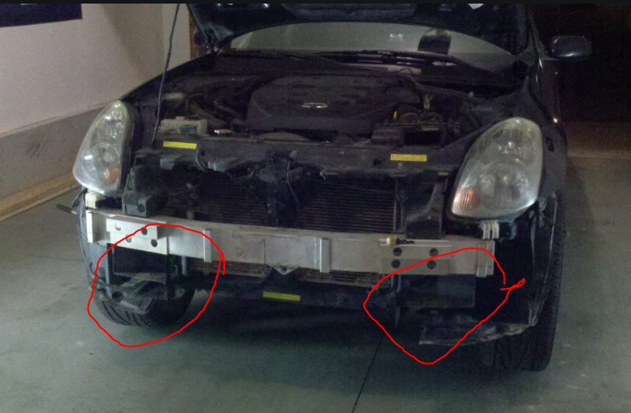

There are two off color plastic 'L' shaped guards that sit under the headlights/bumper. The foam pieces slide onto them.

Heres another pic showing em. U could use some double-sided tape to stick them on.

Got it!! Thanks so much!!
