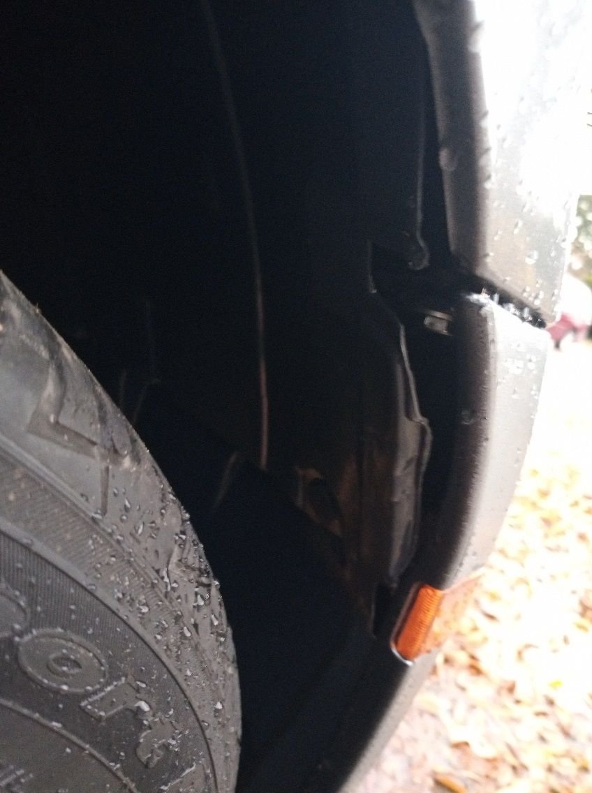

My car came with a Karuma Z bumper in bad shape, missing front fender liner sections, and missing front splash shield under the engine. I went on the internet and found the cheapest OEM-style replacements I could on Ebay, did a quick 4 coat rattle can job on the bumper, and put it on the car.
The bumper was only 140 bucks, and the fender liners were 35 bucks for both. It took around 4 hours just to get the 3 pieces onto the car. The fender liner holes didn't line up with the bumper (not sure if it would line up with a real OEM bumper), so I did a lot of prying and tugging to stretch it into place. The notches where the fender screws go were in completely the wrong spot so I have a smidge of plastic fender liner poking out under the wheel arches. I might trim the liners so they fit better, and I might try stretching them out with a heat gun so they fit better.
The bumper cover itself doesn't fit the corners of the quarter panel and headlights, though there could be an issue with the fitment of those pieces on my car to begin with. It's a little hard to tell from the pictures, but they're jammed against the corner of the metal (with gouges to show for it) and poke out by around 2mm. Good news is, it did fit the grille and mounting tabs in the engine bay okay.
