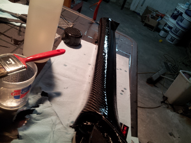

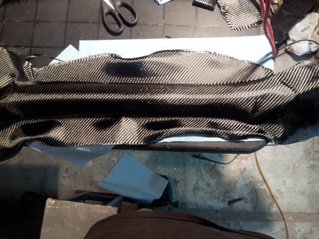

So I finally decided to take a bit of a leap and try some carbon fiber. never having done body work in any capacity, or doing any CF before, I was/am leary.
However, with some helpful advice from a couple members on other forums, I clamped down and tried an A-Pillar after doing some small test pieces to try some different techniques.
I won't get into all the specifics but used Clear Adhesive spray, sprayed on the carbon. Sanded and Painted the A-Pillar black first (the beige will show through if you don't paint it).
Once rough fitted I applied the Resin to just the top surface, once cured, Trimmed the edge roughly and put a second coat on.
---If anyone has done CF work and has any tips/advice, or would like some advice from my limited experience, please comment/PM!!
Comparo with the first coat on
Second coat JUST freshly applied and edges trimmed a little closer
And I made this also, this is the primary reason I wanted to try CF, I would like to wrap this Custom Gauge trim piece I made if I get good/balsy enough

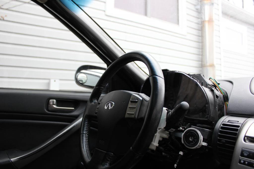

Aiiiiight. So the A-Pillar is done. Aside from a few minor things that I have trouble even finding once installed, it turned out great! Thanks again to all those who helped me learn on this.
There is one issue, and it's kind of a big one, but it's not with the finished product.......
.....It's that I'm not sure I like it.
Sure, it looks cool, but it might be too much gloss/flashiness for me for an interior component.
From the passenger view it's pretty dope, it's the transition from the A-Pillar to the Dash that is so drastic, and this is only seen from the driver position (me).....
Anyways, I'll let this one stew for a bit before I touch any other CF work on the interior. Picture bomb time:

And this shot shows the fairly drastic transition to the Dash that I was talking about:
Old Nov 25, 2012 | 10:09 AM
  #126
PAIXAO's Avatar
Joined: Sep 2008
Posts: 8,338
Likes: 445
From: The Commonwealth
That looks really good! I'm with you on the transition though, it would bother me too.
