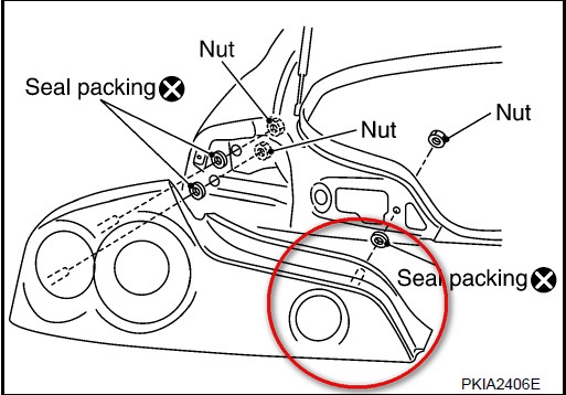

Unhappy Please Help - Unable to find all screws\nuts to remove tail light
Hello Forum,
I have a 2004 G35 Coupe and I want to replace my blown side marker light on the passenger side. I've searched high and low for DIY, PICS, etc on how to remove the tail light. So far I'm able to disconnect the elec. cable and remove 2 nuts to loosen up the right side of the tail light. The tail light still won't slide out as something is still attached on the left side (see attached). I've searched over and over inside my trunk for the screw\nut that's holding the tail light in place, but I can find it all. Can someone please help me locate this?
TIA

I figured it out last week just by looking at it. Had to replace the same bulb. There's like 3-4 nuts your remove, and that's it. Simple.

Can't believe I had to go through all of that to replace the side light. Yes, very simple in the end, but had to remove the taillight to get at it. 2 plastic retaining pins (to get under the liner), 2 nuts to remove the lens assembly. Thanks for the info!
