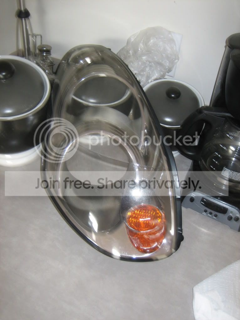

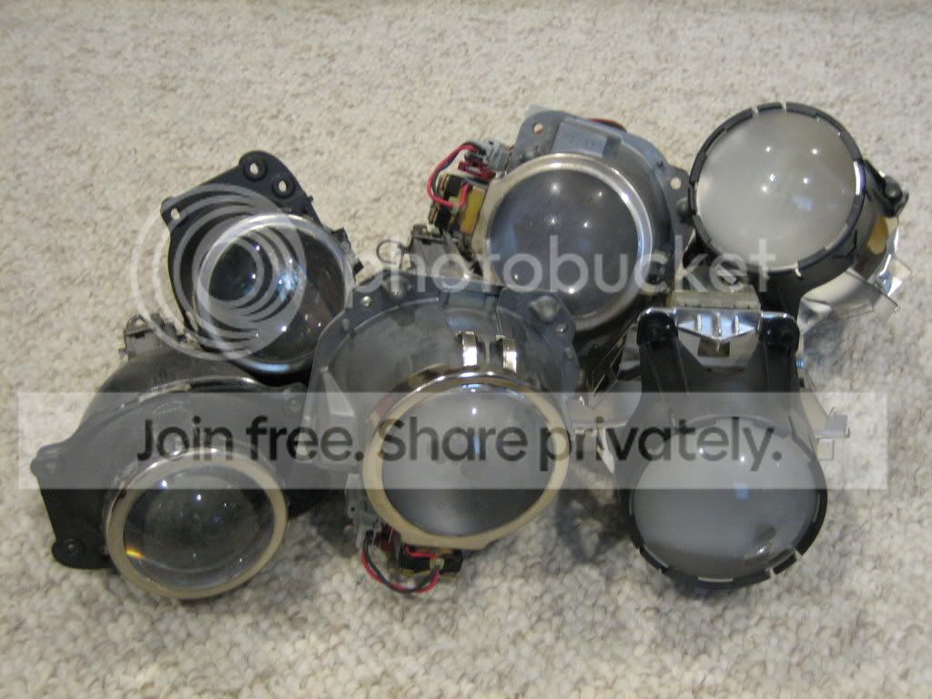

Starting a thread out for my 06 g35 sedan build. A few shots of the parts in store.
Luckily it has HIDs to begin so I only needed one extra set of ballasts. Plan is to use the TSX with clear lenses after painting the shield for the low beam (upper location) second projector will be a TL with ZKW lens swap. Note the projector lenses are fogged up because I brought them in from our garage.
Bulbs will be 85122+ in both setups using Matsu Gen 3 ballasts

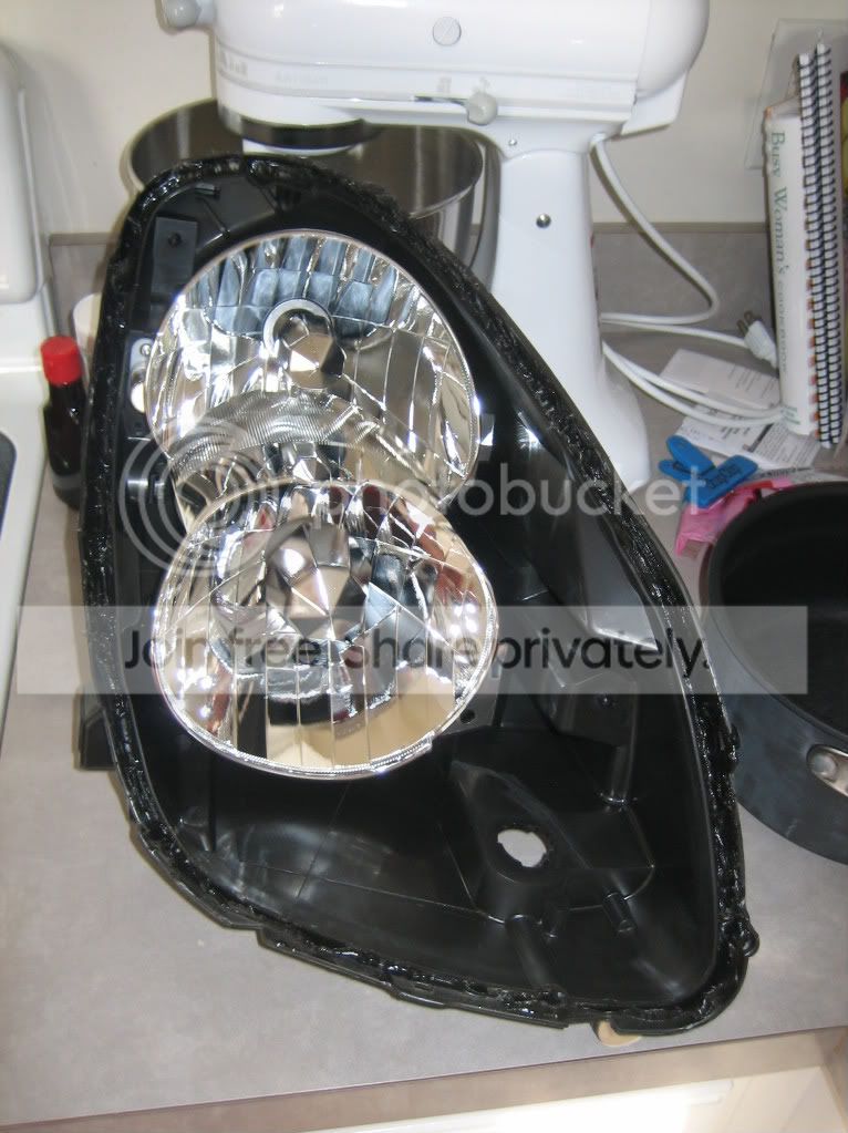

Got things ready as I am going to start working tomorrow
Comparison of lenses Left is ZKW Right is TL
Bowls removed from the rear housing
Mockup for the heck of it
Now the question is to try and use the stock bowls to mount or fabricate a few mounting plates for the projectors.
