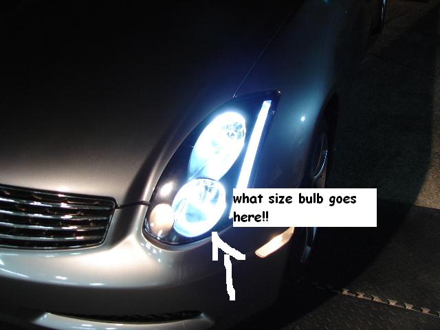

i want to put a secoond set of hid's but i dnt know what size bulbs to buy!

You realize that there is a sticky at the top of this forum that tells you...right?
https://g35driver.com/forums/lightin...ent-guide.html
Not to mention your owner's manual will tell you (if you have one).
It uses an H4 bulb. You will need to use an HID conversion kit for H4 fittings. Doing so without doing a projector retro fit is not recommended.

so bascially all i have to buy is a h4 complete hid kit? bulbs and ballast and i'll be good?

Basically..... But the drivers in on-coming traffic will be blind and pissed off. A retrofit is the correct way to increase functional lighting with a correct beam cut off. Search HID and Foglights, its been discussed.

And HID kit is the minimum you need.
https://g35driver.com/forums/exterio...-required.html
It's recommended to go the retro fit route, though.
