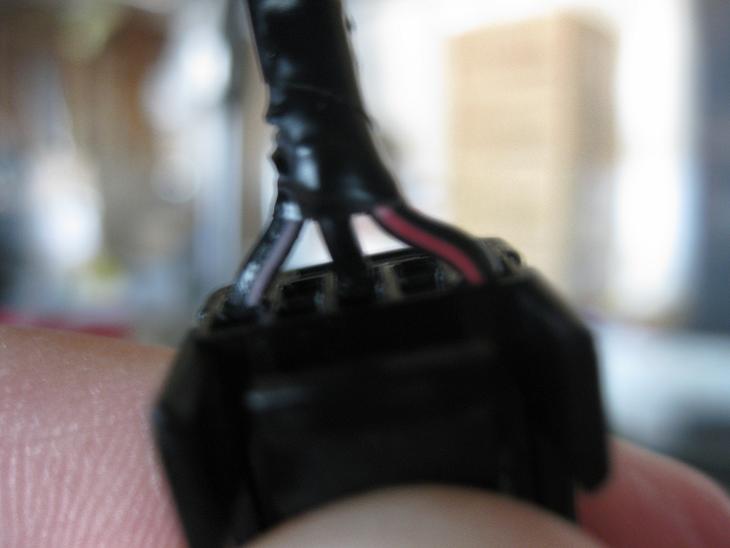

^ Deftronix, I did this (tapped into the Map light - utilizing this very thread you have a link for last year) for a JDM lighting kit I purchased from Japan for our car (Skyline 350GT), but the lights would not stay on when you were DRIVING. They would come on as stated in that thread when hitting the unlock button on your keyfob and when you turned off the car to get out, but again tapping into the very wires that thread suggests will not allow for the lights to remain on while driving.
Funny enough - just TODAY, I cut the wire taps I had on those wires that thread suggested tapping into and re-tapped the wires for the JDM lighting kit into the dimmer switch for the interior lights (gauges, cd player, hvac, clock, etc). Now the lights will come on when I click on the provided 'on/off' switch for the kit when I'm driving the car. It's very sweet!
I can add another DIY for the JDM ('mood mode' - as Nissan calls it) light kit in another thread.
I didn't get a chance to tap into the rear-view mirror light for the LED "Ambient" or "Moon Lighting" today, but hope to tomorrow with you guys help. I'm attaching a picture of three wires coming out of the rear-view mirror. I need to know which wires I can tap into.
I KNOW I need to tap my black wire into the black wire on the rear-view, but not sure which to tap my RED wire into? I think I would need to tap into the "Black/red stripe" wire.
Please look over the attached picture and anyone that would know for certain - let me know and I'll go test NOW!
Thanks Guys!
-WoW

if i recall correctly the pink/black wire is switched power (meaning it only turns on when the car is on) and the red/black is constant power
^ I guess that means, I'm going to tap into the PINK/BLACK wire so the moon light will only be on when the car is on and running.
