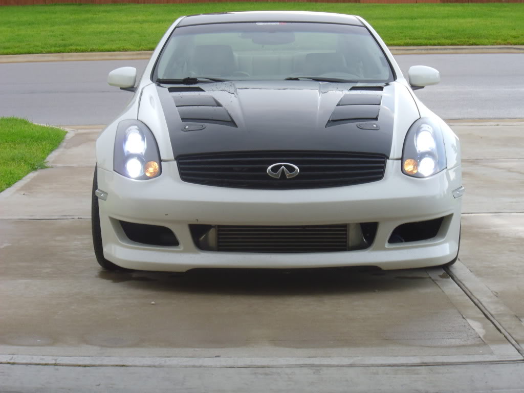

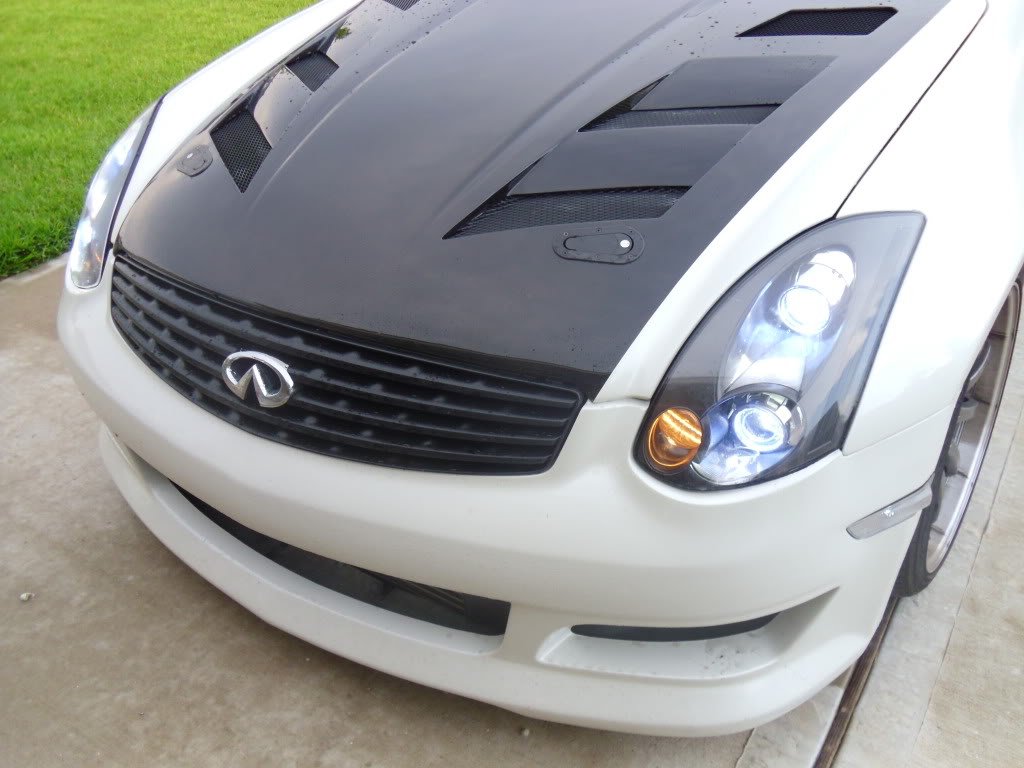

Here are a couple of installed pics. The I think I am losing some light in the lower projector. it doesn't seem a "full" as the the upper one. I will be going back in to wrap some aluminum tape are round the lens housing.

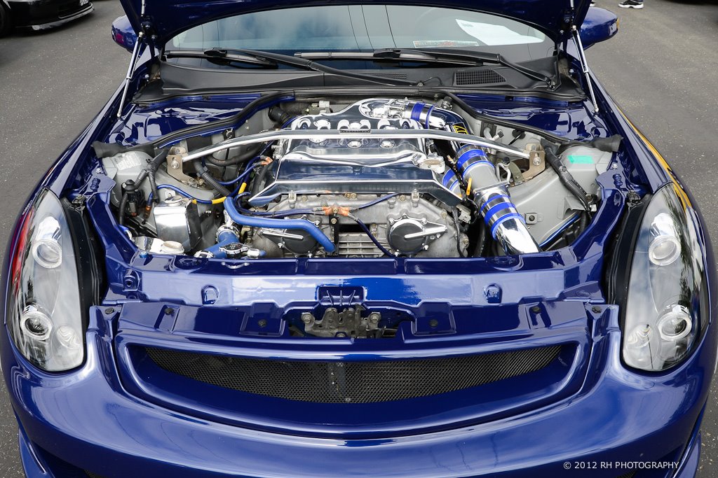

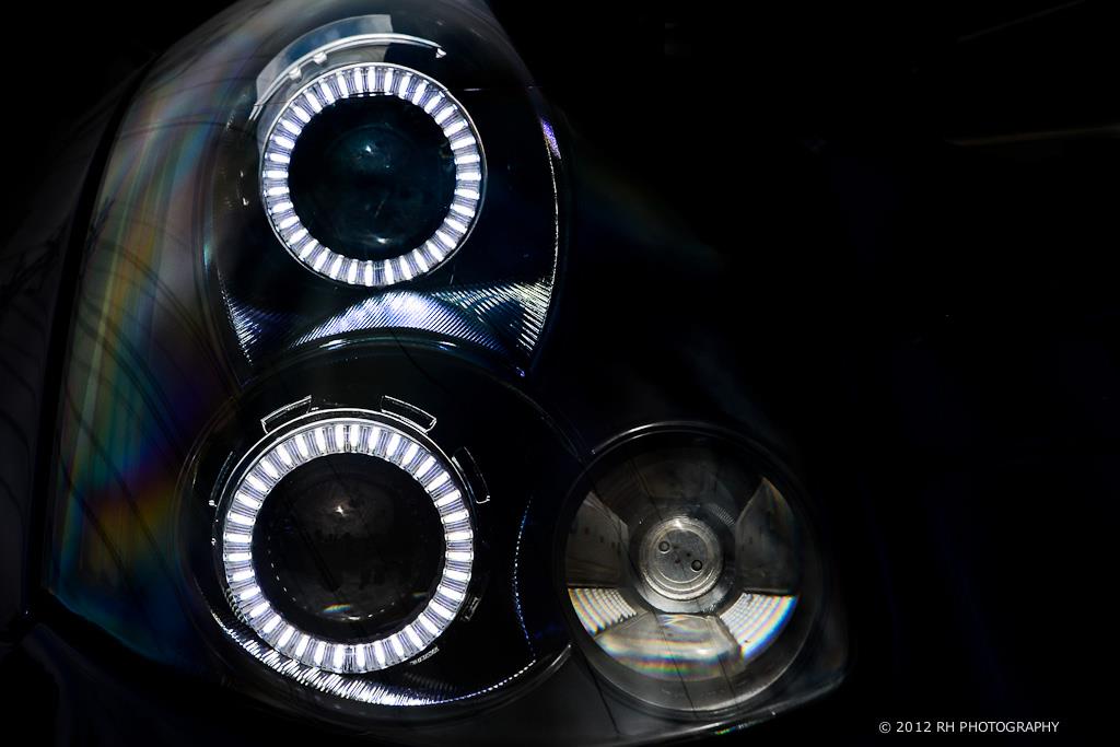

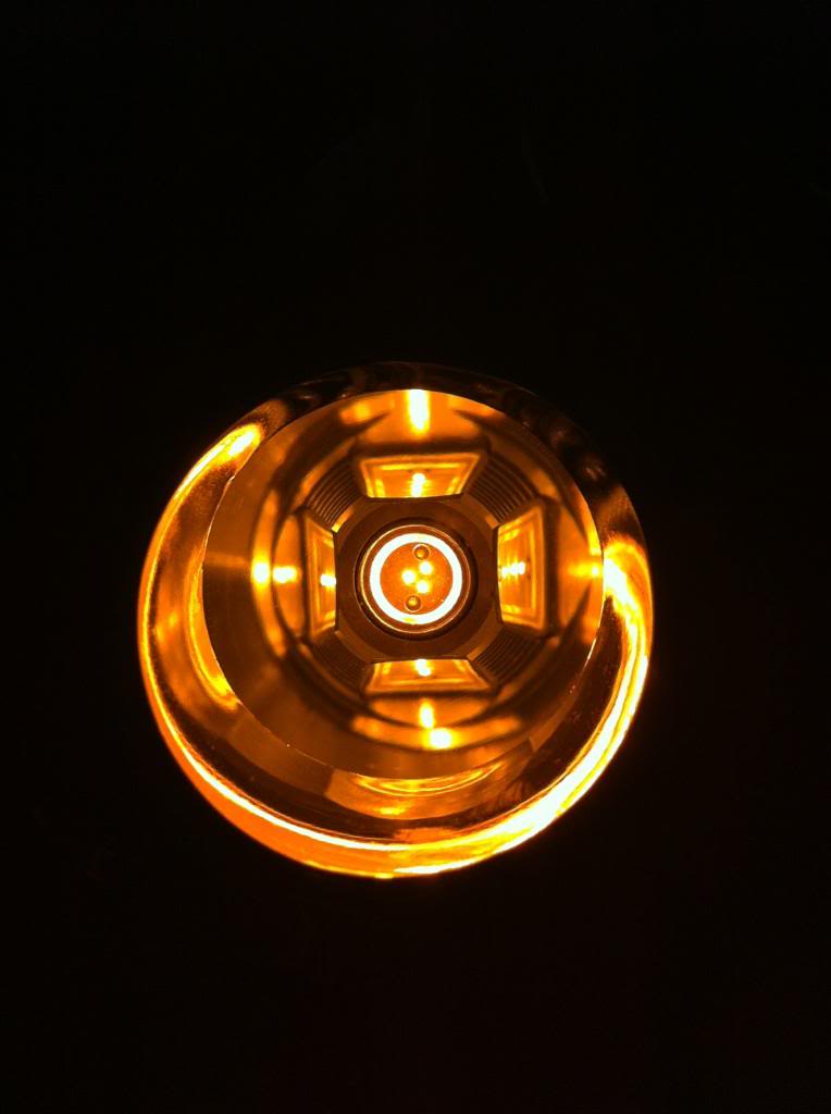

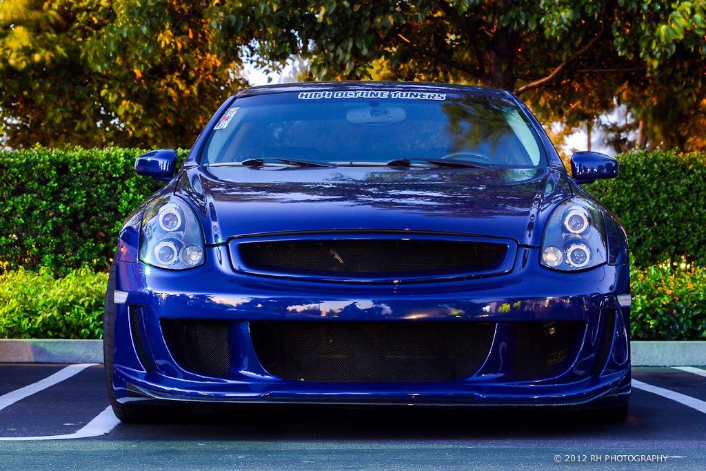

Here are mine which are very similar in design. My lower projectors are 3000K HID fogs wired into the harness. I have RGB demon eyes in each of the projectors which I still need to connect. Turn signal has 7W LED bulb. The angel eyes are DRLs since they are still very bright in the daytime.
